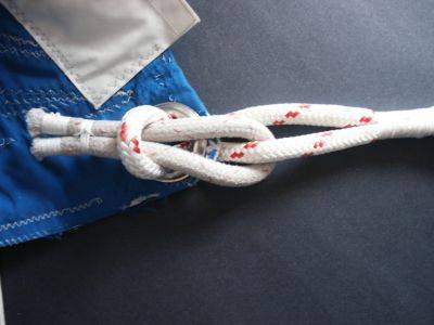

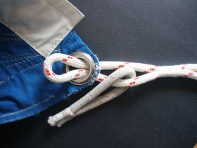

Thank you all for the awesome responses. I seriously appreciate your input. After some minimal research and minor considerations, I believe this may be the better solution for my needs, using the soft-shackle approach and one line.
View attachment 132776 View attachment 132777
How does this seem to you all?
Same idea as what I showed, but the method I use is more secure. I used to use this one til a sailing friend in Florida showed me the other
Thanks Charlie, I think your post was the first one that totally intrigued me, although I gotta credit @Gene Neill with the Eureka moment. I'd like to understand the splicing process on your soft shackle a bit more if you have a moment. The one I found online looks fairly straight forward and relatively easy to prepare. Like I said, 91 days to perfect the soft shackle, and fortunately I have all the sails stored indoor here at home to play with. I need new sheets anyway, the pair that came with the boat are two different thickness. And just so we're clear, I going with one long line and a central, easily removable, soft shackle...regardless of headsail configuration. Once we test it over this next season, and prove workability, I'll make a second as backup or replacement.
