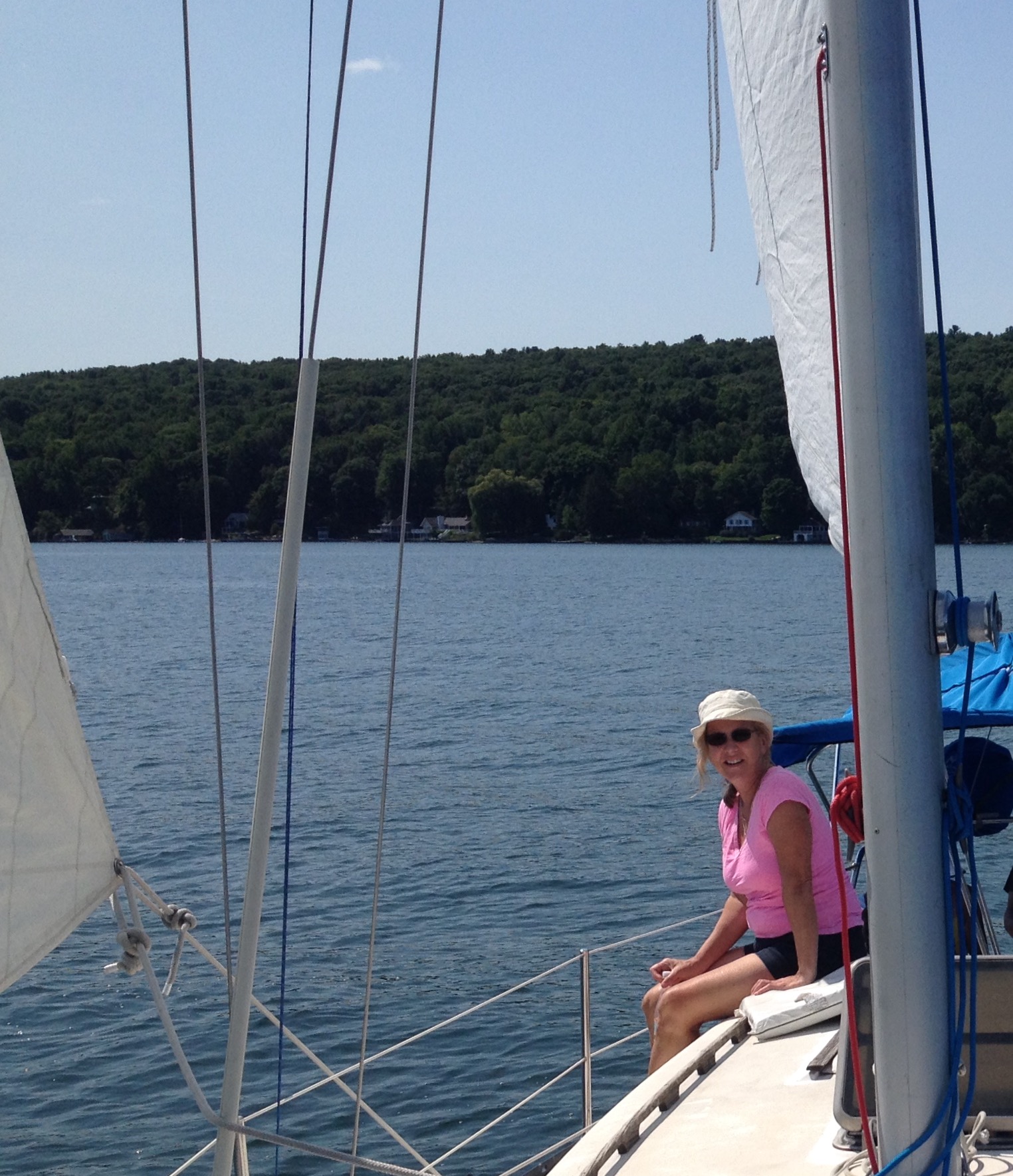

I'm curious as to what your preference is to attach the jib sheets to the clew of your headsail. Do you use two lines and a knot and/or shackle, or one long line and a single hitch (clove, half, etc.)! I'm currently using two lines and bowline knots and during last summer I had one of the bowlines shake out. That made for an interesting reattachment in 15 kt breeze. I'm thinking one long line, shared between port and starboard with a clove hitch will work better for me. My headsail is hanked on. Any downside or extra benefits you can think of would be helpful. The pic above shows what the PO showed me to do with two lines. Mostly it worked well, but as I said, just curious if there's a better way.

We used to do it like your pic shows. We have since gone to using just one line, with an overhand loop in the middle, attached to the clew with a soft shackle.
Headsail changes are a lot faster now. The sheets stay in place, just undo the shackle and put it on the new clew.

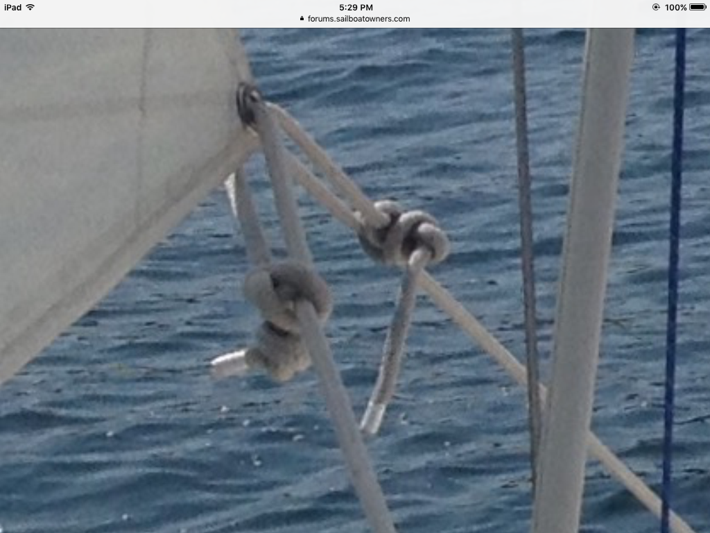

By the way, what type of knot do you have tied, BlowMeAway?

Pardon, but it took me a few seconds to shift my attention from what I assume is a very important person for you (the lady in pink) ... to the topic of your post which is the the routing of the jig sheets that are shown in your picture.
It seems that one jib sheet is for close-hauled = inside the shrouds? And the other it for more "off wind" = outside the shrouds?
On San Francisco Bay, I have seen this setup. But also, for inside the shrouds, the boats would sheet to a t-track on the cabin top or located on the main deck right against the cabin top. Either would be utilized for close-haul sailing.
For the jib sheet routed outside shrouds, the boats have a second t-track mounted right along the gunwall. This jib sheet is used for off wind tacks.
One consideration is that a competent crew is required to manage between the two.
Another is that the head sail probably shouldn't exceed say 100-110%. Except for very light winds, and a proper cut, a (say) 135 genoa doesn't route inside the the shroud very well.

Those bowlines could be less bulky? Anyway, you have a short season up near Ithaca and Cornell.

Bowlines with a simple overhand hitch and the other with an overhand stopper. Trying two different bowline bastardations to see if anything helps.

Hello @rardiH36, no just two separate lines, both outside shrouds, single toe rail blocks on starboard and port. No magic here. You can see the port sheet pass in front of the mast...but your eyes need to see the mast...sorry about the pink distraction...and we're talking about jibs not jugs.

If your bowline is coming undone, you're not tying it right.
You would think so, but they do unravel without a constant load and a lot of shaking or flogging.

Yes, we do have a short season. It really sucks knowing many of my SBO forum comrades have Year round fun. Regardless I appreciate all the favorable responses during this winter sebatical. To get less bulky bowlines I will need thinner line. Working that angle too!
