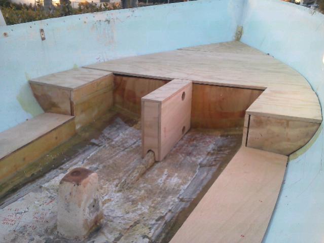

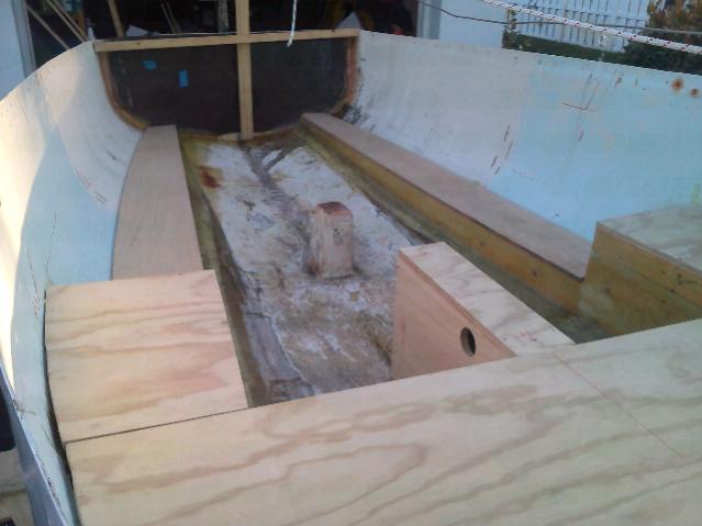

Yep, cabinet grade in the top of the berth. The other is 1/2 ". Did not want to have sagging.

I was thinking 3/4 all over would be over kill... even for you.... big guy! ;)
so, where did you get cabinet plywood? causeway lumber?
looks like nice alternative to marine ply...

I went with the 3/4 not just for the extra strength. I did not want to have any sagging along the bulkheads. I also wanted the extra material for running screws into. Lastly, the seats are the fillers for the bed and to keep it all uniform I stayed with the thick stuff. Its not that much heavier anyway. The tops of where the old quarter berths were is 1/2 inch.

no doubt about it, its going to be better than new!
any thoughts of a bilge? like a sump with trap doors?

I am thinking on 2" holes that are sealed with epoxy fillets that will run into the open area around where your feet will be. I will also put in an electric bilge pump to clear any water that comes in. Also, there is a drain on the transom so that I can tilt her way up and drain anything that comes in.
One of the mods I am still thinking on is to add 2, 2" scuppers in the cockpit that drain out the transom to keep the greenies at bay.

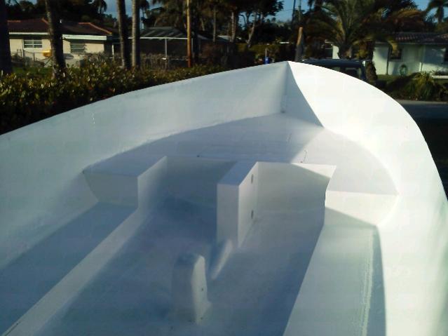

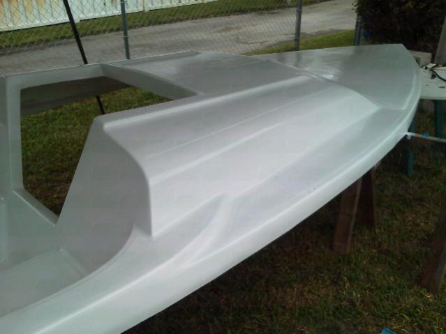

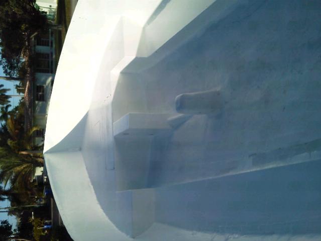

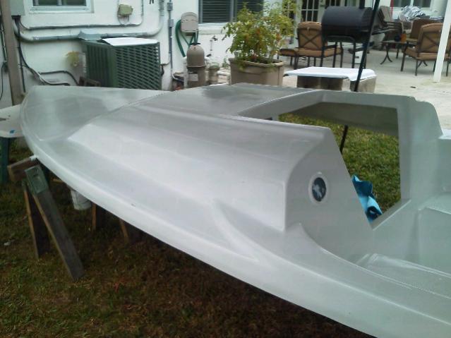

I found the miracle paint for boats! The home depot has it, it's new and costs 20 a quart. Did the whole top and cockpit with 1 can. It is like a cross between syrup and yogurt as far as taste. Ok, consistency. No brush marks, dries hard and goes on with a brush. This is the 3rd boat I have painted and can say this is the best finish I have ever got. It is an oil base.
That is one coat. Amazing stuff for sure. They have a bunch of colors as well.
The real test of a paint is dragging a shoe on it on a hot day.
Thank you for posting about this paint. Paint doesn't need to be made for use in water? I'm only asking because I know nothing about it. Your paint looks great.
Can you please tell us what minimum temperature the paint requires to be used?
If others confirm this can be used for marine applications, I really like the dark blue color.
Sep 16, 2011
346
Venture 17 Hollywood,FL
Dear Mr. Cheese
You bet and thanks!
1. Paint does not need to say marine for use above the waterline. (West Marine would argue that though)
2. Not sure of the min temp but I would bet its around 50f.
I will post later on how it is holding up. I also asked the owner of a boat builder to test that paint as well. My guess is that it will work well. Trim paint for exterior is made to last a long time. You wouldnt expect the paint on your house trim and doors to only last a couple years. It dries to a very shiny and hard surface. There were no runs and very few shallow spots to recoat.
