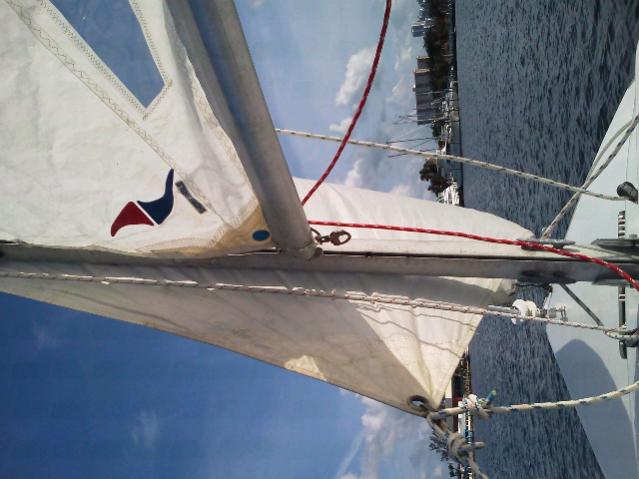

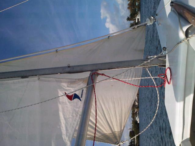

mystery solved, the sail is a loose footed 470 sail from Shore Sails. The receipt was actually just a quote from a local place. The 1691 is related to the hull #. Hopefully this is a good sail. Never used or set up a loose footed sail.
12,754
Nice! I have used a loose footed sail on a Rhodes 22 that I chartered a few years back. I really like the way they set. And they are easier to reef. From your pictures it does not look like you have any reef points. Is that correct? I have no idea how expensive it would be to have a sail maker add some but I'd think it would not be too much. (?)

So I am pretty sure my boat may be a good performer. The mainsail I have has 98 sq. ft where as the original was 83 sq. ft.

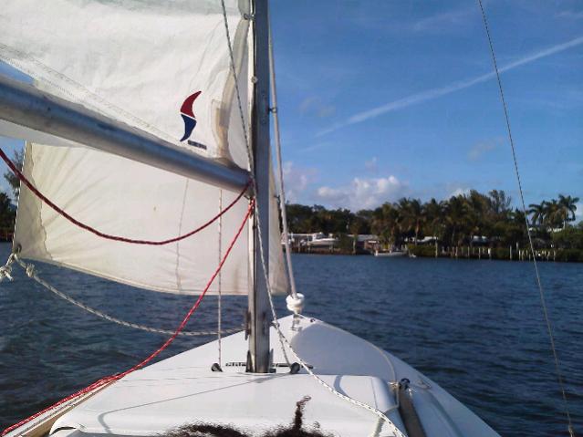

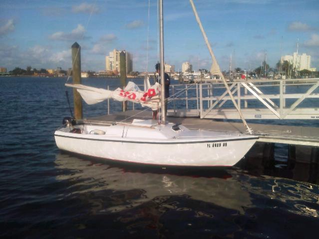

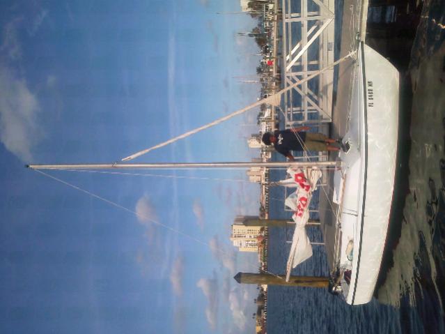

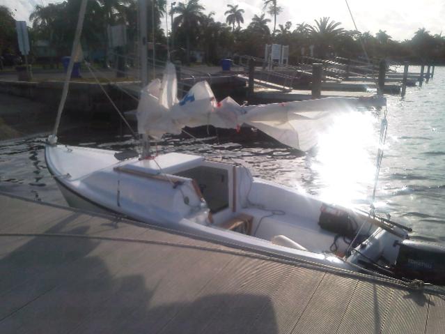

FINALLY!!!! It sails! We took it out on a short test sail today on one of the lakes. 15 mph avg wind, we were able to get to 7 mph on a gps. Not too bad. The boat seemed very stable and predictable. Able to heave to nicely as well. The roller furling was fantastic. Just need a few minor improvements all around. The P/O had so many eye bolts in the mast, the ones down low were catching the jib sheets when we would come about. I was shocked at how bouyant the rudder blade was. That sucker really wants to float. The hold down system worked well. I liked having all the sail controls run to the companionway area. I will be adding some sheet bags for the tails. Rigging took about an hour, take down was less.
I need to improve my system of putting up the pvc furler. It works but not as well as I would like. I would like your input on that.
Oh yeah, the puppy was happy sleeping in the cabin. Cant wait to go somewhere now!:dance:

That is great. She looks good on the water, congrats. I still think that one of those might be a good boat for us here at home. I need to talk to you about it sometime.
I rotated some of your pics as I was about to fall off my computer stool and the poor puppy looked like she/he might fall out of the boat ;),

Hey Bill, the main was ok but it is not loose footed. It didn't fit perfectly but worked well. I need to add a boom vang to shape it better.
