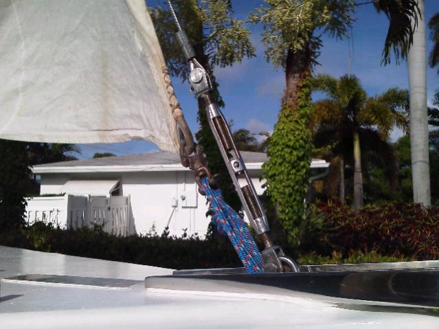

I finished up re-installing the running rigging hardware. This is the new standing rigging and turnbuckles. Also tried out the roller reefing set up on the main. May be ready for another sail! About time.
I still need to install the electrical system consisting of nav/anchor lights, bilge pump, stereo, cabin and cockpit lighting, battery, switch/ cb panel, distribution block, and 12v. outlets. Charging will be done at home and with solar.

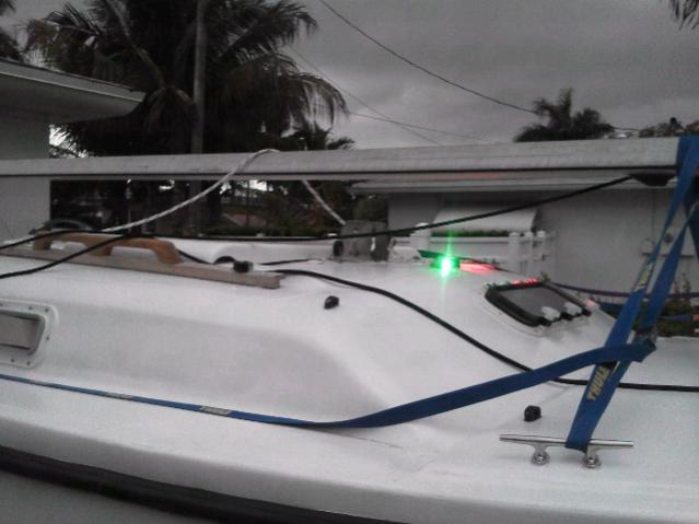

I just finished the majority of the electrical system today. It even works like it is supposed to! I made a box to hold a master switch, a distribution block, a stereo, and all the wires. It lives in a storage compartment under the berth. Very easy to get into and all the wires are concealled. I dont know how or if the original even had an electrical system but this is my rendition. Still have to run wires and mount the cockpit lights and the fan. Pics on the next post. All lighting is LED.

Wires- I used a bunch of heat shrink but thats a good idea!
Lights- They are and you know, thats a damn good question? Hopefully it'l clear. If not, I will just have to be super vigilant. Legally I sneak under the radar of light req'mnts. saillboats less than 20 with a top speed of 7 have some exceptions.
Battery- Yes, its strapped around the side quite tightly I might add.

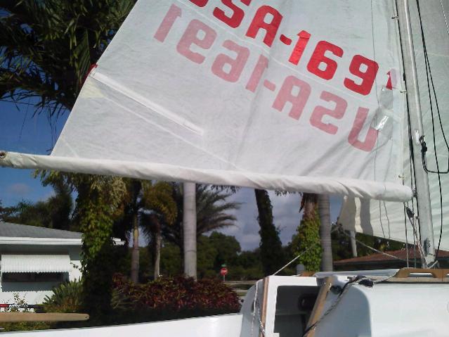

I have both the rolling boom and two sets of reef points in my main. I also have a bail for a vang and use it from time to time. Here are some observations I can share when comparing the two different reefing options.
If the sail is rolled around the boom than you cannot use a vang or mid boom sheeting.
Very true... and when running in heavy wind (good time to reef) a vang is very useful.
Just like all furling sails the shape is compromised when rolled.
I know this is the prevailing wisdom and one of the reasons I have hanked headsails but..this has not been my observation with the rolling boom for the main. I find that I get a very nice sail shape, especially if I've taken care to roll the sail tightly around the boom. However I have found it very difficult and time consuming to reef the sail once underway. Single handed it is impossible. Short handed it is very hard. Usually you are reefing because the wind is up, and rolling the sail up on the boom with one hand, taming all of the lines with the other and steering the boat into the wind with our foot just doesn't work. It takes too long for one thing.
If I need to shorten sail once I'm already out, I use the slab system. However, If I see it is kind of rough before I head out, I will shorten sail using the rolling boom. It is VERY easy to let out sail using the rolling boom. So if the wind lightens or my nerve hardens during the day, I let out more sail simple by releasing the thumb screw and pulling on the halyard. Easypeasyleamonsqueezy.
Another thing about the rolling boom is that if you leave it free to roll with the sail all the way out, the foot takes on a nicer shape. You don't get that kringle in the foot that you normally see. Probably only adds 0.001kt to your boat speed but ...
A plus is with a bolt rope you can wind instead of flake when lowering for the day.
That is definitely a plus... see photo.
