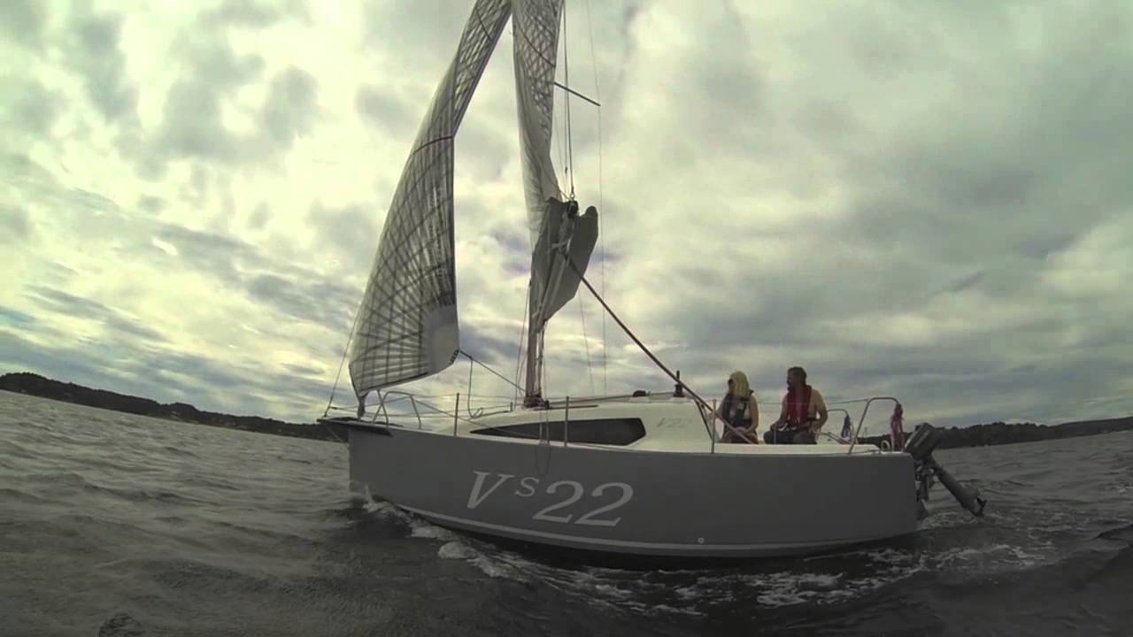

Looks like the competition does not sleep. Another boat to add the list is the Viko S22. Designed by Sergio Lupoli Yacht Design (Italy, build in Poland) as a performance-oriented weekend sailor with excellent overnight capabilities, it boasts with acceleration, fast sailing, lots of fun and good looks. Boat is available in three configurations:
- lifting centreboard
- fin keel with bulb
- lifting daggerboard with bulb
Some specs:
Hull lenght: 6.95m (22.8 ft)
LOA: 8.10m (26.6 ft)
Beam: 2.50m (8.2 ft)
Weight: 1200 kg/ 1300 kg (lifting keel / centreboard) (2640 / 2860 lbs)
Propulsion: outboard
Price: from 14 990 € (USD $20,500)
Does she look good? All depends who to ask. Personally, I do like her lines

Bosman,
Nice find. You must have a connection or a very active interest in these things!
Its amazing that the Polish home market can support all these new little boats. To sell them cheaply, that have to amortise the R&D cost over many units. You go out of business selling a few of them.
On the export front, I assume that are trying to overcome the bias against Polish boat in the big sailing countries, where they are looked down upon as cheap lake sailors. Poland is one of the very few countries in Europe were a significant percentage of boats sail on lakes.
There is an extraordinary amount of joinery in that boat. Thats nice. Labor must be very cheap in Poland.
I think it looks OK as well. Nice to see them moving to true lifting keels.
What does a 22 footer need TWO SINKS??? That's just crazy. Storage space looks non-existent.
7,773
Cockpit seems small. I could give up some of that cabin for more cockpit. Fractional rig - I presume? I do like the enclosed head but the sink isn't necessary. Draft?
For SURE fractional. All new sporty boats these days are; 7/8ths or 9/10s fractional, shrouds on the hull/deck joint, non-overlapping headsail, and a big roachy main.
Europeans use this size boat differently than Americans do... most will truly weekend on it while most Americans will day sail it. The cockpit/cabin ratios reflect that.
The enclosed head is a great idea. Guys typically care less but ladies (who make most of the buying decisions) want a private place. Good thinking.

Jackdaw,
I have a very active interest in the sub 30ft segment, that is certain, as I plan to change boats in the next little while. Connection - not so much. I simply try to look at the reports and articles from various boat fairs that take place in the EU - wheter on the internet or from printed media (I subscribe to some yachting magazines from Europe).
The Polish market is nowhere near supporting the builders. It is said that roughly 95+ % of production is exported within the EU, middle east or North America - that is what drives the sales and design of new models. Not too many people know that significant number of popular powerboats sold in the US are not even manufactured in the country (Brunswick Marine group), but rather assembled. The most successful brands from Poland that sell worldwide under their own name are, just to mention a few, are:
Delphia Yachts (http://en.delphiayachts.eu/) sailing vessels from 24 to 47ft, plus motor yachts
Sunreef Yacht (http://www.sunreef-yachts.com/) very much luxury in full splender
Galeon Yacht (http://www.galeonyachts.us/) luxury market segment
Other players, smaller, usually seem to target clients within the EU in Germany, France, Italy and Spain. Interestingly, there is a growing interest in these boats in Asian Markets - South Korea being a good example.
I agree that lake boats with coastal capabilities is indeed a market niche in the country and possibly in the world. While all the major players in the boat building industry focus on large vessels available for smaller percentile of population, Poland seems to take lead in the production of boats for people that do not have need for large vessels. I have not seen similar variety of boats in this segment from any other country.
Labour is less expensive, but not cheap. Automation of production is important with wide use of CNC machines, allowing builders to minimize labour required to fabricate woodwork as well as to minimize wasted materials. Utilization of CAD software during the boat design process allows to export files used to cut all components of the boat - this is how, for example, Maxus 22 was able to get from drawings to first production boat in about 2-3 months (mentioned above). I do not believe this would be possible with manual labour.
shemandr - draught of the boat is as follows:
Lifting Keel: 36cm / 1.5m (14in / 4.92ft)
Centreboard: 28cm / 1.4m (11in / 4.6ft)
No info on the fin keel with bulb.
