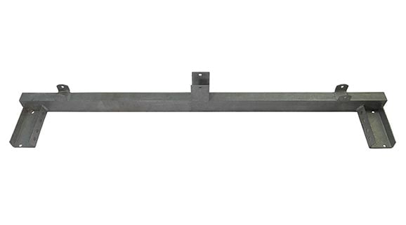

Tandem Sliding Spring Hangers
No picture but these I believe are what I used to add an axle to my trailer. I bought mine at Champion Trailers in Slidell, LA when we lived in Biloxi. I had forgotten that I had a guy at the local muffler place torch off the welds for the spring hangers on the trailer I was thinking I used a grinder. After he cut them off we bolted the axle right to the frame to get it home no boat on the trailer of course. From there it was just an Erector set project. I replaced both axles as matching the original was almost impossible.
I will take some pictures of the sliding spring hangers on my trailer and post them. I must be calling them the wrong thing and am not able to find them in my internet searches.
