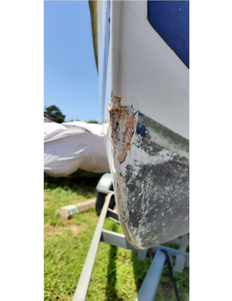

Would this still apply if there was damage below the water line on the bow. As on the trip the bellow damage was cause by a rock and was left in the water for ~60h (was two days out from the ramp at the time of impact). I was just reminded about this as I have someone come to look at getting it fixed.
