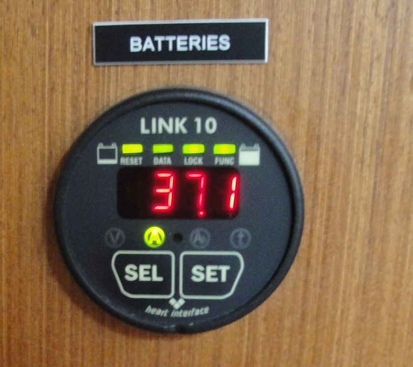

Hacking a Hitachi alternator works for @Ralph Johnstone because he has a relatively small LA battery bank of about 150-200ah. (Can't remember if he has 2 Group 27s or Group 31s.) His max output of 37a is in the right range for the Group 31s which like to be charged at .2C or about 20a per battery
STOP READING MY MIND ! ! ! It's freaking me out man :yikes: .
Our resident Guru is absolutely correct about my electrical system within 2-3 decimal points and knows more about my system than I do.

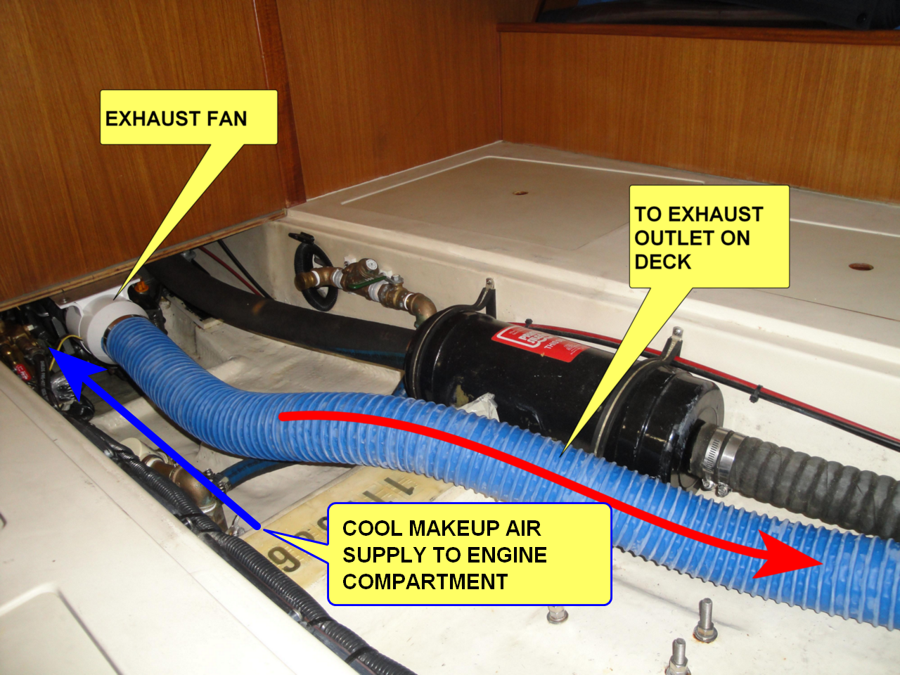

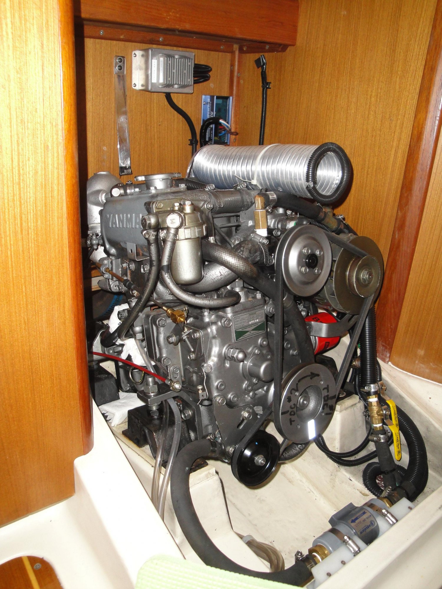

One other thing which may rear its $$$$ head is a mechanical supply of cooling air if your engine room is anything like mine. The engine enclosure started life as a Nike shoe box :
The engine has about 1" clearance under the cover which makes for a hot supply of cooling air for the alternator.
Enter the cooling fan which will keep the temperature of the cooling air below the temperature of the block ~ 170° F.
The reduced temperature cooling air keeps up the amperage output from the alt. as the external alt. regulator has a safety feature which reduces the amperage output as the body temp. of the alt. increases.
