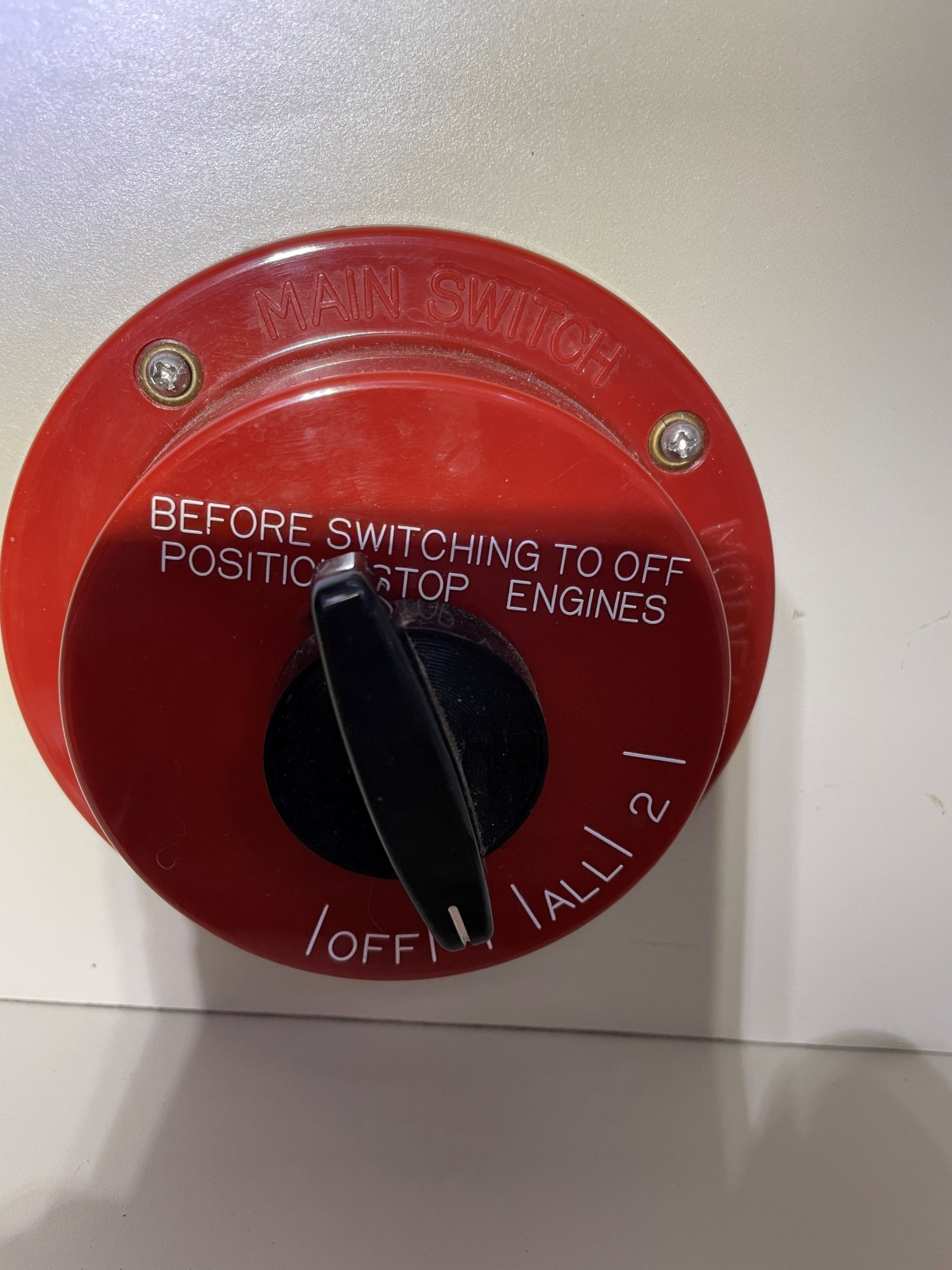

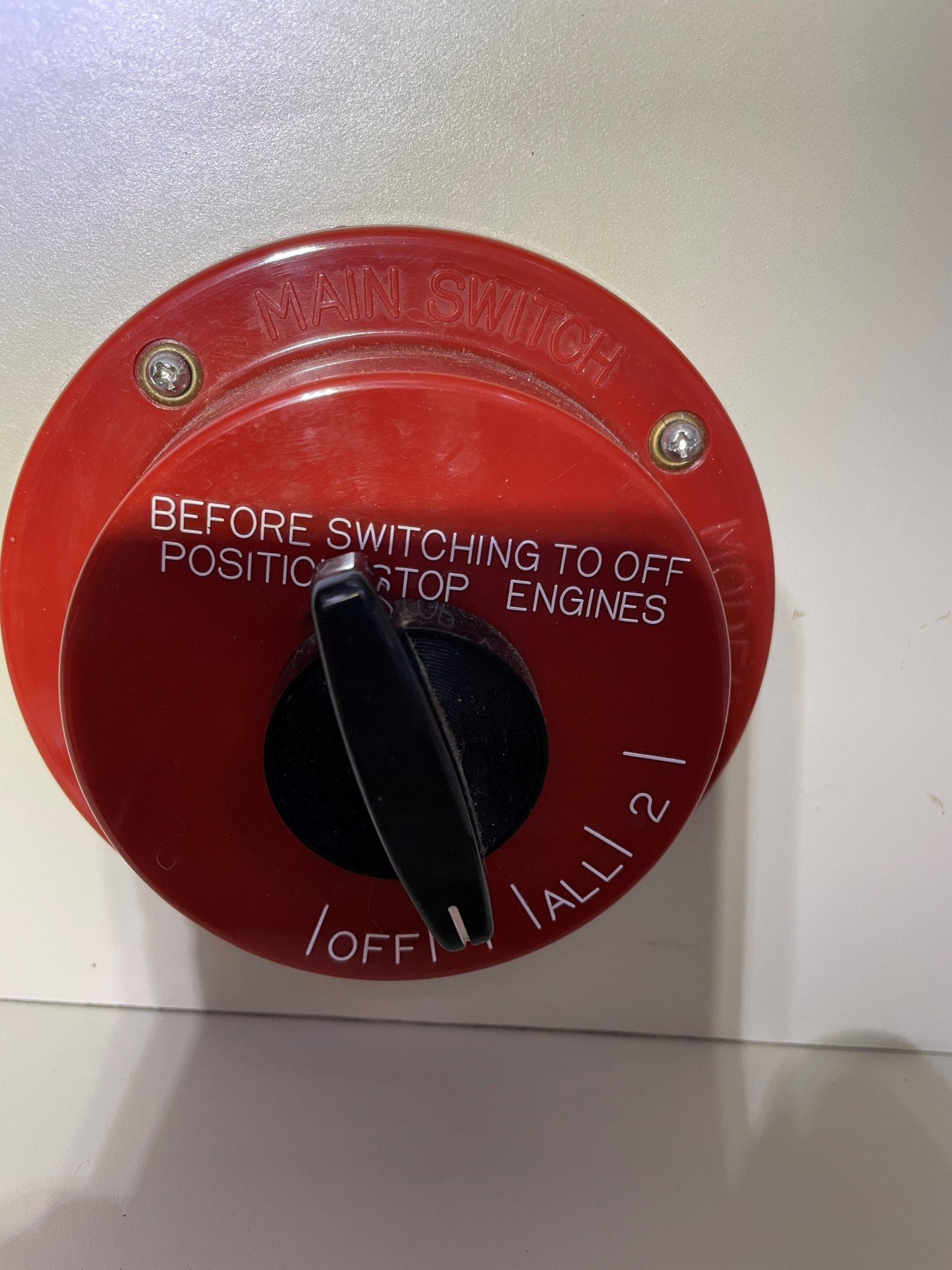

Thank you all for the info and time to write it up. As a followup:
i know there is a switch in the boat (mine is pictured below) that allows you to separately select just the starter battery or just the batteries used for all the other boat electronics or both to use all 3 batteries for the house/boat electronics. I'm pretty sure the positive lead from the starter battery is wired directly to the #1 terminal on that switch and then one of the positive wires from the other 2 batteries are wired to terminal #2.
How do you wire this so that you can charge all 3 batteries at the same time and yet isolate the 2 batteries you want to use just for house power?

@Johann has provided an excellent summary answer to your question. The link is further a solid resource.
The issue with your question is that it is based on the provided assumptions. Your boat may have been altered by any number of owners or boat workers before you acquired it. You mention three batteries. Johann assumes that two are house batteries and one is a starter battery. That is because, after years of experimentation, it has been proven to be an effective configuration for a sailboat.
With the Lithium opportunity comes a variety of internal redesigns of electrical systems.
Perhaps while you are learning and enjoying the sailing capabilities of your boat, you can expand your knowledge of DC and AC electrical systems for boats. Exploring the information on the "Marine How To" site is excellent. Reading about boat electrical systems, "Boatowners Mechanical and Electrical Manual" by Nigel Calder, or his new adventure into online instruction. About BoatHowTo - BoatHowTo
Knowledge is a powerful thing.
24,745
With electricity, it is black or white. The wires are going from the positive battery lead, or they are not. "Pretty sure" is a phrase that can get you into a lot of trouble.
If not absolutely (bet your life) sure, I would encourage you to inspect and become sure visually.
The switch image you provide has been used by many sailors to manually control the charge current from an alternator to a chosen battery. What has been learned over the years is the unreliability of sailor' memory to ensure that all the batteries are charged and ready for their intended use.
Jump on the boat, turn the switch to charge the house batteries. Anchor out for the night. Wake and go to start the boat motor, only to discover the start battery is dead. :facepalm:
there is no single correct answer. Depends how your boat charging system is configured. Generally, charging of all batteries is done irrespective of the switch by an ACR relay or isolator such that all batteries are interconnected only during charging.

That’s a pretty typical 1/2/Both switch used for selecting which batteries get all the loads and charging sources. MarineHowTo has a good article on those at 1/2/BOTH Switch Considerations
Those types of switches were used very often on older boats and they can be effective for managing multiple banks. Their main drawback is that the management is all manual, and at least somewhat error prone. Forget to switch to “both” periodically and one bank might not stay charged. Forget to switch out of “both” overnight and you might find you don’t have a charged battery to start the engine. Accidentally switch to “off” when the engine is running and you might fry your alternator.
One alternative is to rearrange the charging system to use FET based battery isolators or automatic charging relays (ACR’s) to automatically combine the banks when they’re charging but separatr them when they’re not. If you move to lithium it’s common to use a DC/DC charger to charge one bank from the other.

With that switch, you really don't have a dedicated start battery and a dedicated house bank. When you look on the back of the switch, there are just 3 studs. There are 2 studs for input (current from the batteries) and 1 stud for output (current flowing to the "loads"). With that in mind, you select the input (Position 1 or 2) to serve both the starting load and house bank loads together. You don't have starting isolation. Select "Position All" and you may as well have all 3 batteries wired in parallel.
If you want to use one battery just for starting, you will need to select the position that is connected to the "start battery" when you are starting the engine. Perhaps it is Position 1 (as your previously indicated). Then, when you want to use the house bank while anchoring, you would manually switch to Position 2 (assuming that it is connected to 2 batteries in parallel that you call "house bank"). What you haven't made clear to us is how your batteries are connected to the switch. We are all assuming that you have one battery connected to one position and you call that "start" and that you have 2 batteries connected to each other in parallel that you call "house bank" connected to the other position. But your first post seemed to indicate that you have 3 batteries wired in parallel. This would not be normal, and you should confirm with all of us exactly how they are connected to the switch. It is more accurate to call the "start battery" an "auxiliary battery".
If you want to truly isolate the starting load from the house bank loads, you will need a different switch configuration. You could install a switch with 4 posts (2 inputs and 2 outputs) or 2 separate "On / Off" switches if you really want isolation between the start battery and the house bank. This has additional complications that you will need to learn about.
Another consideration that you must investigate is how the alternator is connected to the batteries for charging. With your switch, the boat builder's typical installation makes a very short cable run from the alternator to the starter. That's because they want to avoid installing a long cable run from the alternator to a battery directly. Instead, they let the current back-feed the batteries from the starter. The purpose is to select which battery to charge with the switch or to charge all batteries simultaneously on "Position All".
You can avoid making these manual selections with an ACR. But then you will need to connect the alternator output directly to a battery and not back-feed the current thru the starter.

Thanks. Its true, I'm not sure how the batteries are connected at the moment. They are just 3 LFA's right next to each other and enclosed in plastic cases, so I cant see how they are wired. Will have a look at that (in the spring) and get more detail on whats going on :) Thank you for the write up.
