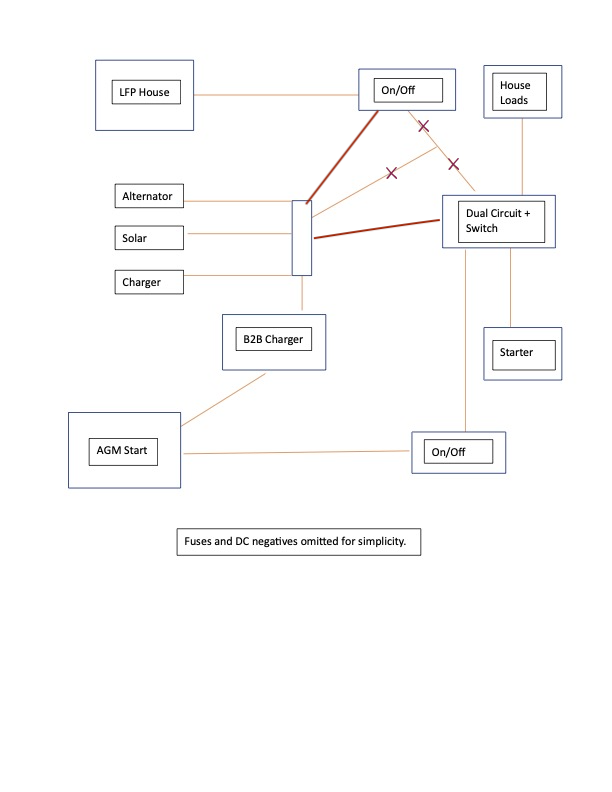

If you are planning a long term long distance cruise, this is not the arrangement you want because it does not take advantage of LFP battery's ability to accept a high charge current. This means longer engine run times to recharge the batteries. Longer run times burn up a lot of fuel and running a diesel at low rpms for long periods of time is bad for diesels.
Just do the math, assume 100ah per day of consumption. Relying on the DC-DC converter it will take 5 hours of engine run time to recharge the battery at 20a. However, using a 100a alternator running at a conservative 50a, it will only take 2 hours.
For a LFP battery system, the most efficient system is to have all charging sources and the house batteries tied together at the main DC + bus bar. This includes all solar, alternator, and shore chargers. The start battery is charged with a small DC-DC charger or FET combiner. (personally, I like the DC-DC charger more than the FET based device because the charger can programmed to your battery's needs and more easily monitored.)
Attached is a simple one-line schematic of the electrical system on my boat. Note, fuses and DC- cables are omitted for simplicity. This system worked well for us over 2 years of live aboard cruising. There is one change, the cable from the LFP On/off switch should go to the bus bar directly and the cable from the bus bar should go directly to the Dual Circuit switch.

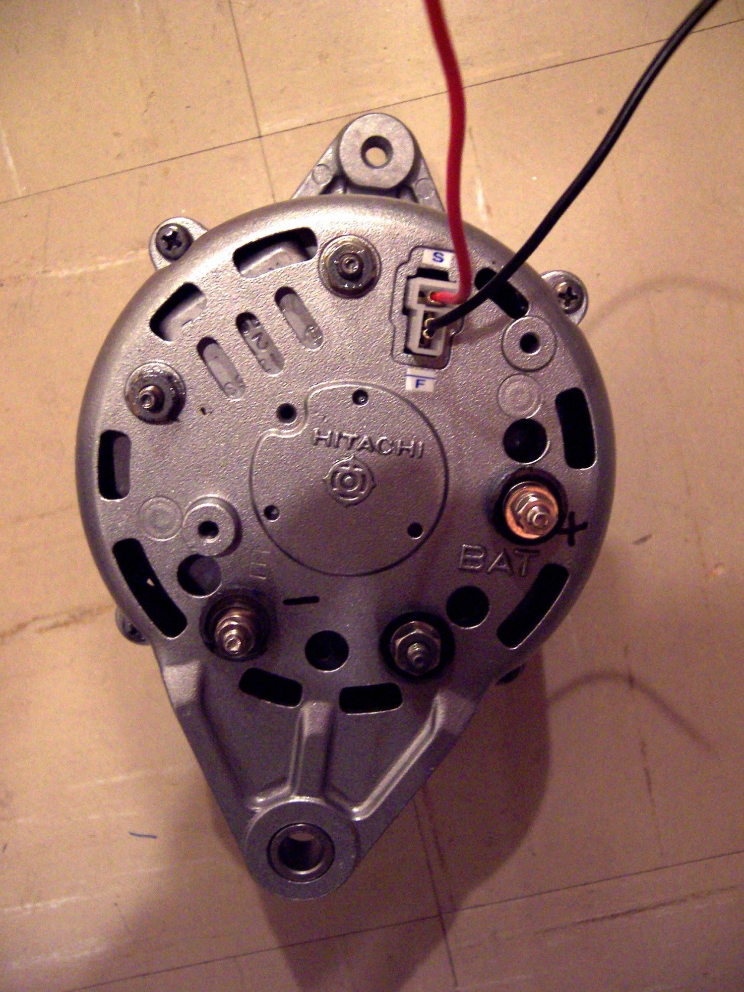

How do you disable the IR of the OEM alternator....or is it somehow negated by the external regulator?

The alternator has to be opened up and the regulator removed or disconnected. I've never done this, @Ralph Johnstone has, perhaps he can explain in more detail.
I suspect it makes more sense to just buy another alternator that requires an external regulator. I'm guessing thats going to be about $1,500 for both :(
I've HAD it done but a little above my pay grade so I farmed it out to someone who quite some time ago. About $75.00 but not much more at an automotive electrical shop. This is what I got back and a printed sheet as to how to wire it to the regulator :

Further to @BigEasy ‘s question re the internal Hitachi regulator, I was contemplating something similar a while back and found this HITACHI LR160-741 EINBAUANLEITUNG Pdf-Herunterladen on the Sterling website for ‘hacking’ a Hitachi LR-160 alt for an external regulator (helps if you read German, but easy enough to follow if you don’t). However, it also got me thinking (and alluded to on the Sterling website) that an easier route might be a DC-DC charger. These typically accept an input voltage down to ~13V and output a charge profile for a variety of battery types. Since the Hitachi internal regulator decreases its nominal 14.4V output voltage by 10mV per degree C, that would easily leave a high enough voltage for the DC-DC charger to operate at an alternator temperature of 100C. However, this also got me thinking about the stability of this system, since the regulator output voltage reduction with increasing temperature is meant to protect the alternator by reducing the output current (the current is what causes the alternator to heat up, actually proportional to the square of the current). But since the DC-DC charger draws more current as its input voltage decreases (to maintain the same output power), this is exactly the opposite of what the regulator voltage reduction ‘strategy’ is designed to achieve. I think that the alternator/regulator and DC-DC charger should come to a stable state if the alternator output and DC-DC charger output currents are properly matched, but suspect that things could go wrong if not…..

After researching conversion of a Hitachi internally regulated alternator to an externally regulated alternator, I have decided to not proceed with that modification. I read @Jan_H ‘s link for the Sterling conversion. Not really concerned about the difficulty. (I recently rebuilt my Hitachi & replaced the diodes, rectifier, & regulator modules). I am concerned about altering the designed operational & output parameters of the alternator. The build of that alternator does not include heavy duty windings nor does it have dual cooling fans that are found in true marine alternators. If I purchase a new externally regulated alternator package including a regulator & temperature monitoring cables, I would be out of pocket approximately $400 more vs modifying the Hitachi & adding an external regulator. I don‘t want to risk any problems by running the Hitachi over & above its design limits.
