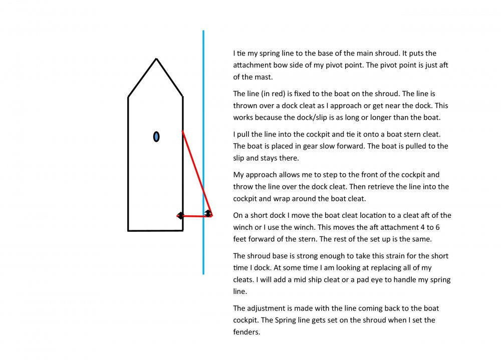

Here is a graphic (crude) of the set up I use.
This I'll call the no crash docking technique.

Just call the procedure Crash Docking... ;)
Very good explanation John. I see you tie your line to the shroud base for the pivot point. I'll give that a try.
@Claude L.-Auger Our docks are fixed docks at a height where either the bobstay or bow sprit would be against the dock fender. I do like the idea of doing it this way so I'll talk to our rigger and see what he says.
24,797
Very close. The pivot point is the location on your boat about which the boat will revolve (pivot like a pinwheel on the water). It is somewhere between the cockpit and the mast. It is based on the length of your boat, the location and design of your keel, how the boat rides in the water and the shape of the hull.
Go out on the water and with some space and standing still rotate the boat in it's own length by turning the rudder hard in one direction and putting the motor in gear. You will get prop walk going as the wash hits against the rudder. The boat will start to spin. Take the boat out of gear. The momentum should continue the spin. Hit Reverse so you don't start to move. Then back to forward. You want spin not forward or reward movement. Alternating you should be able to spin the boat within roughly it's own length. We are using this ability to help us with control at the dock.
The attachment of the line needs to be closer to the bow then the pivot point. This line pulls on the bow half of the boat. It is pulling back at an angle towards the dock and the dock cleat. ]The side of the boat snugs up against the dock because the bow is being pulled. You fenders out and the stern is still out from the dock edge. You can control the boat angle by the prop and the rudder. Turn the rudder so the bow turns towards the dock and the bow moves inward. Turn the rudder so the bow move away from the dock and the stern moves inward. You can use this to position the boat. You can also use it to get the boat off the dock and away from the slip.

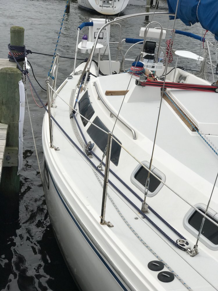

Update:
Made it to the boat on Friday. First thing I did was hang a couple of 8" fenders off the line separating my slip from my neighbor's slip. His boat is now well protected in the event I get blown into him.
Then I played with the "Gilles" method of a stern bridle ( @jssailem ) using different pivot points. I couldn't get this to work well. The line has to go around a piling instead of a cleat and I think that added too much friction.
What did work was a line with a bowline with large loop. I put the loop over the piling with the Docking Stick. Then ran the line through a block at the base of the forward shroud, back through a spare low lead car and the jib low lead car, to the winch.
I practiced entering the slip 6-7 times with this set up. The Docking Stick let me catch the piling each time, running the line back to the winch allowed me to easily adjust how far I was into the slip and using the prop wash I was able to position the boat where I wanted it.
I think this will setup will work very well for my slip.
I left the bridle in place. Even though it stretches too much to catch the boat coming in, it works pretty well for departing. I inched the boat forward until the bow was secured against the bridle, leaving the engine in forward at idle and prop wash to center the stern. This gave me plenty of time to drop all dock lines, then easily depart.
@LeslieTroyer I like the Docking Stick. Let's me easily reach the piling and put the loop over it. Faster than trying to pick up a line off the dock and more accurate than trying to lasso the piling.
Here's a photo of how I ran the line, taken after I put on other lines.
I plan to install a dedicated attachment point for the block or just a cleat, over the winter.
