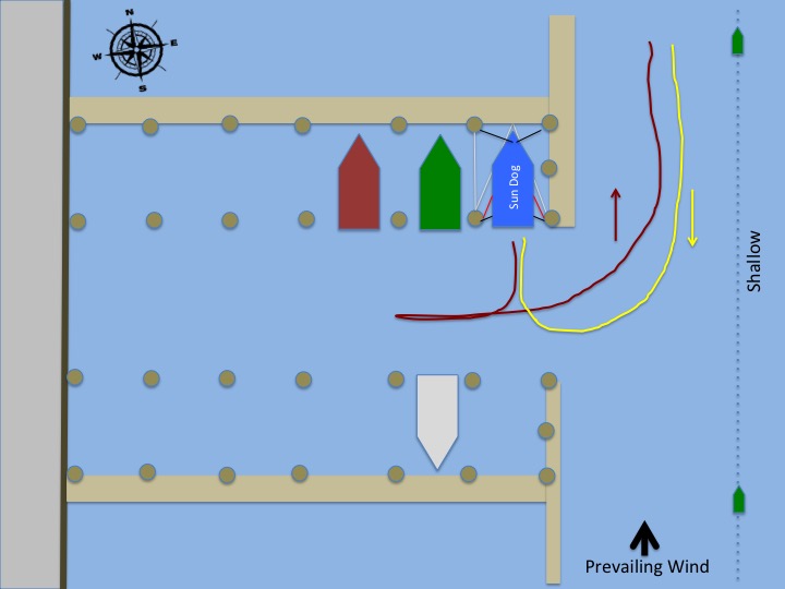

I decided to show you my slip layout and see what suggestions you may have.

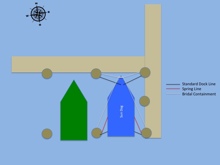

Here's a diagram of my slip and how I have my lines.
What worked with the O'day is not working with the C30.
First the bridal setup:
When docking I too often over run it or it stretches too much to keep the bow off the dock. If I come in too slow or stop too soon the wind pushes the bow to port and the line stretches enough to allow the boat to settle against my port side neighbor.
I'm thinking maybe the bridal cannot contain the weight of the C30 without the line stretching too much to be of use. It is 1/2" 3 strand nylon.
I have some 1/2" double braid polyester I was thinking about using on the port long line and short starboard line of the bridal. It has a lot less stretch and may contain the boat better?

Here's a diagram showing the slip, other boats and how I depart and enter the slip.

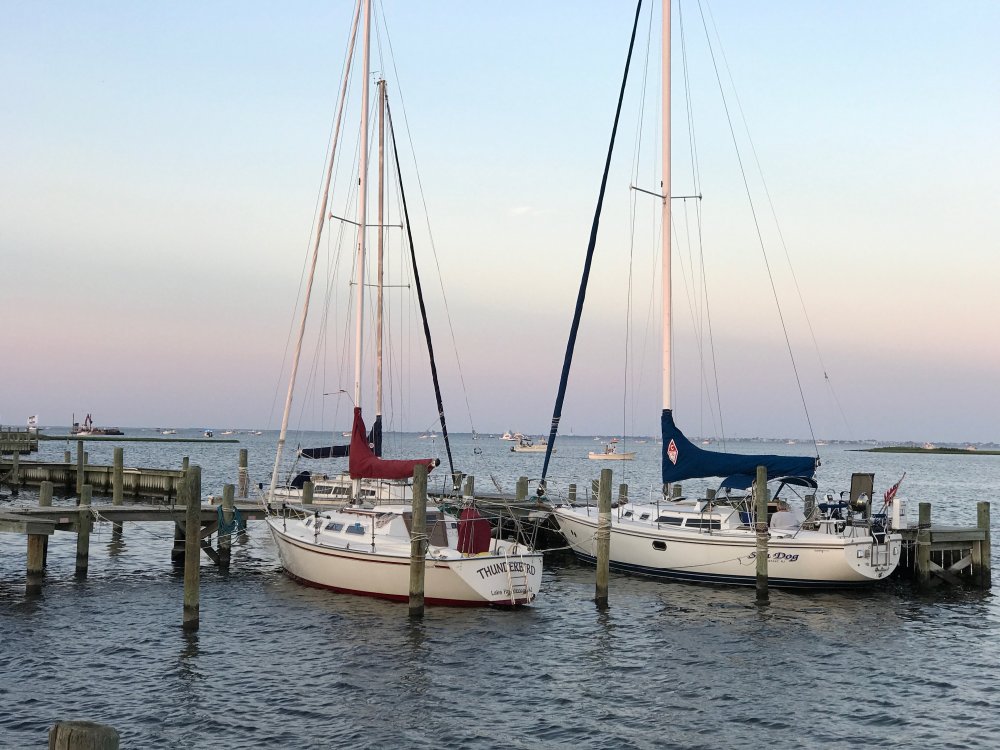

Here's a photo of Sun Dog in the slip on the 4th of July. My slip neighbor was out sailing. As you can see we have a great view. Those boats on the water are gathering to watch the fireworks.

First mistake is if you are likely to hit your neighbor, put out fenders. Most slips in my marina have piling-to-piling lines between slips. In addition, if you can't use shorter lines, get shorter or non-stretch lines. You know the hazards are there, like the boat that got run over, so something HAS to change in the name of decent seamanship.

I was wondering if the bridle is not high enough for the different shaped bow. Can you raise the bridle a little so that maybe the bow sprint/anchor roller catches? Don't know what to say about the spring line other than I am sure you will find the correct solution. You know the invention, mother, necessity thing?

First thing I would do is run a low stretch line between the two docks from the outboard dock post to the dock. Stretch the line as tight as possible and then hang two or three fenders at appropriate locatations. Then figure out the best place for a spring line to stop the boat before it can hit the dock.

Forget that "bridal containment" arrangement whatever it is and rig both a forward spring and aft spring. Your forward spring keeps you off the dock, and your aft spring keeps you off the boat to port (and from drifting aft).
Mark your forward spring where is meets your mid-ship cleat so it is a quick no brainer. In fact mark all your dock lines where they meet your cleats, then anybody can do the job. Cross your stern lines for better control.
It sounds like you don't have dedicated dock lines in your slip. Remedy that. Carry extra dock lines for visits elsewhere.
Your situation is actually very typical of a mid-atlantic dock setup. Your forward spring is the first on, and last off. Your aft spring line will loop the forward pile and come back to midships. You can take it off and hang it on the that middle starboard pile where it will be handy when you come in.

If you keep your starboard midship springline onboard, slip it on the aft piling as you come in. Keep the throttle in gear and your helm kick slightly to port. You will stay against the starboard dock. Then get your stern line on. Unless the wind is blowing hard, you can probably shut down the engine and get the starboard bowline followed by the rest at your leasure.
If you are not coming in under power, add a midship starboard dock line and pull it tight against the dock. Bow and stern bumpers will keep you from drifting over to your neighbor.
Decent seamanship and just being a good neighbor is exactly why I'm asking here. He's a real good guy, a local and helps keep an eye on our boats. We've become friends and I intend to keep it this way.
He usually hangs a fender but I don't want to rely on his doing so. I also hang one after I'm tied up. I tried putting out fenders prior to entering my slip in the past. They easily got caught on the pilings as I came in but I'll give it another try.
I'll also look at hanging a fender or two on the line between the slips.

I am considering your comment about forgetting the bridal. It doesn't seem to be a popular idea.
I've been picking the spring line off the dock. It's when I miss that I ding the dock. I'll try this instead as well as keeping the wheel to port and going for the stern line first.

Your comments reinforce what Will said. I need to come up with a surefire way to pick up the spring line, be it I keep it on the boat and drop it over the piling or leave it on the dock in a way I can't miss picking it up.
Then forward gear in idle with rudder to port and go for the stern line next.
If I can't leave some fenders hanging between the two slips I'll try hanging them on my port side before entering the slip.
That maneuver will put your bow into your neighbor, if I'm reading your comment right.
The spring line trick works because it holds you from driving into the end of your slip while swinging tighter against the finger dock on your starboard side because the prop is forcing it to. The port rudder is necessary to keep your stern from swinging out. You should be able to lay against the dock, with just a midship spring line running aft, all day long like that. Higher winds may require a little throttle.
If you pickup the stern line first, then only the stern is pulled in to the dock, adding port rudder will just make it worse.
Setup your midship spring and run it back to the cockpit. You will hardly have to move away from the helm to grab the loop and drop it over the piling as you come in. The only real problem will be trying to enter the slip with a strong port side wind. It could push you off the dock before your cockpit is even with your piling. In that case, run the loop forward and drop it early before the wind takes you away, then back to the helm and proceed as planned. Only turn the rudder just as you come in contact with the dock. Otherwise, the stern may kick in before the rest of the boat and you lose your angle on the spring.
