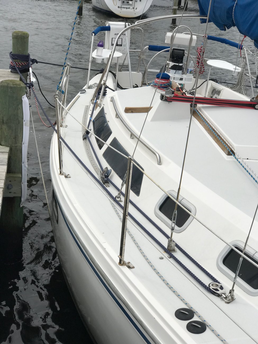

In this photo
the piling with the white bumper is forward of the winch and the track cleat I mounted on the genoa track.
When I tried using the cleat or winch, the boat pivoted on this piling, pushing the bow to port. That's why I was a bit confused, multiple people has said to use the winch but in my case it didn't work.
Thanks
24,797
That is a great image. I can see the geometry and the abilities that meet your specific needs.
  1. In part you want to stop the bow from going to port. By putting the attachment where you did you are pulling the bow to starboard as the boat is powered forward. You can enhance the boat against the pilings by turning the rudder to Port forcing the stern to starboard. Nice.
  2. You are also able to control how far the boat is allowed to advance into the slip. Nice.
  3. Only issue is the limit to the line by the stanchions where the line is trapped beneath the life line and between two wide stanchions. But I appears that is a low risk in the way you are using it.
Nice application.

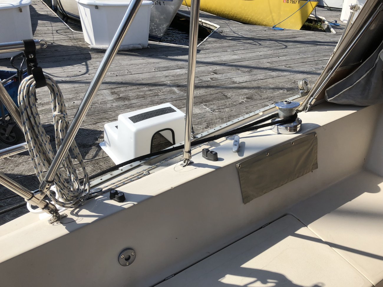

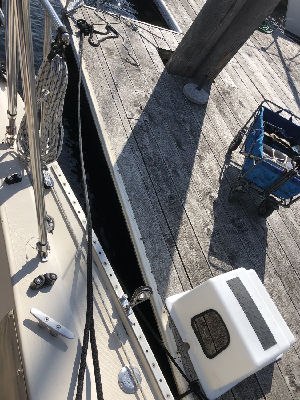

Dear Ward, glad you figured it out. I finally got some pics of my set up.
It works well
