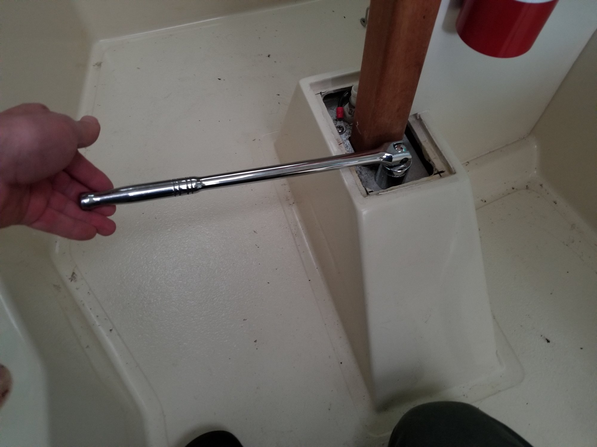

Need to replace the Centerboard up haul line and I can not get the large bolt that holds the Centerboard Bracket in place. This is the one in the cabin next to the mast compression pole. Using a 14" breaker bar and it only moves like 15 degrees and then freezes up as if I were tightening it. Need my entire leg strength to turn it either direction.
Anyone else needed very high torque to get this bolt out?

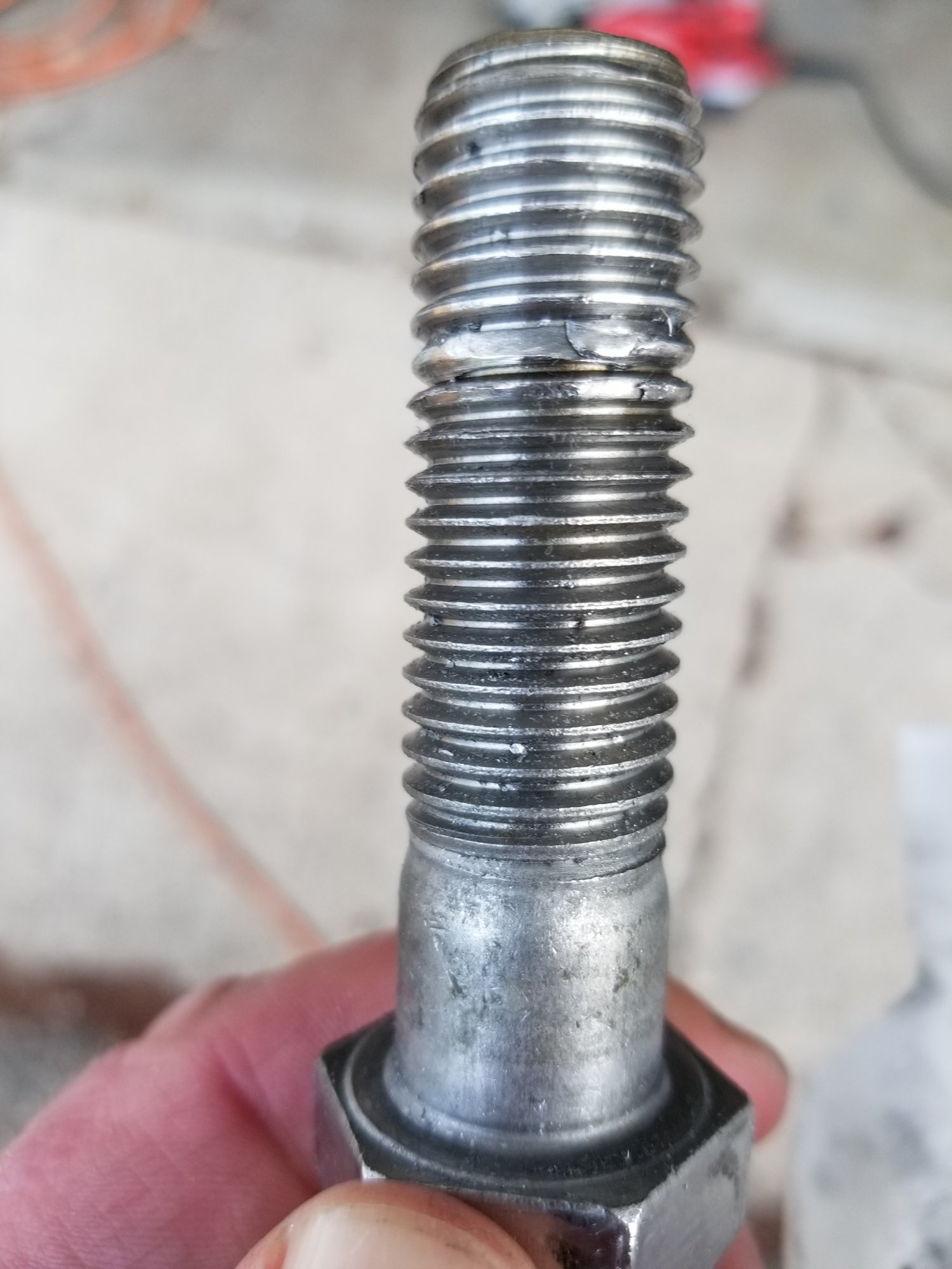

Turned out I had one bad thread on the retaining bolt, see photo. Luckily I was able to get it out using this method:

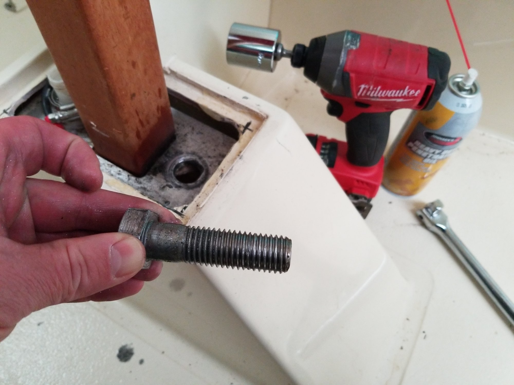

1) spraying penetrating oil under the head of the bolt and letting it sit overnight.
2) rapping head of bolt with larger hammer 15 times. Applying more penetrating oil.
3) using my electric impact gun on low setting to tighten and loosen the bolt a dozen times. In my case the bolt would only turn about 1/8 of a rotation in either direction before freezing up again. I flooded under the bolt head with penetrating oil again. I kept tightening and loosening the bolt noticing that on the loosening turn it would rotate a little farther each time. I was concerned there was no gap under the bolt head. But this was because the center board and bracket underneath was falling down holding the bolt tight. I then turn my gun up to medium strength and fully loosened the bolt.
I will need to replace the bolt and clean up the nut threads.

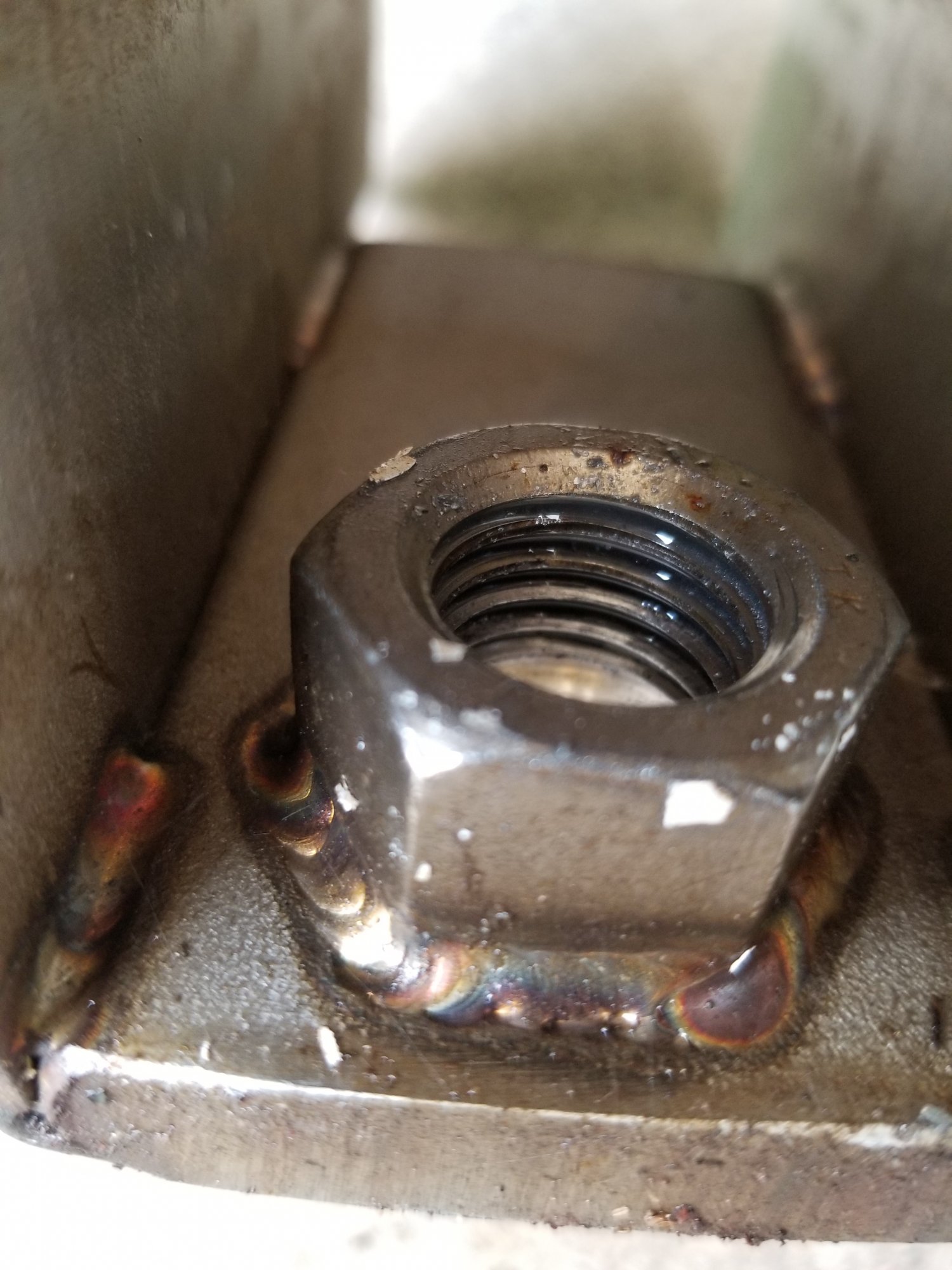

I was involved with that design. The last person who installed the bolt mis threaded the bolt by forcing it on. I always tell everyone to hand tighten first before applying a 1 1/8 deep socket. The good news you did get it off. Yes a new bolt is required. HOWEVER, NOT ONLY ARE THE THREADS SCREWED UP BUT THE WELD HAS BEEN COMPROMISED. SUGGEST HIGHLY YOU WELD A NEW NUT ONTO THE BRACKET. AS FOR PARTS FOR YOUR BOAT, go thru the forum store. You can buy a new 3/4 inch bolt and nut stainless of course from some hardware stores or companies like Fastenal
Do not think you can repair a nut when it has been scored. Tried that and replaced the nut.

I’ve been around seized, corroded, cross threaded , broken threads, bolt extractions , retaps , and dye situations on bolts and fasteners for 35 years plus , marine and automotive. Make sure you get the highest grade quality stainless steel bolt , there’s definitely a difference, and Home Depot carries low quality. Have the nut weld checked for weld cracks and twisting !!! If the weld nut is good , run a tap down thru the nut and clean up the threads . Hopefully the threads are in good shape , otherwise you will need to weld on a new nut .
