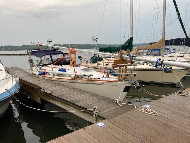

There are many ways to carry a mast on deck. Key parts are putting the butt of the mast forward, (fewer expensive parts to damage), covering both ends with buckets or some protection, and lots of cargo straps. This is Second Star with the mast on deck and only secured well enough to get from the travel lift back to the dock. In the end there were many more cargo straps.
I carried the mast on the center line. Along the Erie there are places and locks where you don't really have choice about which side to dock on. I also set it up so the boarding ladder on the stern could be used if someone fell in. More photos are available.
@dlochner You were putting your mast up and down with a crane, correct? Also, you took your spreaders off looks like.
How would you position your mast like shown if you were dropping the mast yourself without a crane?

14,248
dj
Yes it a crane took it down for last winter's storage and the spreaders come off because the storage fee is cheaper. A travel lift picked it up and put on the boat.
I really haven't thought about how I would store if I were doing the work myself, because the mast at 54' and probably about 400 to 500 lbs fully rigged is bigger than I want to manage.
When we take it down next summer to go back through the Erie Canal we'll leave the spreaders on and set the mast on its side (more or less) to get the spreaders vertical. Lots of bungee cords will keep the shrouds and stays organized.
We did set the boom on the starboard side as most of the locks will be taken on the port side.
Even if I had a smaller boat, I would still opt for a crane to put the mast up and down. When the time and expense of developing a safe and effective self-stepping method is considered the actual cost of a crane is not all that much more. A crane probably saves time, as it will not be necessary to rig, unrig, and store the mast stepping device. Not to mention the difficulty in finding a marina that would allow you to step the mast on your own. Or finding help on the dock. For me, its just not worth the extra effort and hassle. And if the stepping is unsuccessful, what will the insurance company say?
