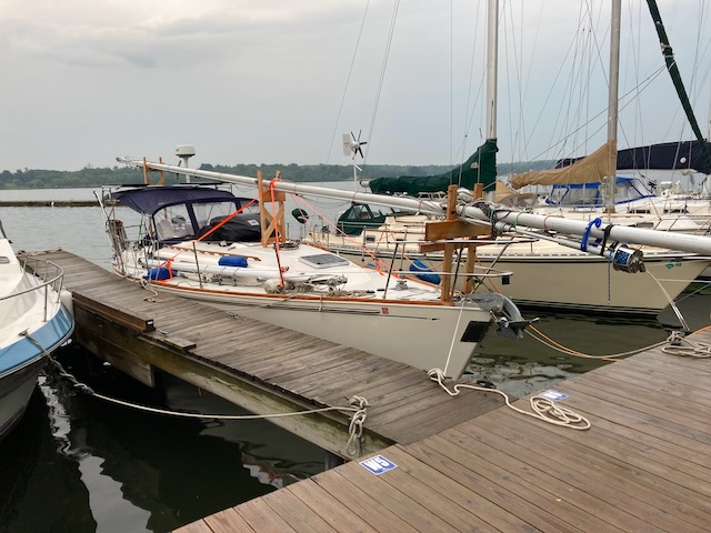

There are many ways to carry a mast on deck. Key parts are putting the butt of the mast forward, (fewer expensive parts to damage), covering both ends with buckets or some protection, and lots of cargo straps. This is Second Star with the mast on deck and only secured well enough to get from the travel lift back to the dock. In the end there were many more cargo straps.
I carried the mast on the center line. Along the Erie there are places and locks where you don't really have choice about which side to dock on. I also set it up so the boarding ladder on the stern could be used if someone fell in. More photos are available.
That must have been a keel stepped boat given that the base of the mast is beyond the furler drum. You mention leading with your butt to protect the expensive bits and bobs.
On a deck step mast, leading with your butt will result in your furling drum supported only my the foil being the the first thing to any frontal encounter. :facepalm:
That's correct and my mast is keel stepped, which makes a 36 foot boat a 54 foot boat.
On a deck stepped mast there needs to be support for the furling drum and foil and it is better with the masthead forward if everything is stripped off the mast head.
Also, because deck stepped masts are shorter there is less overhang and by having the mast higher in the back than in the front the over hang can be reduced.
