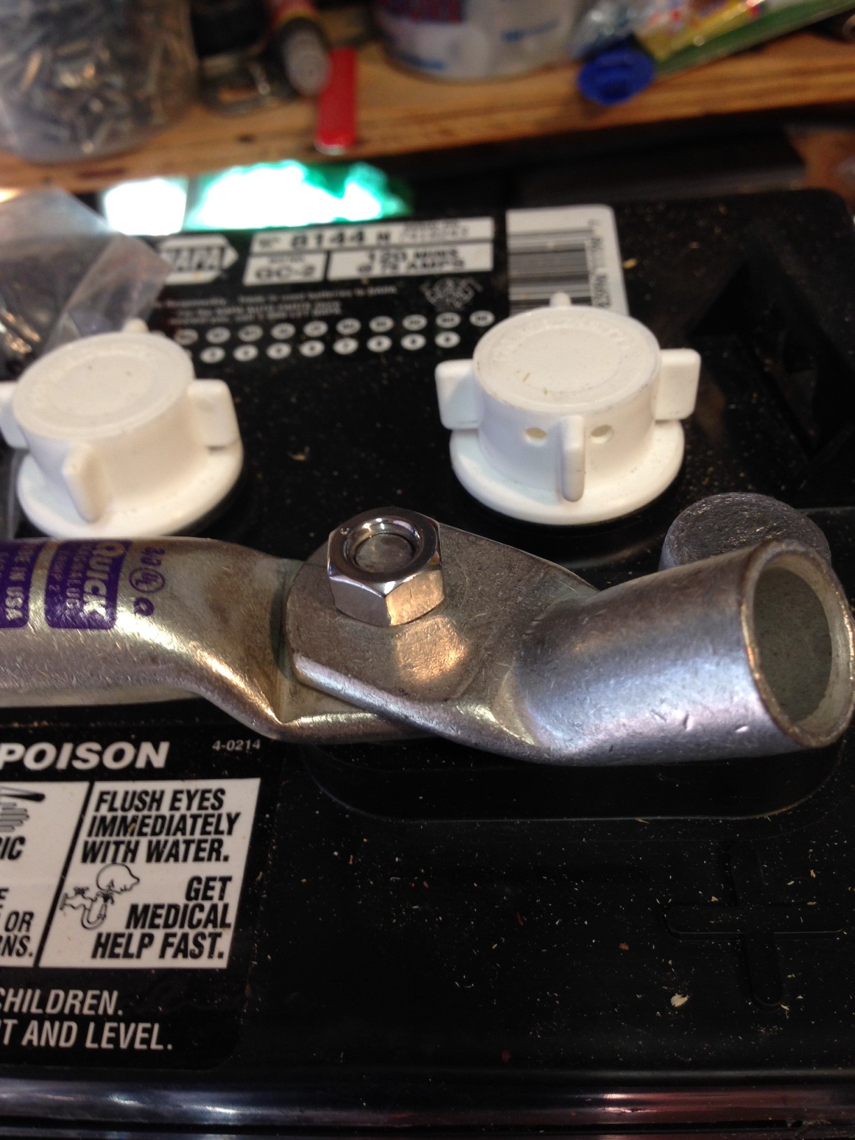

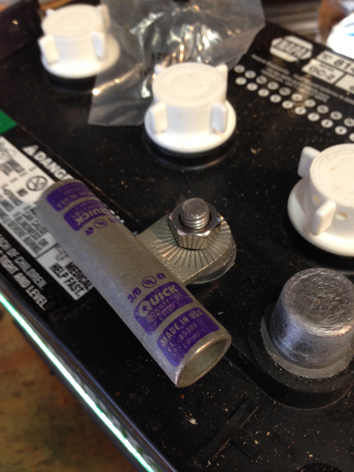

I am trying to finalize the hardware for a battery install. On our last boat, I used heavy duty Quick lugs, but they are so thick that putting two on a stud barely leaves room on the stud for the nut alone, much less if you would put a lock-washer on it. And forget a temp sensor.
What lugs do you use because I have seen some real cheap-o's out there?
In addition, I have a couple of places in this 11-battery bank where I could use a "T" lug. Is there a compelling reason not to use them?

For batteries with short studs I use "Flared Starter Lugs the ones I use are sealed ended and tinned and made by either Molex or FTZ... The SBO store has the FTZ terminals just click the text link above. I don't use T terminals as the cable angles I need rarely work out...

Should there be lock washers on the nuts?
What is the correct torque for the nuts?

Yes ideally there should be but not always possible an Nyloc can often fit where a split washer can't but you need to ensure the nylon is making thread engagement.. Each battery maker specifies their own torque. Normally in inch-pounds z(in-lb) not foot pounds..

One follow-up: Are these 1/4" studs on the East Penn GC2's (NAPA)? It sure seems like the 5/16" (or what I think are 5/16") lugs from Quick are a little lose.
**And BTW... I searched all over the battery for the torque specs and didn't find them. I was about to give up, but when I went to pull one of the nuts out of the bag they provided hanging on one of the studs... There it was... printed right on the little bag!**
