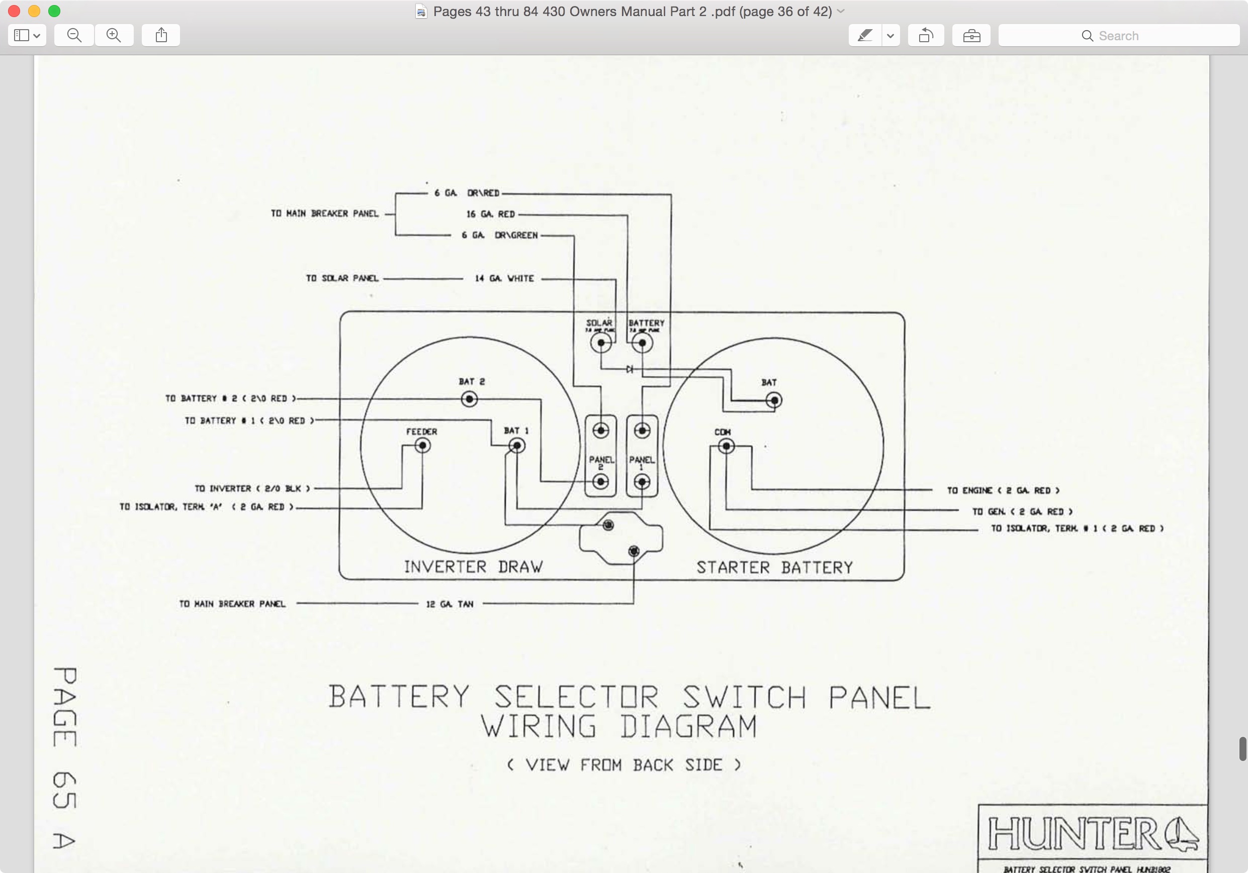

Here is the back side wiring diagram for my batter switches. I just noted the Com line for Starter Battery Isolator.
My guess is it acts to isolate the genset alternator from engine alternator.
What is it? What would it look like, 1997 vintage? Where might it be located?
Jim...

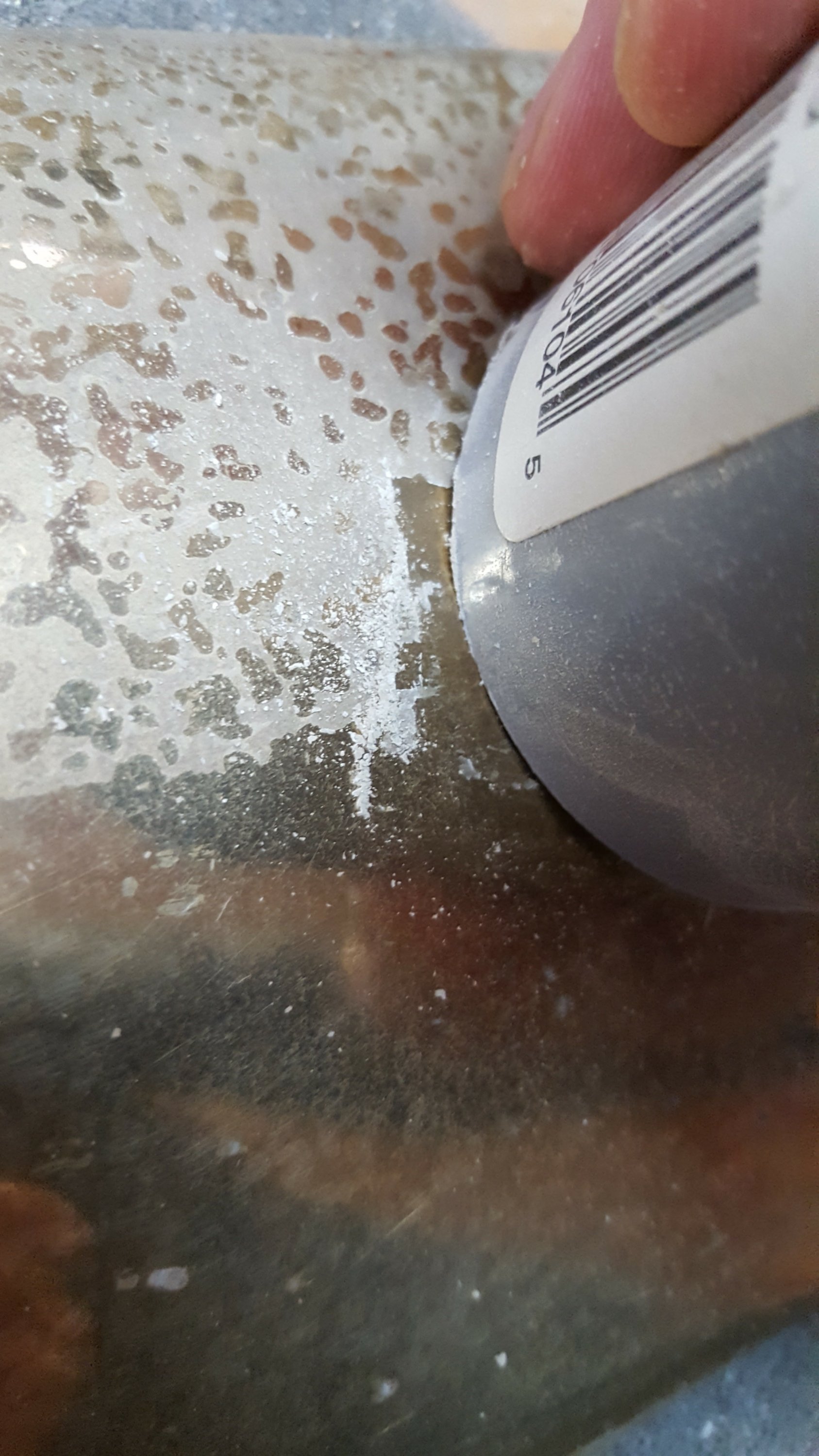

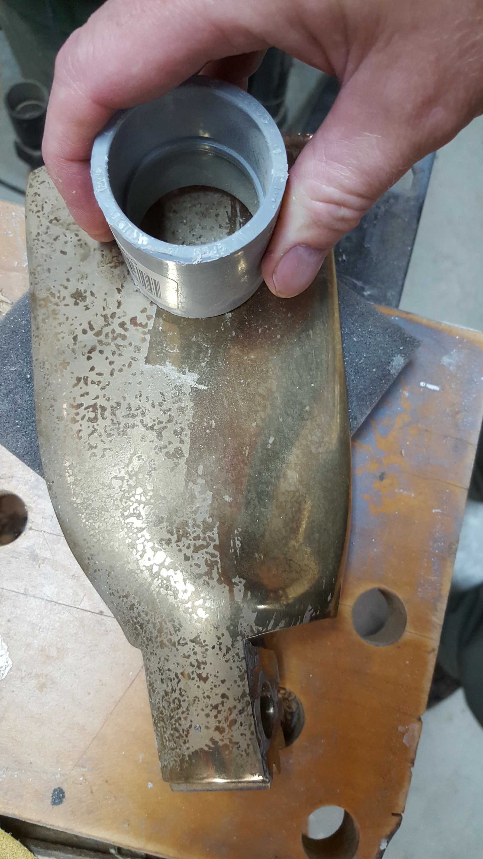

Question: What is forming this layer on my Gori prop?
I can scrape it off with a piece of hard plastic. It is immune to vinegar, CLR, acetone, paint stripper, and denatured alcohol. As you can see, once scraped off, the finish is bright and shinny. I'm in fresh water, and have magnesium anodes on my stainless shaft. The spotty appearance in the "unscraped" area is due to some light marine growth that I washed off after haulout (can't remember if the growth was on the bare metal spots, or where the "layer of stuff" is. Once scraped, the surface is smooth (no pitting or difference in surface height).
Any idea on what this is? And what might make it easier to remove?
Chris
