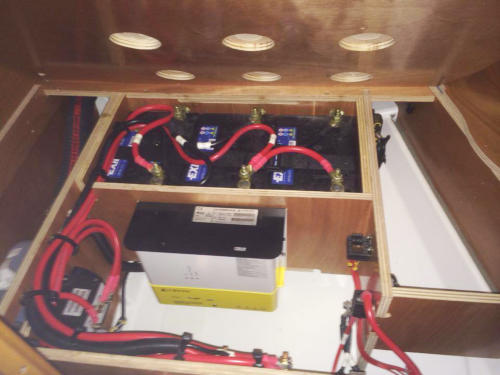

My new boat comes stock with a two battery group 27 house bank and one group 27 start battery. Unfortunately, there is no height clearance to replace the house batteries with golf cart batteries without major modifications.
However, I was thinking a quick fix might me to combine all three batteries to get me a quick 50% increase in house capacity) and purchase a fourth battery to use as the start or reserve battery.
Although there is no room for a full size group 24 or 27 battery, I might be able to use a smaller agm or gel battery which has much smaller case size. I happened to see some 30 something AH ones in WM yesterday which is where I got the idea from.
It would receive its charge exclusively from the alternator after passing through the factory "cristec" isolator I mentioned in a previous post.
Is this doable?
