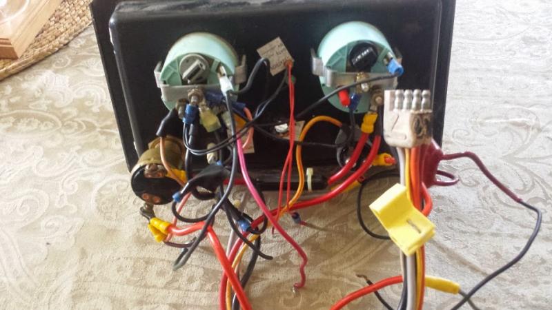

For the hall of fails...
Here are three photos for your hall of fails. I was called this morning to troubleshoot a Universal M25 that was slow starting, and sometimes the starter would engage but not turn over. The owner already replaced his starter and now wanted to replace the start button. One look "behind the curtain revealed the real problem(s)

Maine Sail & I and many others have been warning about this and the M25 alternator bracket for soooo long it's silly.
You can make the information available, but you can't make 'em read it or do it.
Nice of you to help.
I also recommend that skipper read our Critical Upgrades, which include lots of other M25 engine material:
Critical Upgrades http://c34.org/bbs/index.php/topic,5078.0.html

I bounced him the link just before I posted the pictures. :dance:
At least I can work on it in the comfort of my house instead of cramped in the boat, and since I made these very changes to my boat a while back, it should be a quick fix.
