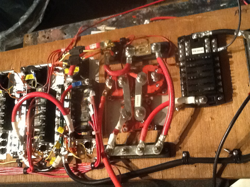

I have been working for some time to upgrade the wiring on our boat. She came to us with a three batt 4d house bank and a start batt (all 12 v). Additionally some older solar panels. Wired in is a Trace C30A+ solar charge controller, a West Marine battery combiner II , an alternator and an older Guest 50 amp charger. The only gauges are in the instrument cluster (volt and amp).
I have thus far cleaned up post production add-ons and am now working toward changing fused system to breakers. In that phase, (or first) I would like to add a SOC guage. First however, I am planning to fuse the batts to ABYC and improve cable/load And am tracing all wiring.
I remain a bit puzzled by the interaction of the supply side components.
Perhaps this is too broad a question: how do all these components interact?
What I should ask is: How do I determine each component is functioning properly interacting with the others?
