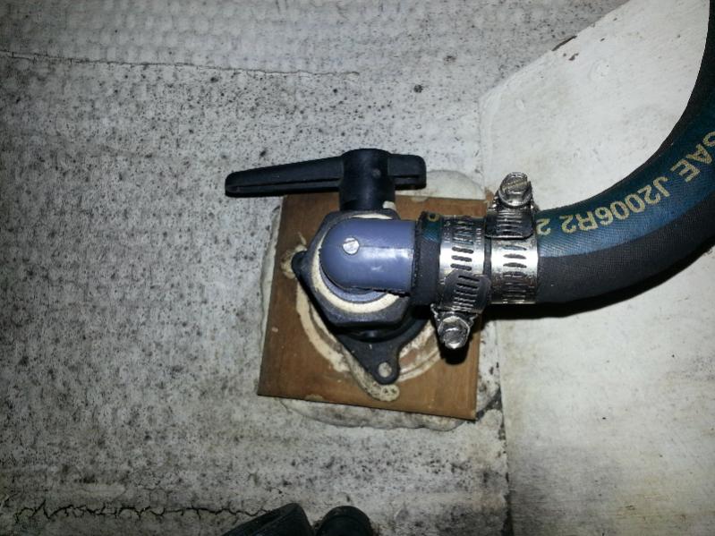

Has anyone ever heard of using 4200 in lieu of teflon tape or pipe dope from flanged Marelon seacock to a barbed elbow or tailpiece? My boat was done that way back in the day.
Sometimes when using an elbow, when it screws all the way in it is pointing in the wrong direction. With teflon tape at this point you wouldn't want to lossen it but thinking that 4200 would stiffen/seal the joint... throughts?
The only reason I'm touching these this winter is to replace some older hoses and remove the grey pvc the original manufactur used.

Never have seen anyone use a permanent (even semi) sealer/adhesive on a threaded connection you may want to disassemble, Makes sense, right?
You already know that thru hulls and sea cocks are a different thread (parallel, not tapered like home plumbing.) So, these's no taper (or interference fit) for the male/female to tighten against one another. Therefore, there's no need/reason to tighten/bottom out the elbow or tailpiece. The seal depends on only the Teflon tape or pipe dope filling the continuous peak/valley that runs along the length of the fitting. Engage the full number of threads and leave it in the position you need for your hose. Bottoming out the fitting does not seal it any better or worse.
So, use plenty of tape or pipe dope (not "plumber's putty" as the Forespar site states (which is a another material meant for something completely different than threaded fittings!)

I always thought Marelon thru hulls and sea cocks were the same thread. Not my issue here though since I'm only talking about between the thru hull and the barbed tail piece. Thanks for your help.
