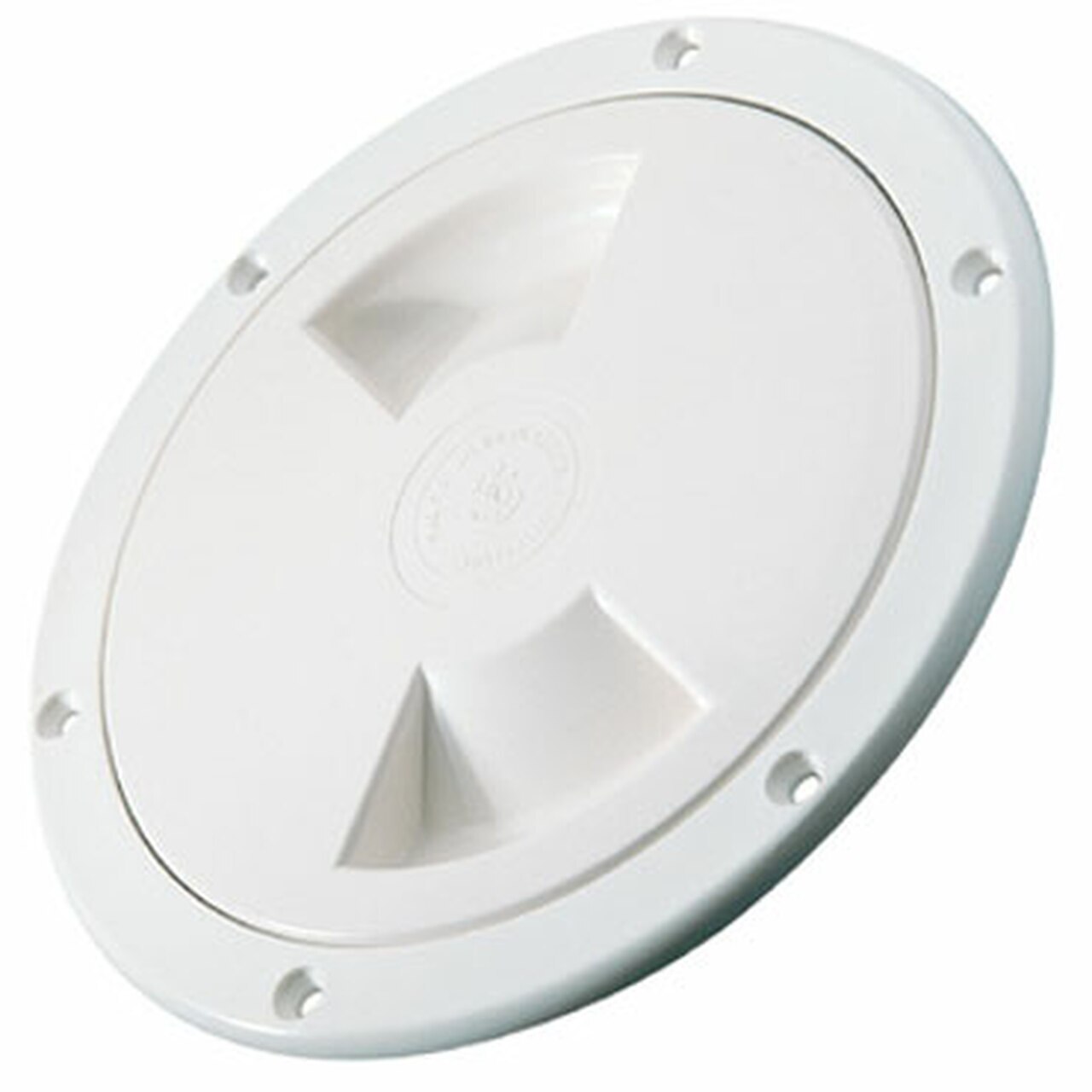

What I am considering is attached.
41wWDcpe97L._AC_.jpgRONPNP96-2__94679.1429010785.jpg.
24,797
That will work. Be sure you get a good gasket that is petroleum resistant and that the screw in port has a petroleum resistant o ring so that the sloshing fuel does not spill out.

I would not use a plastic screw in port on a fuel tank. You need a bolt on gasketed plate IMHO. Easy to make and probably readily available on line.

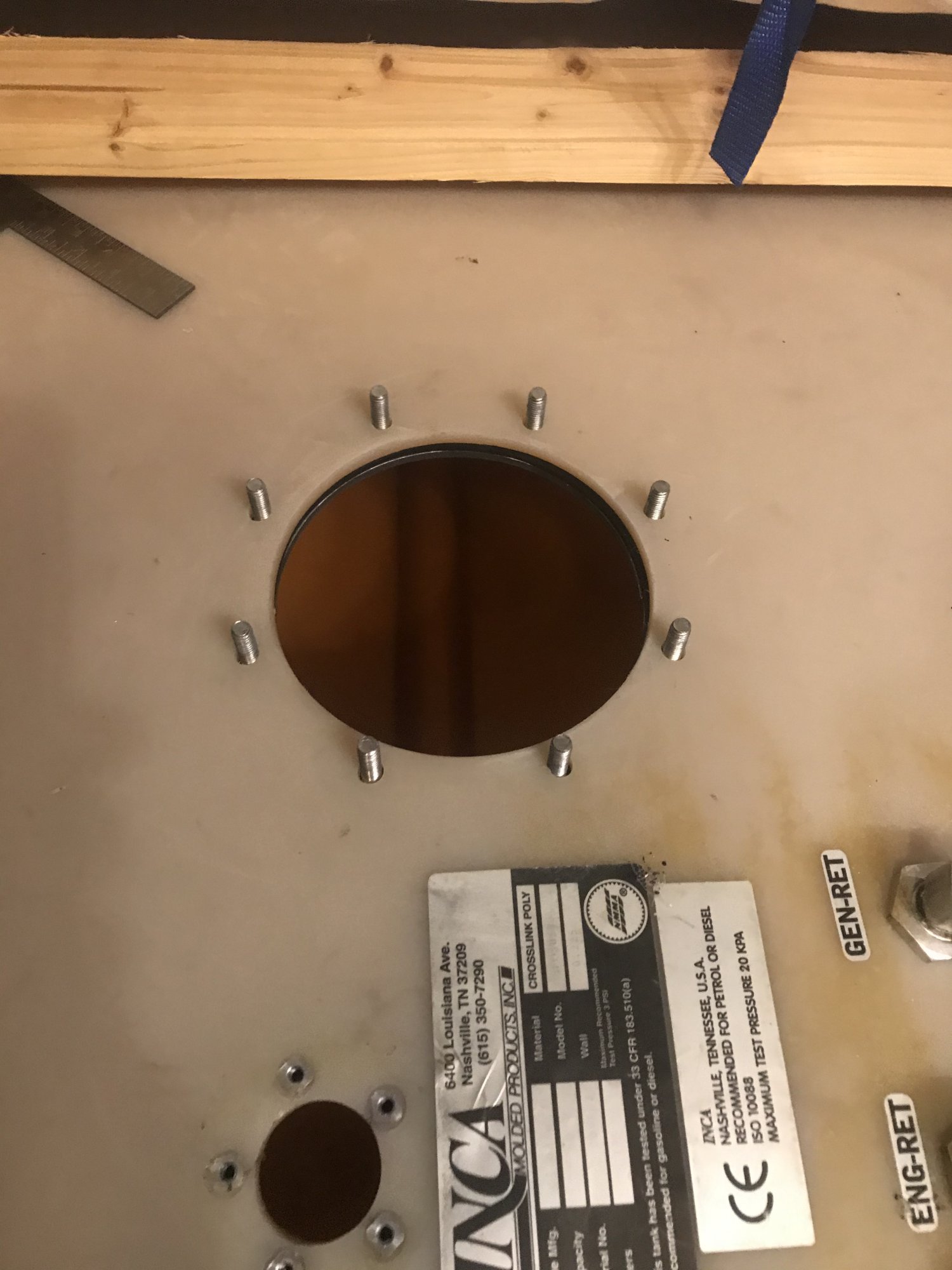

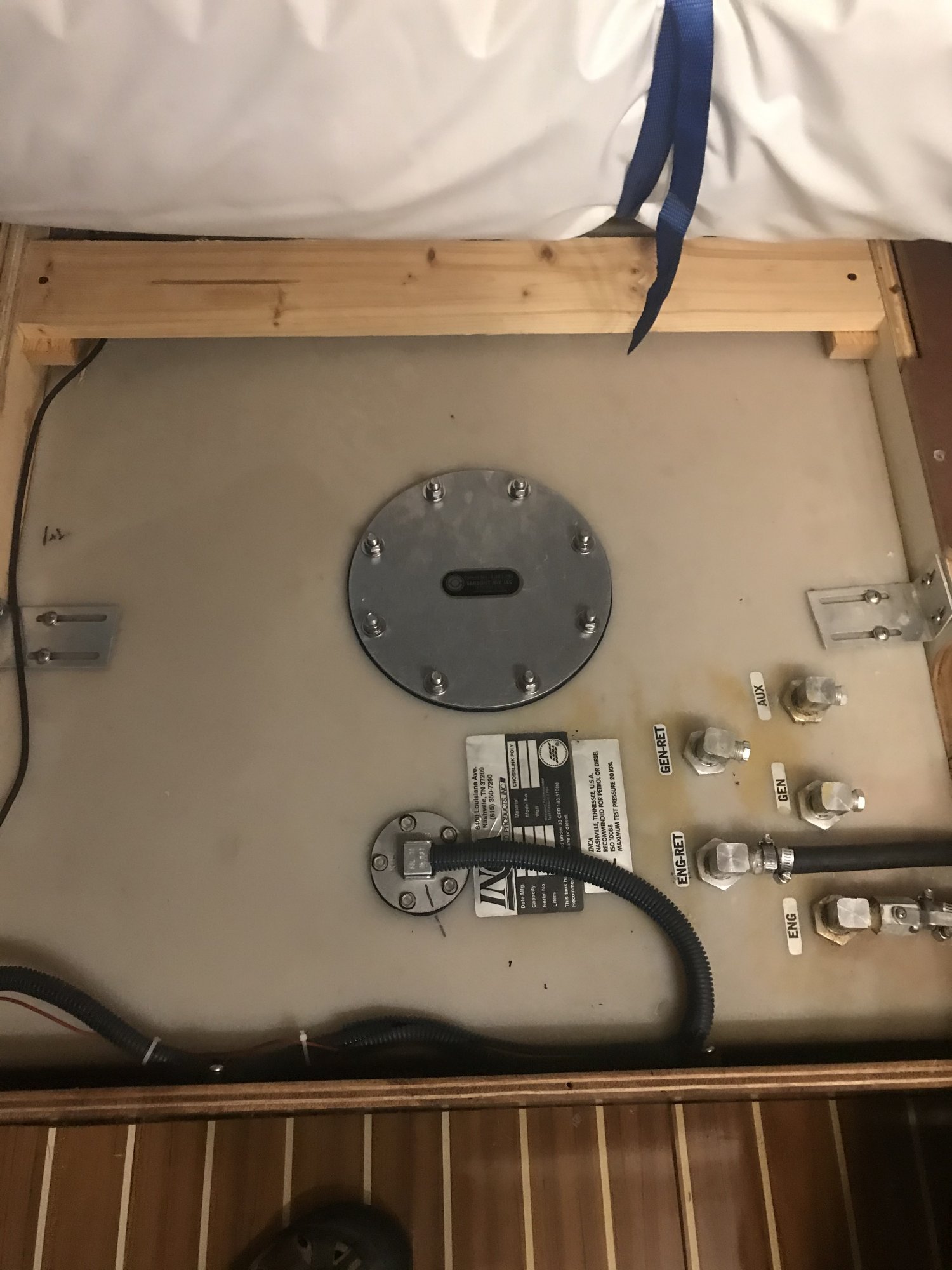

I'm lurking here. Here is the link to my post for the inspection port in my fuel tank.
It is filed under Boat Owners Modifications. Searching doesn't always go to that forum.
Perhaps it's best not to use that plastic Beckson access port. The o-ring seal and the plastic may not stand up to long term exposure to diesel.

Thank you for taking the time to provide needed advice. That was the heart of my question - will the plastic hold up? We store diesel in plastic Jerry cans - so I thought a plastic inspection port would work too. Didn't think about what the diesel would do to the gasket.

THANK YOU - I have been trying to find this article. How in the heck did you fit down that hole in the starboard locker? My teenage daughter call it "the Pit."
