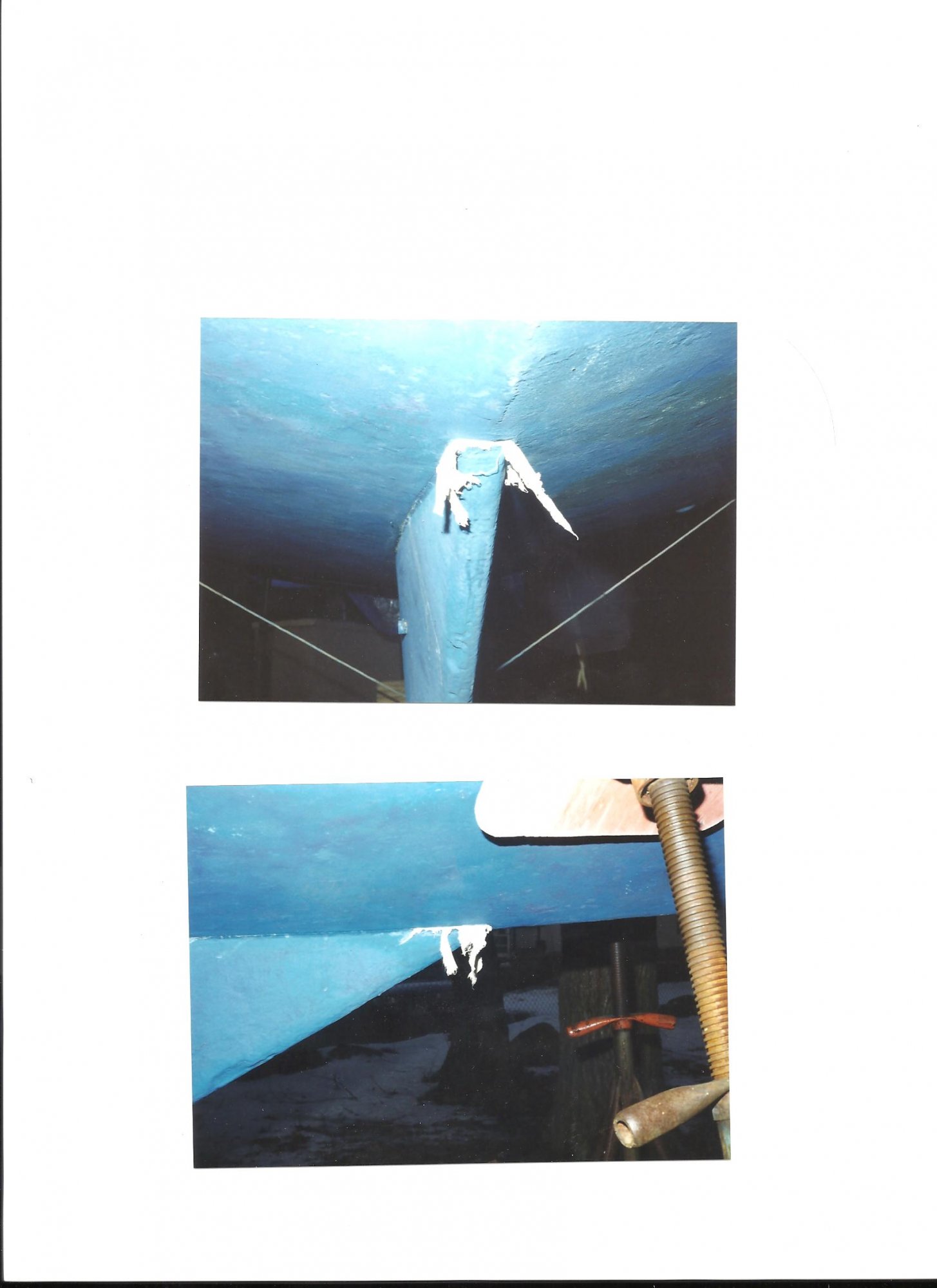

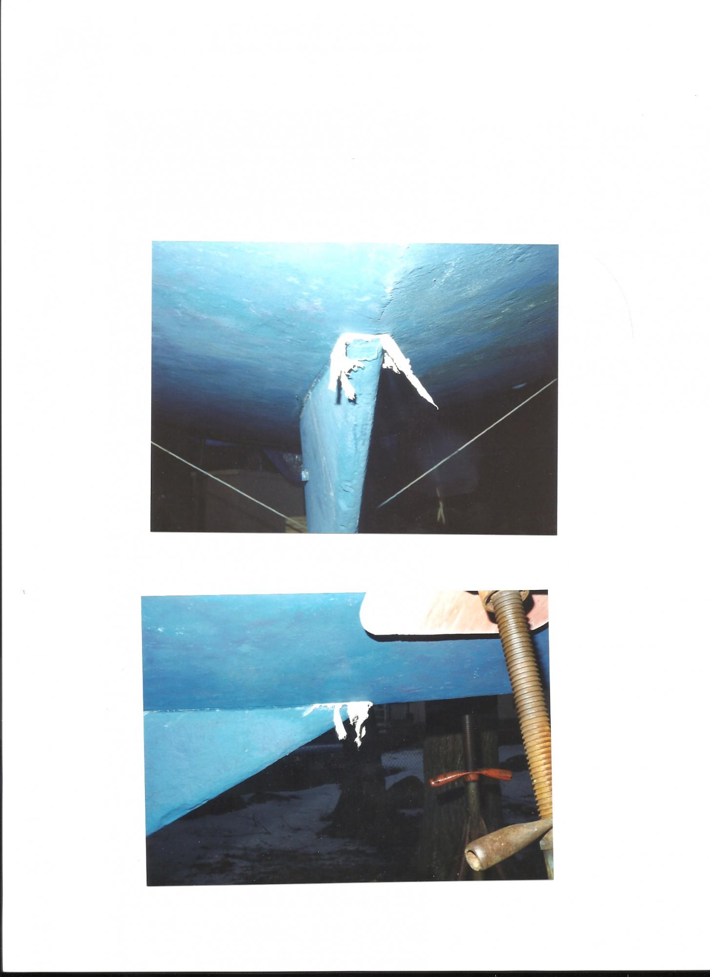

Maybe check your keel to hull joint. I had to dive on my old O'Day when the keel bolts pulled through the hull. I ripped up a sock to stop the leak long enough to haul the boat.O'Day 23 sole replacement 011.jpg
