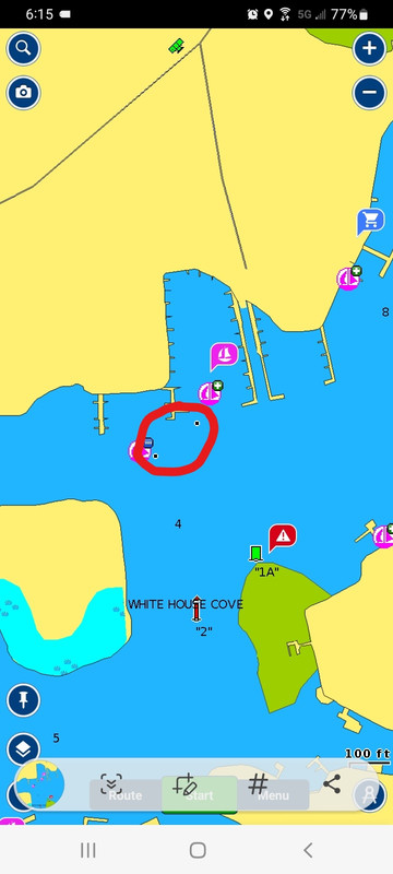

Here is a screen shot of the marina across from mone. Notice the 2 submerged pilings that I have circled. all the locals know about them. That said, hitting one would leave your boat "Desperate leaking"
