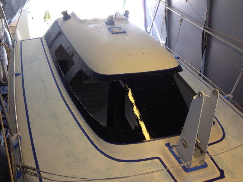

C&C Mega 30 Long Point, Lake Erie

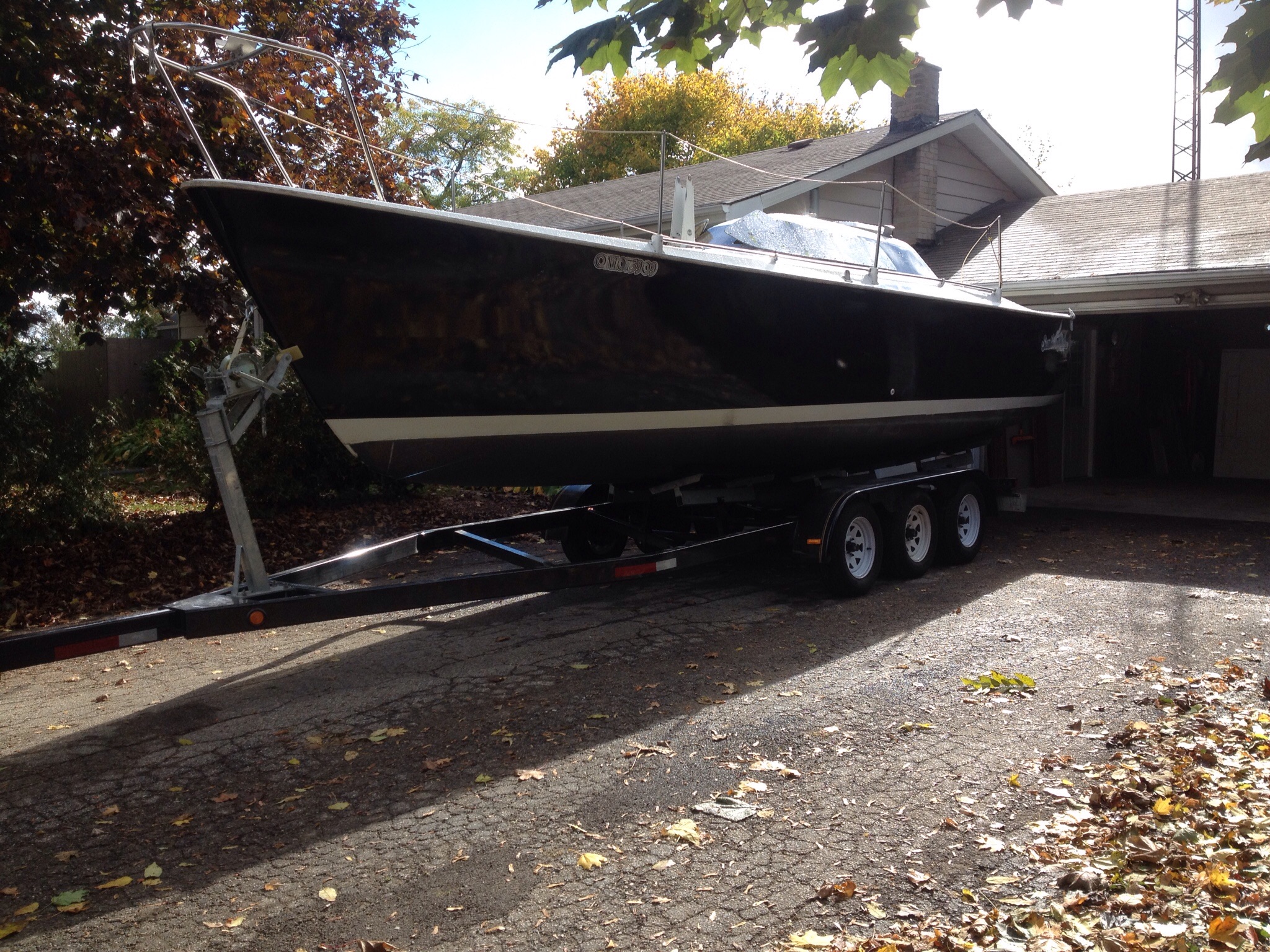

Black applied before new windows installed. Went for a new modern look, to "disguise" the undesired factory window design.

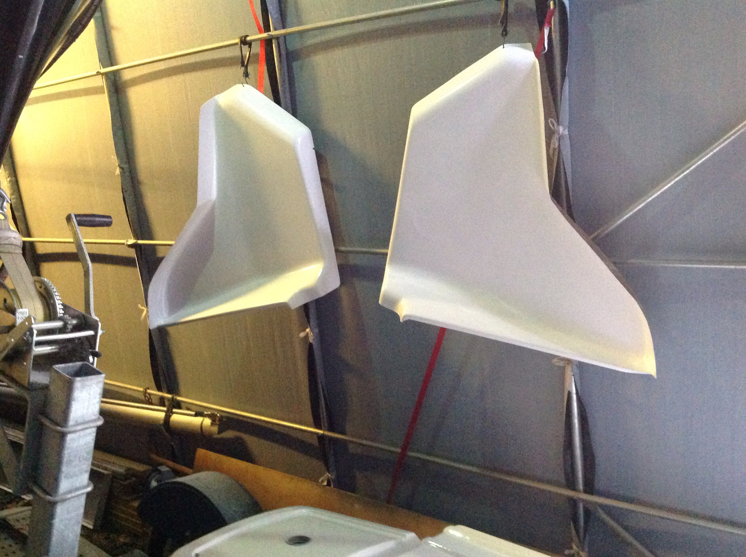

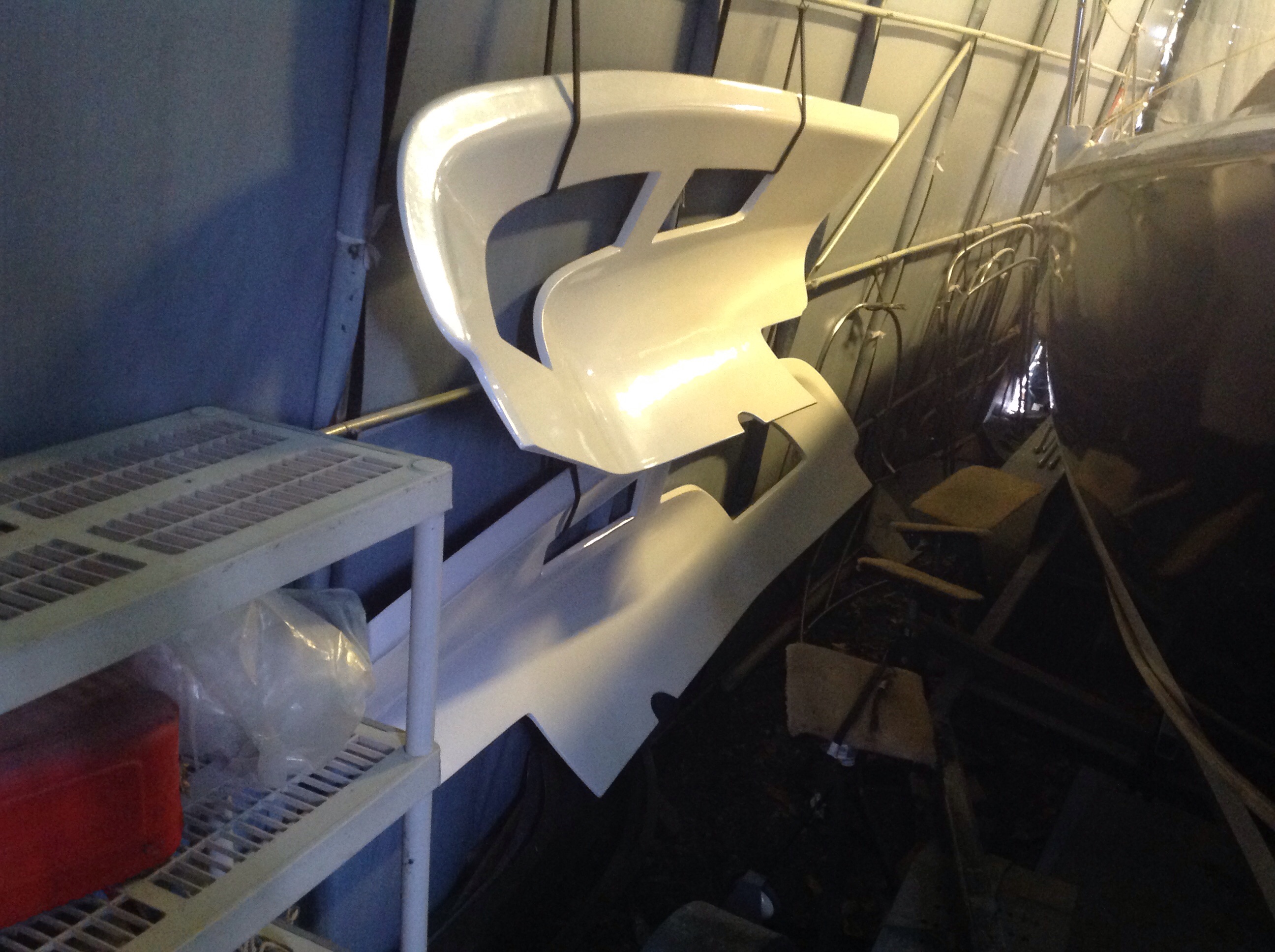

Just prepped the inside factory fibreglass liners for paint. Two aft cabin wall inserts, two cabin window liners & two keel trunk panels.

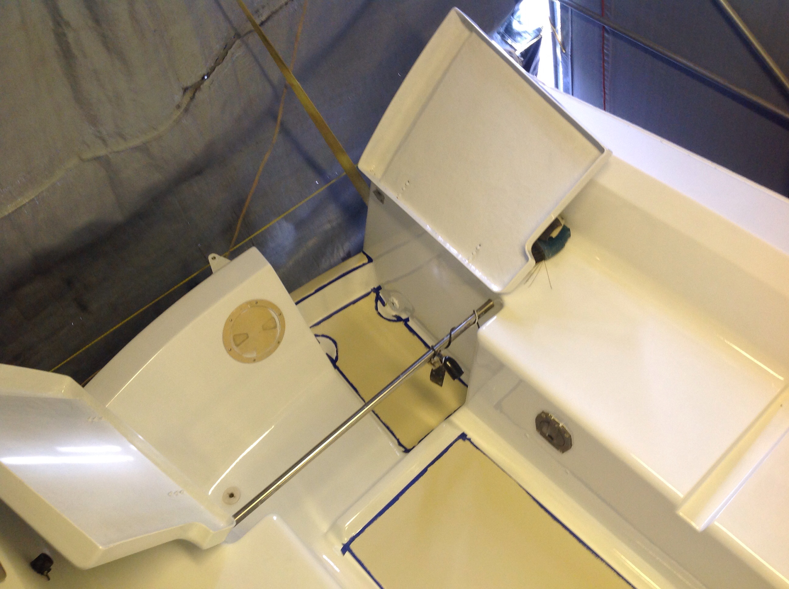

Made aluminum trays...light but strong.
The larger will house the two 20 gal. holding tanks (waste & fresh water)
The smaller of the two trays will house three batteries (2house 27N's & 1 starting/ house 27N)
These will be mounted behind the companionway ladder beneath the cockpit.
The tanks and batteries will be fastened inside the trays with straps.

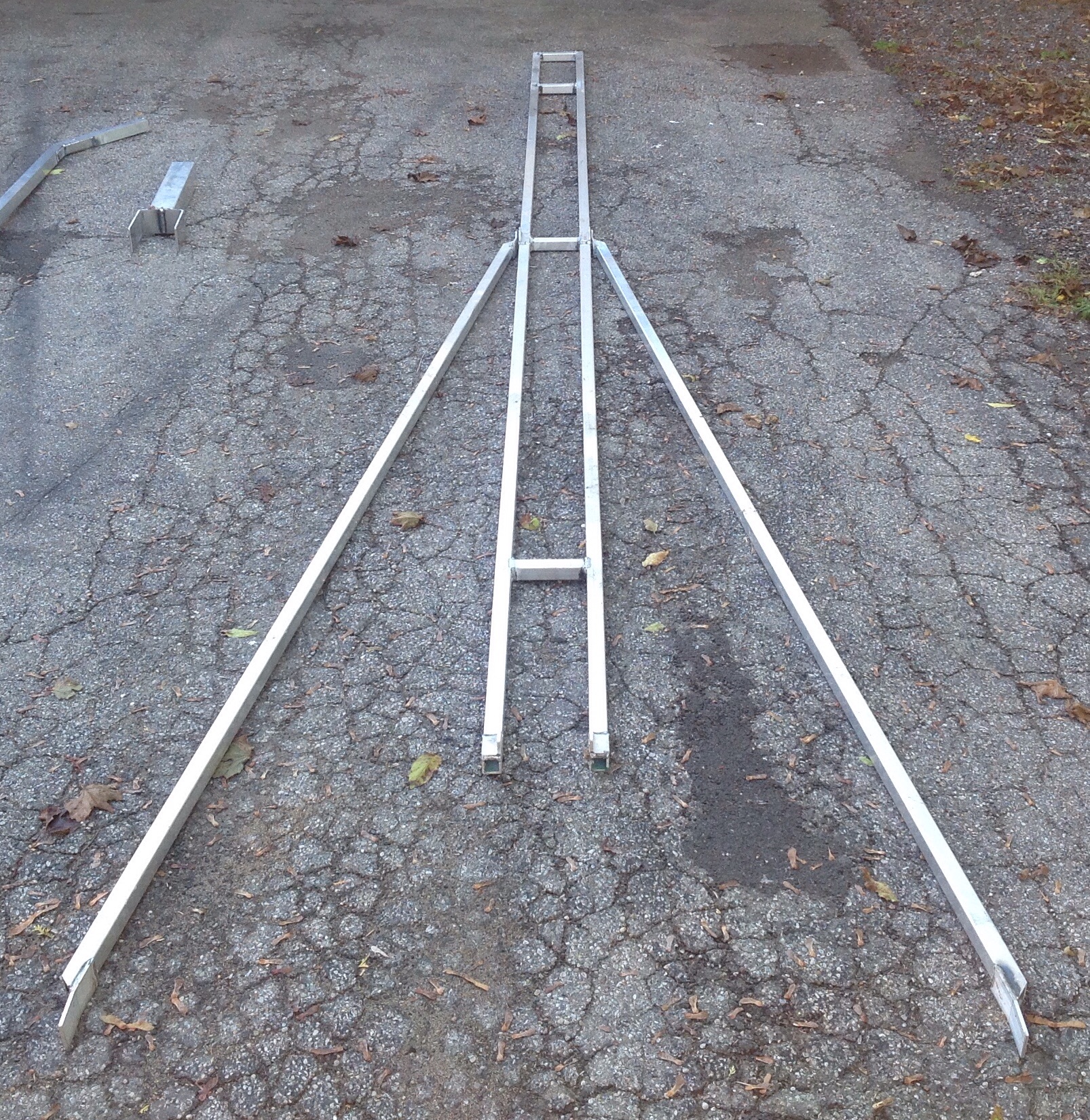

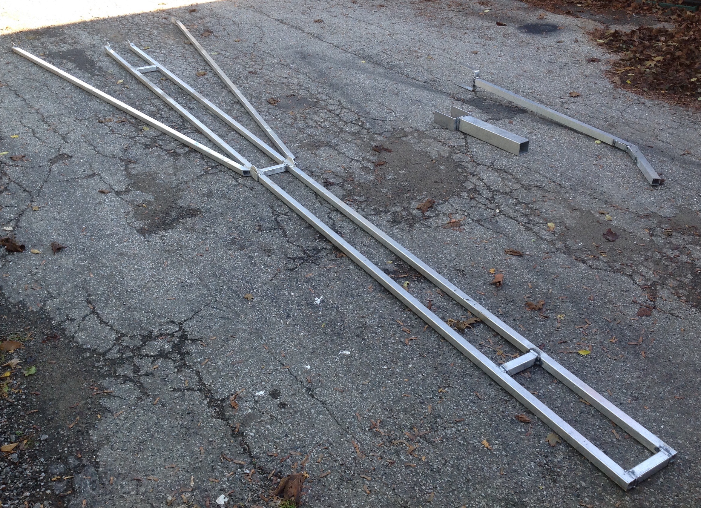

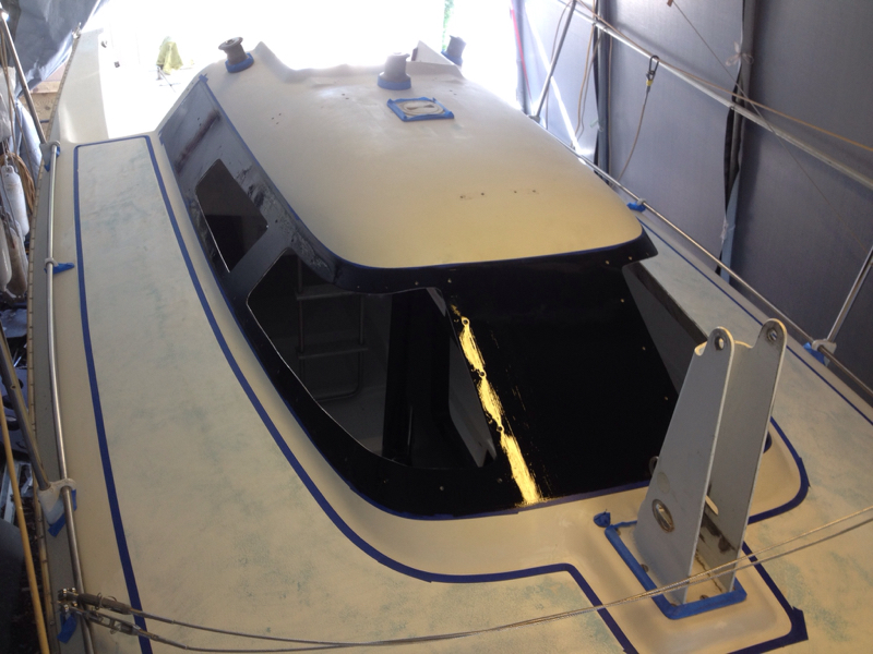

Mast raising system designed and built now.
Made of aluminum.
Base of centre section attaches to mast tabernacle. A-frame leg supports to gunwale plates made out of HDPE. The leg supports will have zero downward force during the stepping process. All weight of the mast and rigging is transferred to the tabernacle compression post & keel which is supported by the trailer bunks and keel pad. Mast stepping is always done on the trailer.
System will be bolted and locked to trailer once mast is stepped.

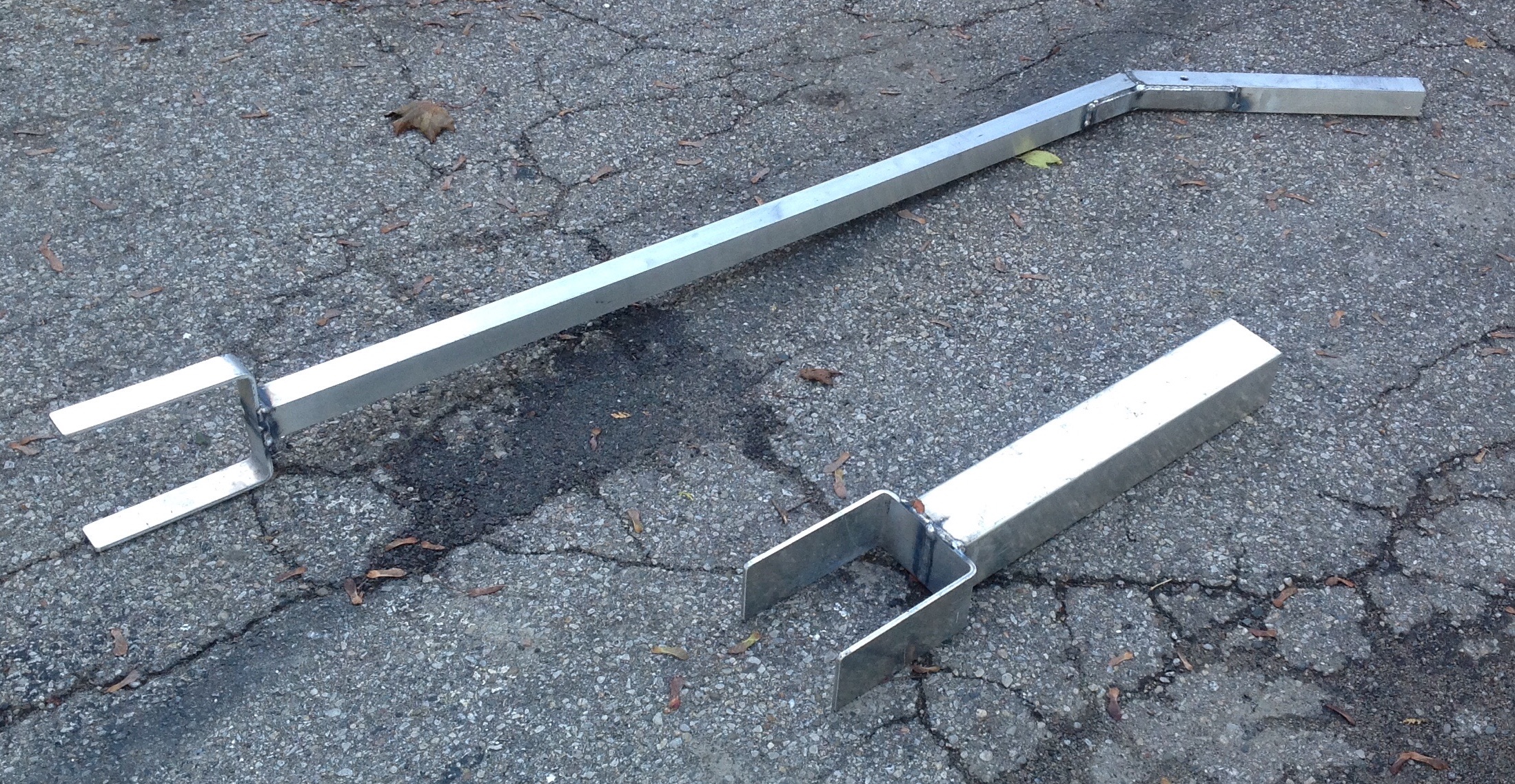

New mast crutches designed. One for the tabernacle which be adjustable, the larger for the aft attaches to the rudder housing.
Have to drill and install the rollers still.
Again, built with aluminum.
Will be bolted & locked to the trailer frame when boat is launched.

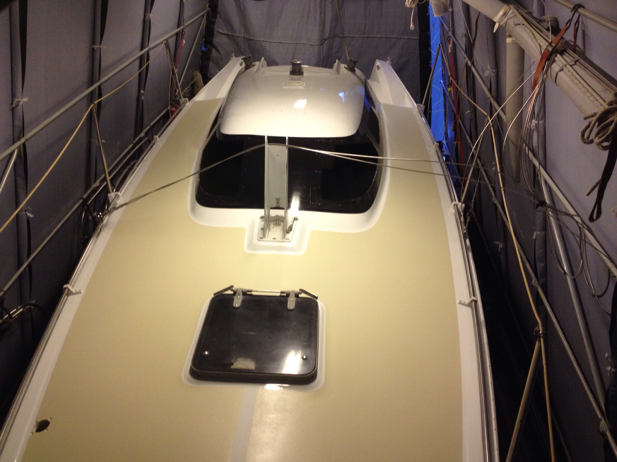

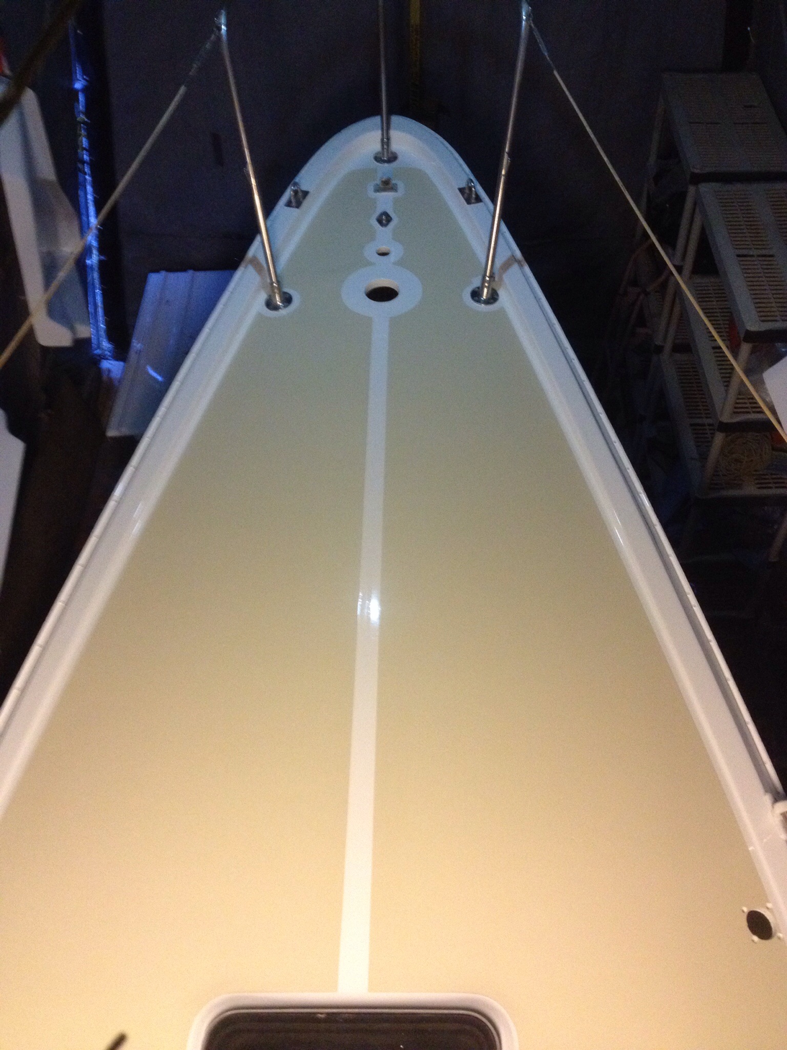

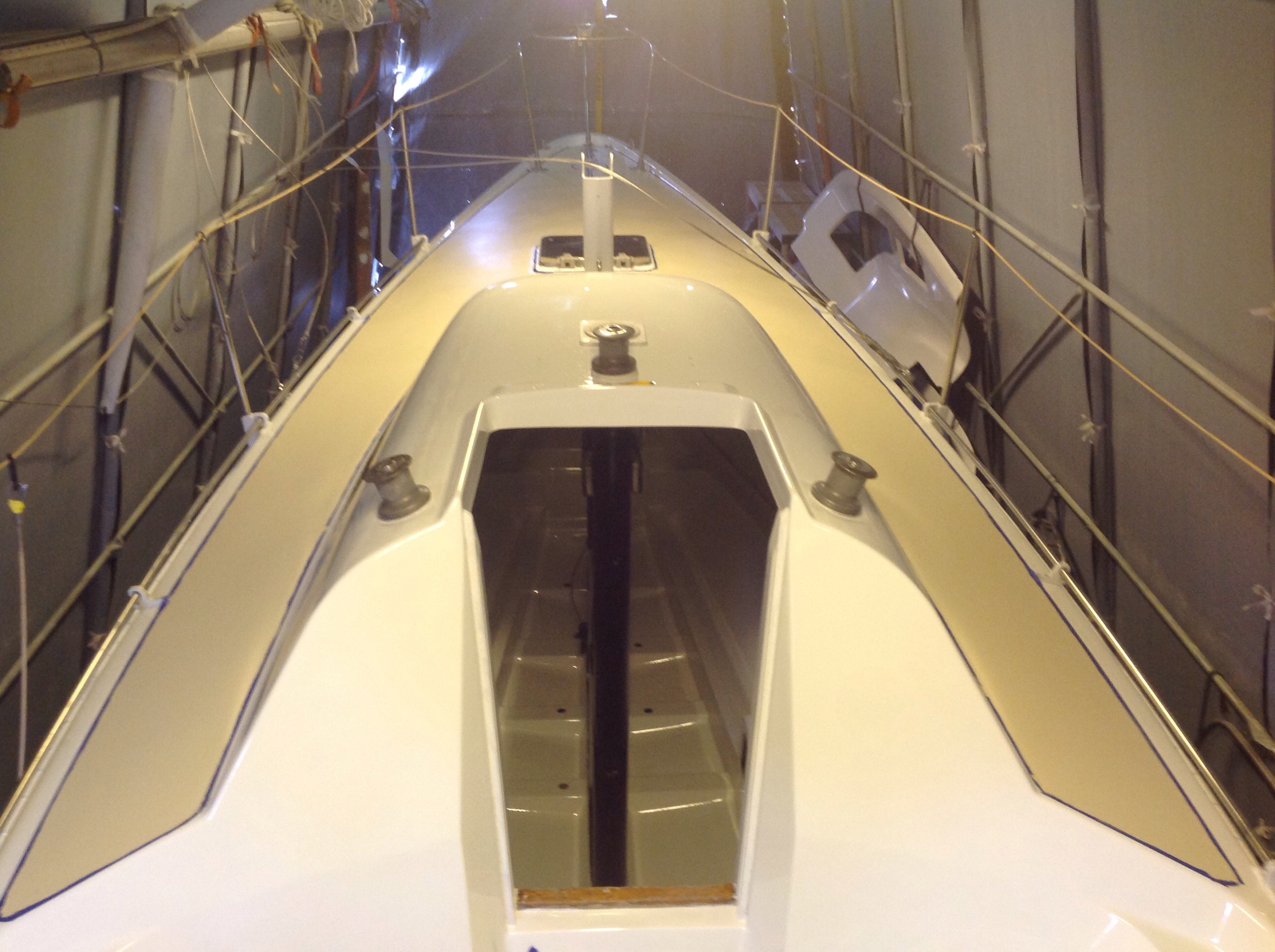

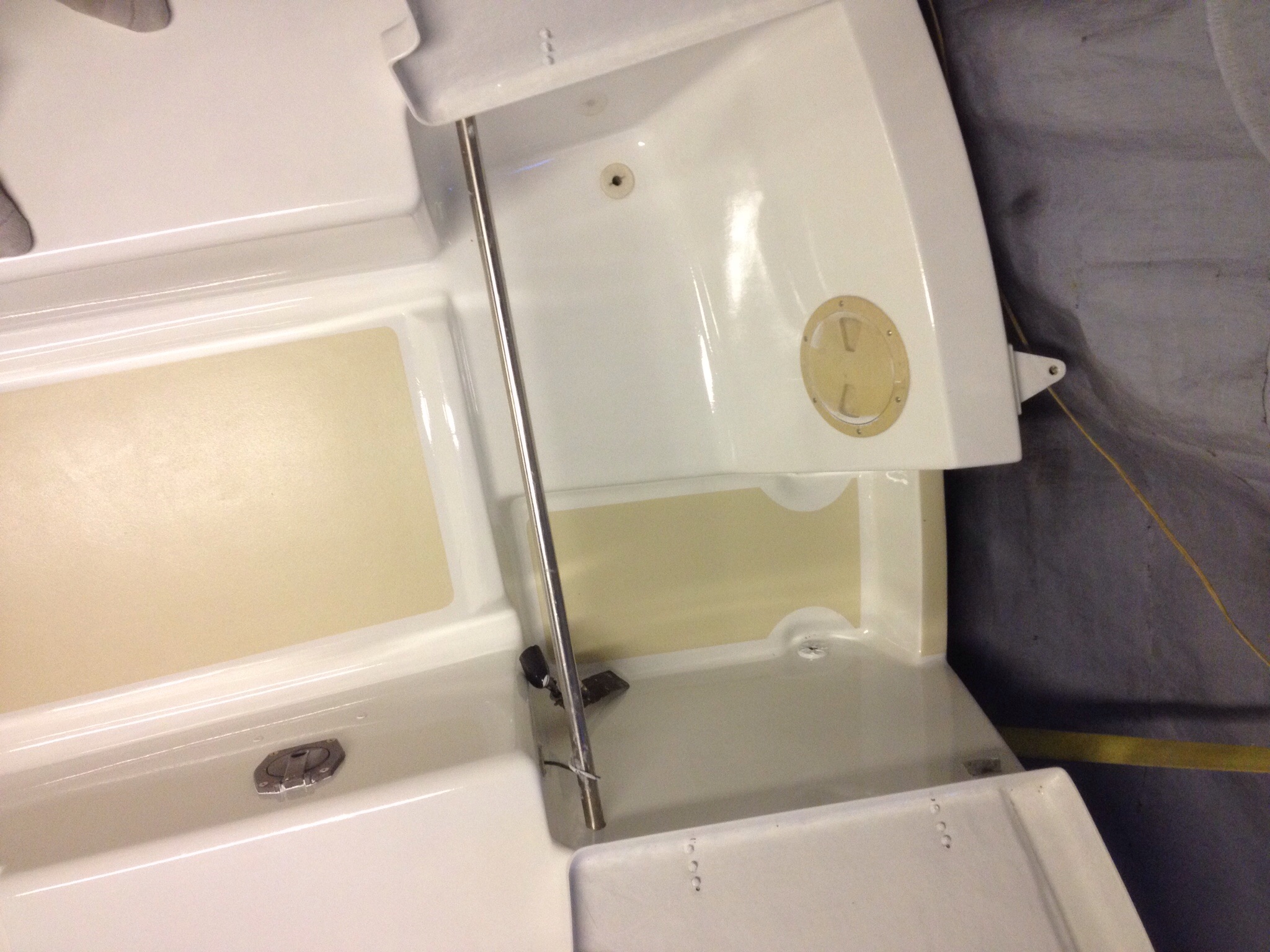

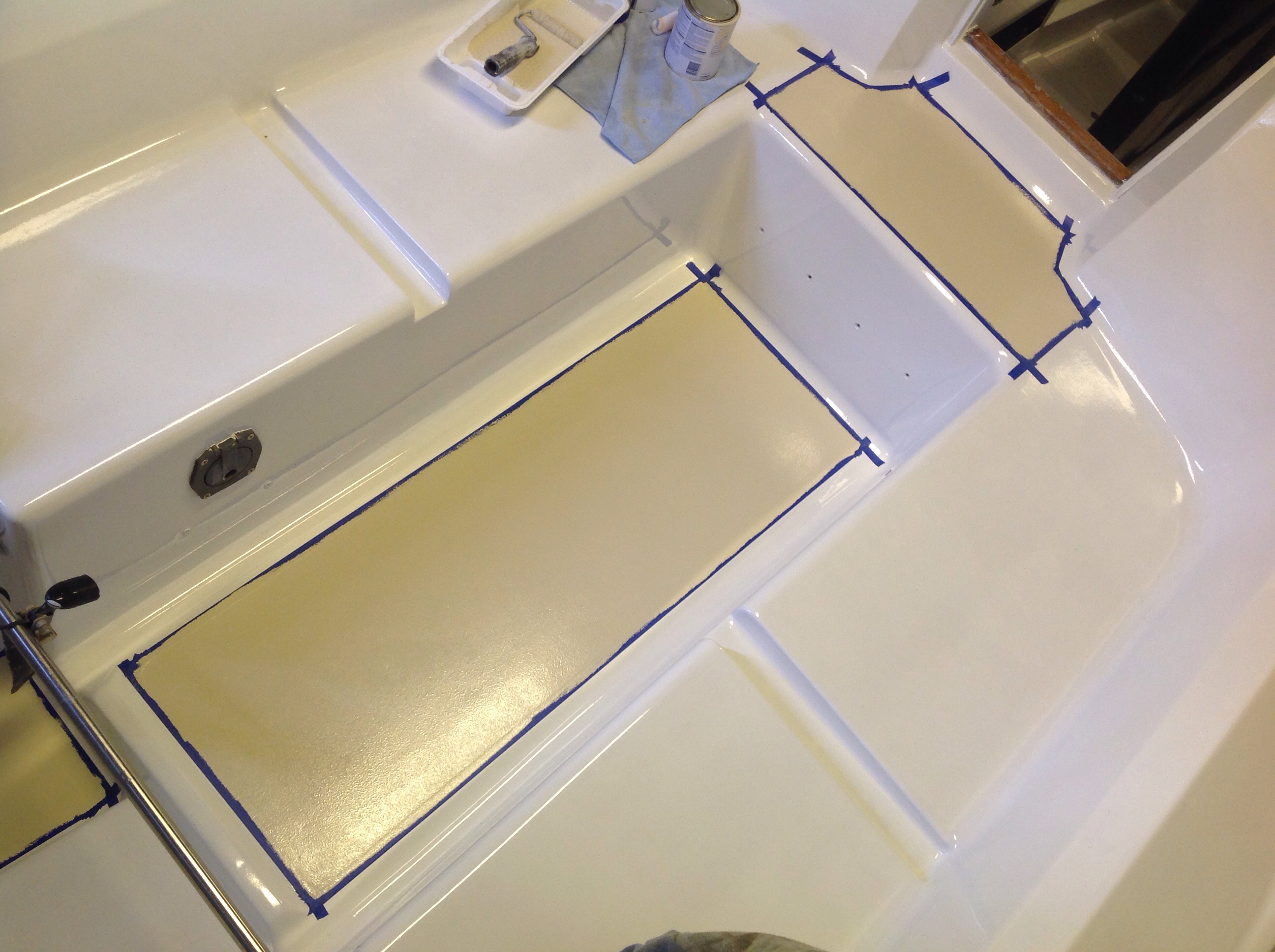

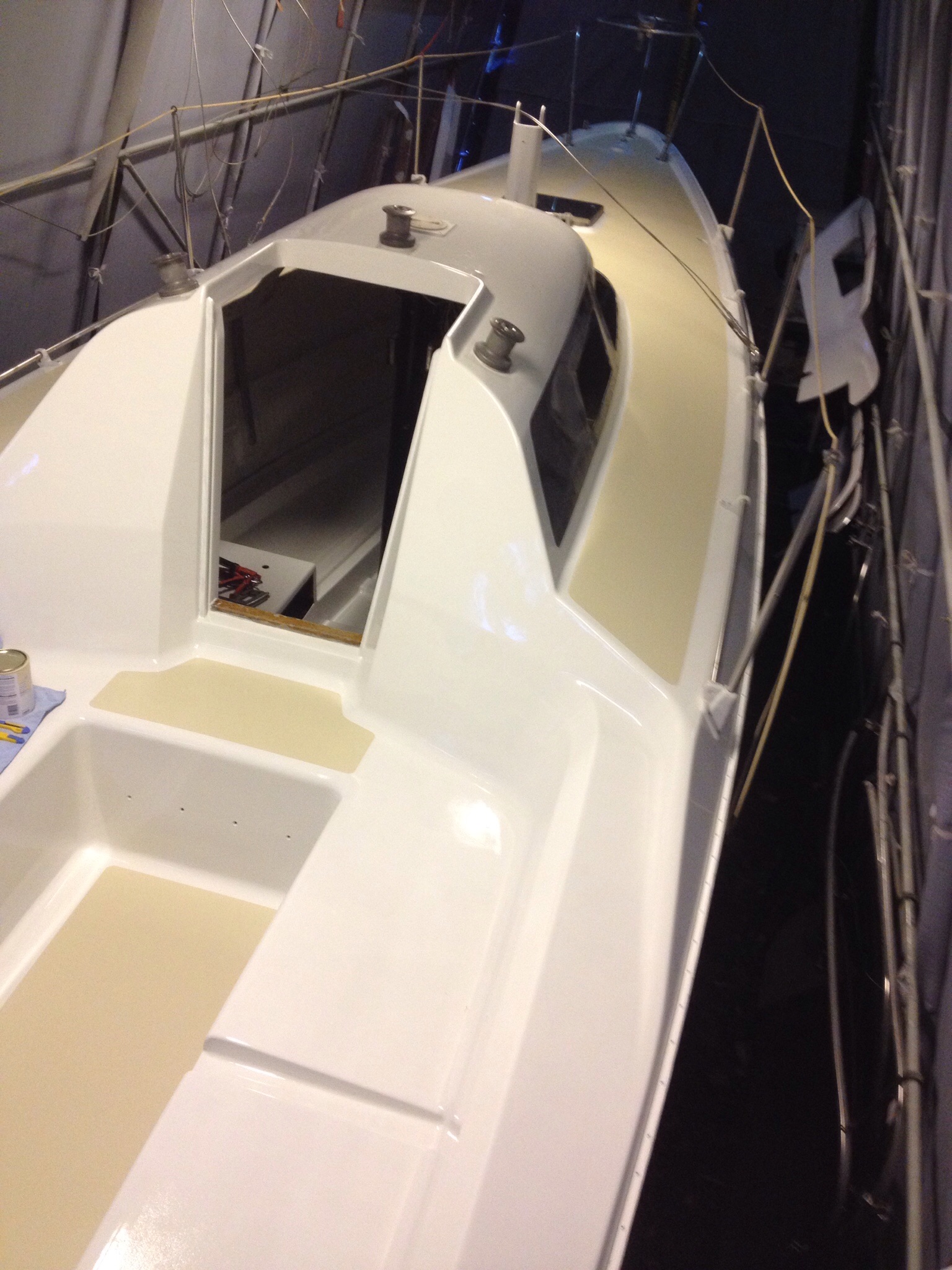

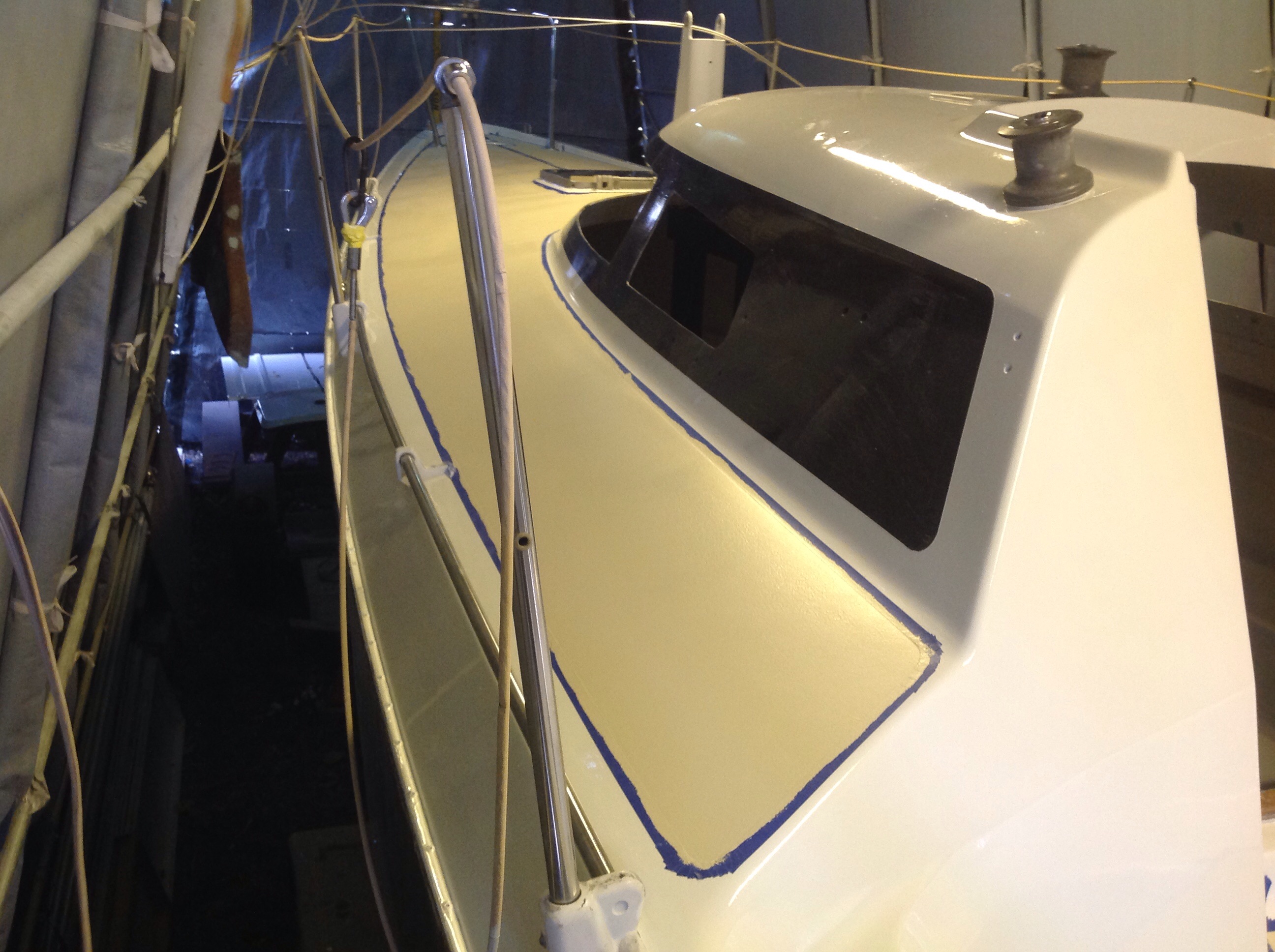

Topside painted with two part polyurethane. Interlux Arctic White.
Beige non-slip Interlux Interdeck.

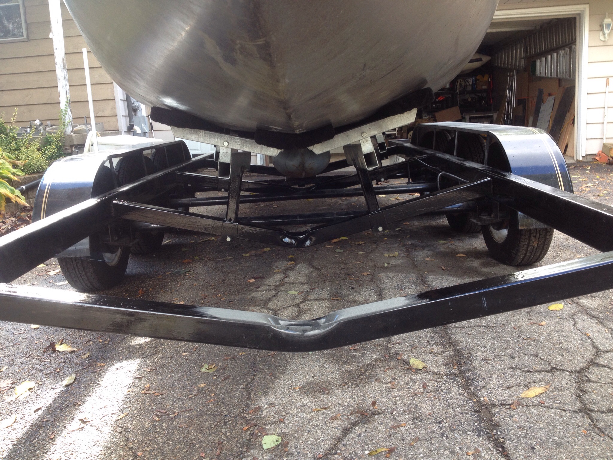

Feb 11, 2012
271

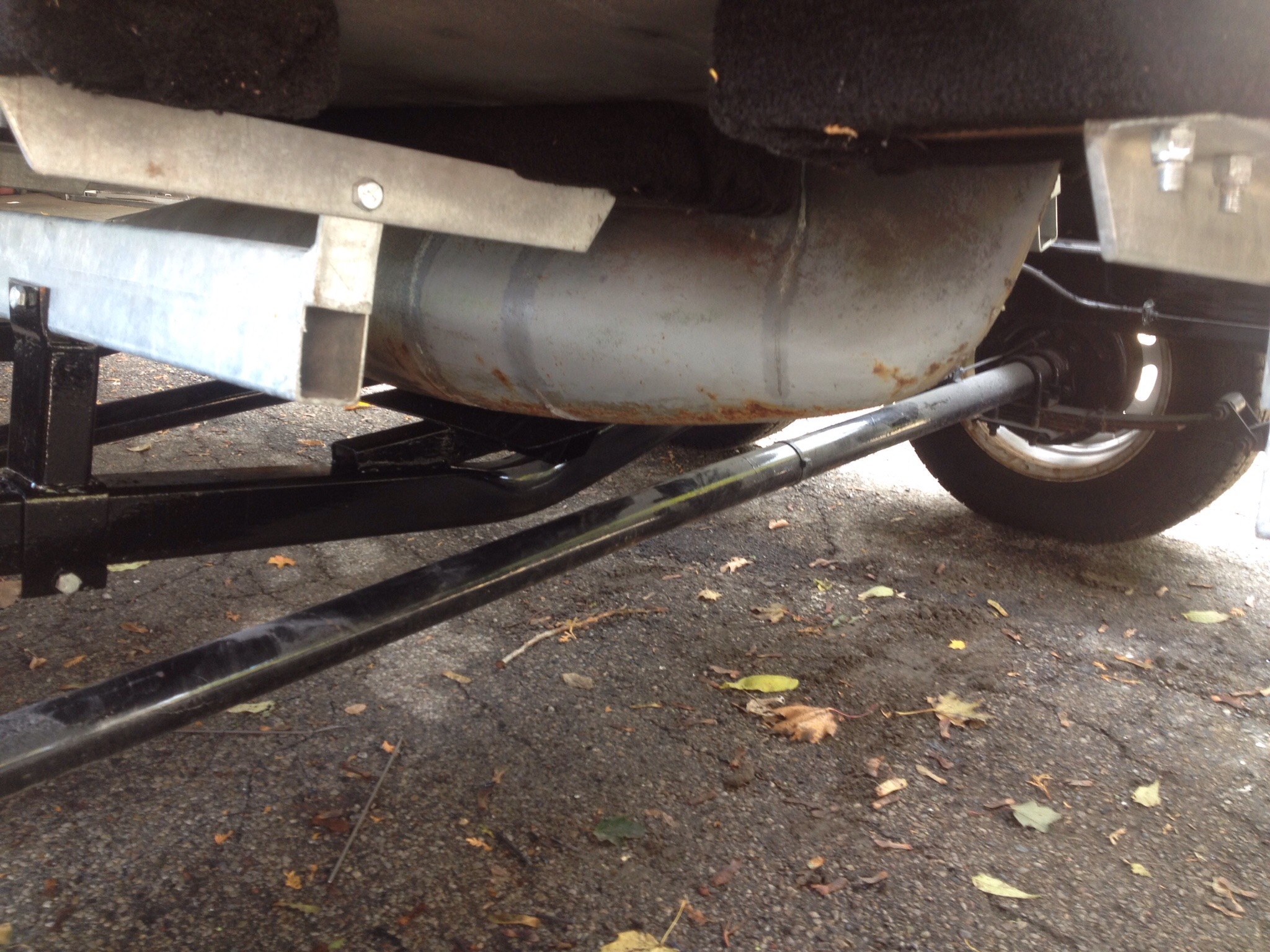

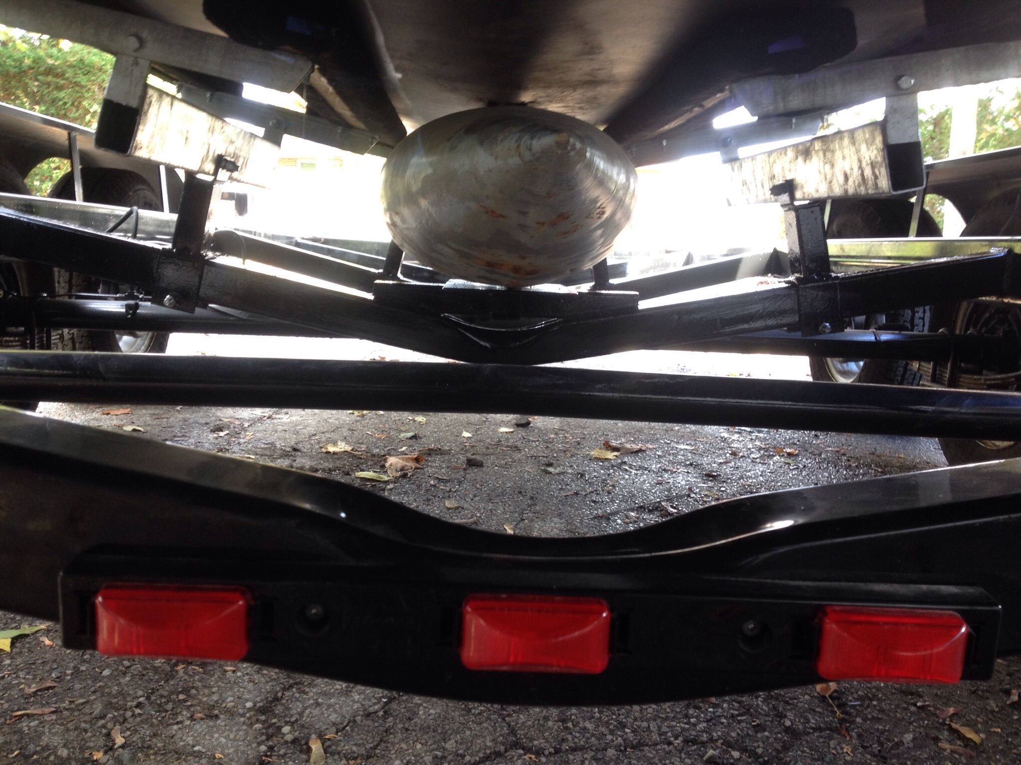

Just finished the trailer bunks, and keel pad.
Had to add another drop down cross member for the forward bunks.
Also wanted to move the boat back 24" from my original design to better balance the weight on the three axles. After doing so, I moved the tower back 24" as well.
By doing this I was then able to have the keel sit perfectly on the keel pad which I welded to my centre crossover.
