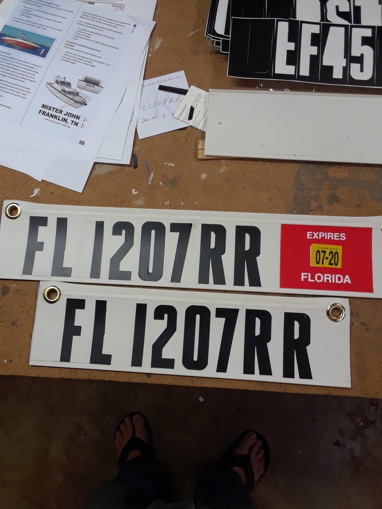

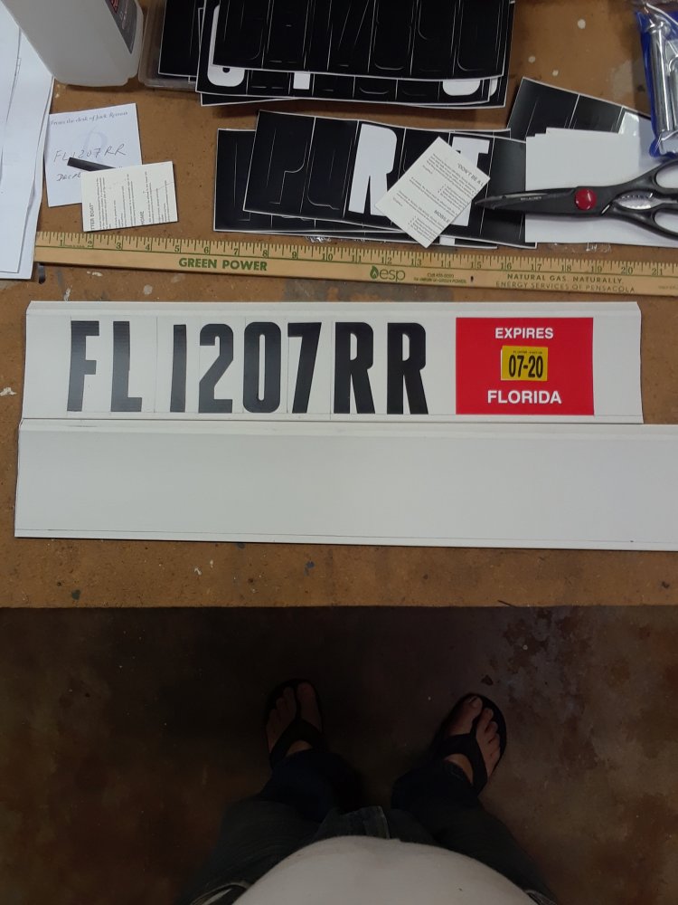

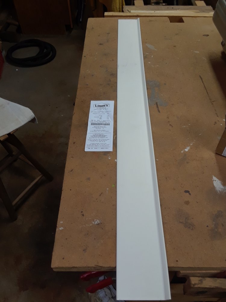

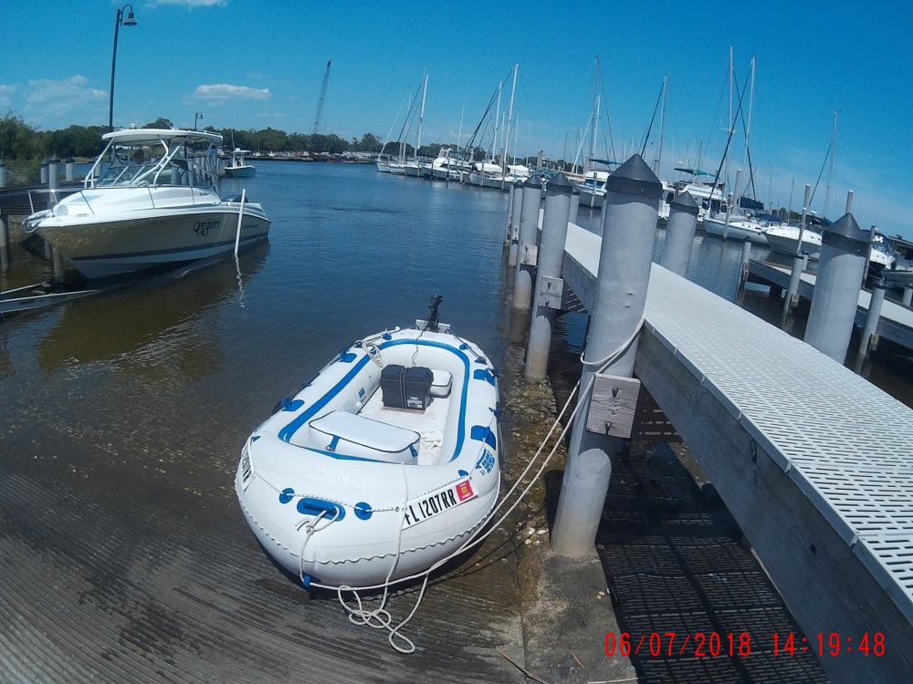

So decided to try a electric trolling motor on my Sea Eagle inflatable dinghy. Weeel in Florida that is a motorboat so I had to go get it registered and titled. Not so fast , had manufacture source document but had to call the company and have them mail me a original bill of sale. Was 499 on line but once got done , cost 72 bucks to title, pay taxes, and register for 2 years. All good right, weeel you got to display the numbers and tax decal on the boat. So repurposed a piece of vinyl wall edging from Lowes. Set me back 2.83 plus tax , but its white vinyl, 1/8 of inch thick and flexible just tall enough to put numbers and tax decal on. Add some grommets to hang it on side ropes with and ta da. Pictures of project posted below.

wow-- well done, and a bit of a PITA for an inflatable. Luckily my new dink from West Marine does not tip the scale at the DOL, so a bit luckier in WA. But-- try and get registration and a plate on an original Trail Rite that was never titled in the state? 2 years and at least 5 physical trips to the DOL later... sheez.

Hey someday I will tell you why my inscribed HIN cannot be added to my title with its invented HIN because the boat was once bought and sold in Alabama which does not issue titles for boats or trailers. Caveat emptor in crimson tide land!

Funny timing! I registered our dink for the first time a year ago, but only last week when I renewed it did I get around to thinking about actually applying numbers and the decal. It's an old Avon, and doesn't have a rope around the bow, so I don't have the option of doing a placard the way you did. That's clearly the best way to go.
I stuck the sticker on the side of the motor - the ONLY place it could possibly be applied. And I'm going to try stenciling the numbers on with spray paint.
Of course, now that I'm TRYING to do the right thing and be as legal as possible, I'll probably attract the attention of the po po and get myself ticketed. :angry:

I have to apply the boat reg numbers with a -1 added to indicate tender of.... looks like I have to figure out the same... hoping for transom.
Ugh... I just told them my trailer was Homebuilt... no hassle...no vin needed... just a bill of sale listing it with the boat.
(good thing. It "looks" professional, but builder plate, if it ever existed, was gone decades ago. I'd hate to deal with getting a VIN etc. like it was a motor vehicle.)
Pleasure craft licence only needed if motor is over 10hp.. so technically our C22 doesn't need it.
I got one anyhow, to make it easier for SAR, and cross border travel... It's Free.. renew every 10 years.

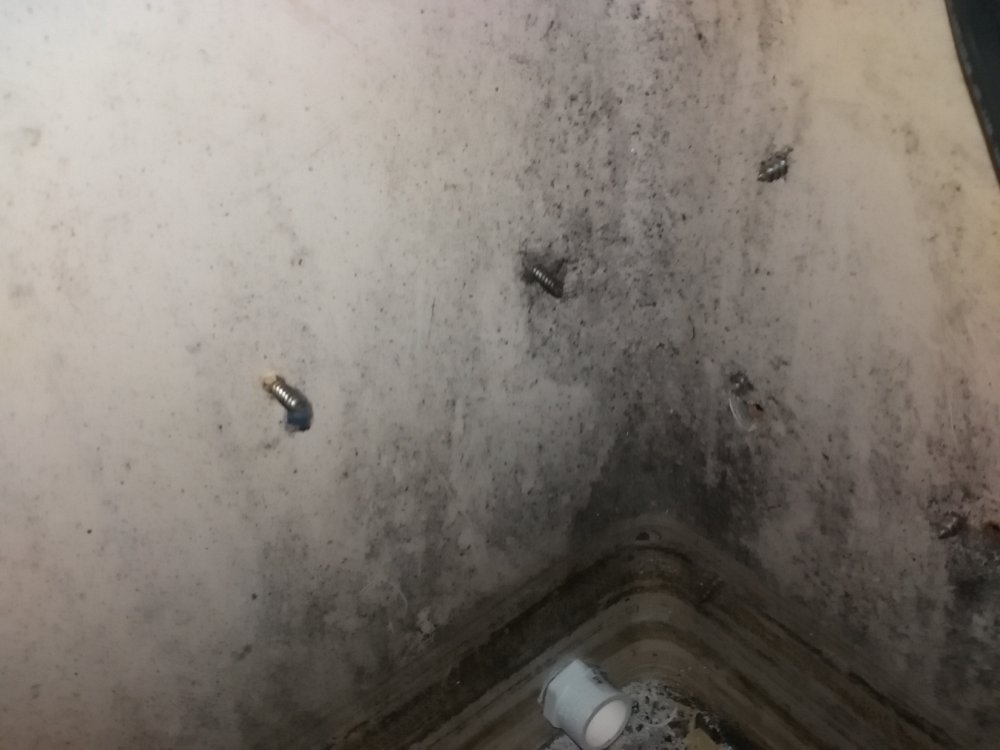

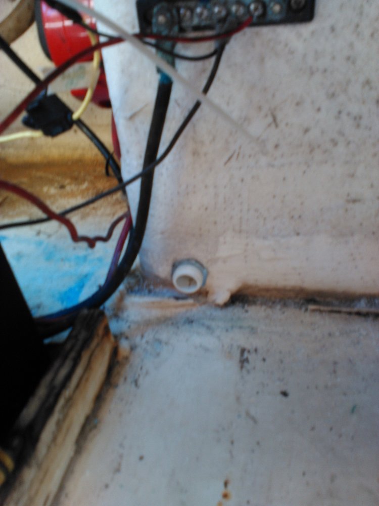

Back a while ago was cleaning out the lined port-side lazarette in my 83 that extends up to back of port-side dinette seat in cabin. I noted a little bit of standing water at the very forward end and a little algae too. I decided it would be nice to have a way to drain the space into the common "bilge" of cat 22 or at least near the battery box and volcano where my bilge pump could remove soapy dirty rinse water too. So I drilled a small hole just big enough for a 3/4" pvc fitting with a screw on cap on it to close it off when not in use. First pic is inside lazarette and second in "bilge" area.

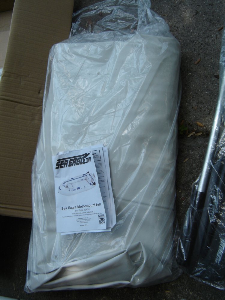

Probably will do ok, only get up to a knot paddling or on trolling motor and maybe 5+ towing it under sail or power. Otherwise in bag deflated along with dinghy.
