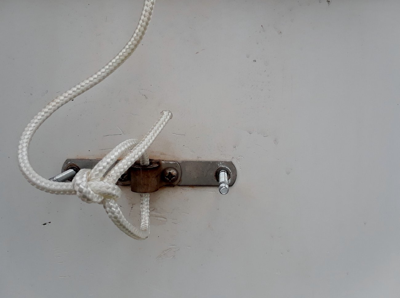

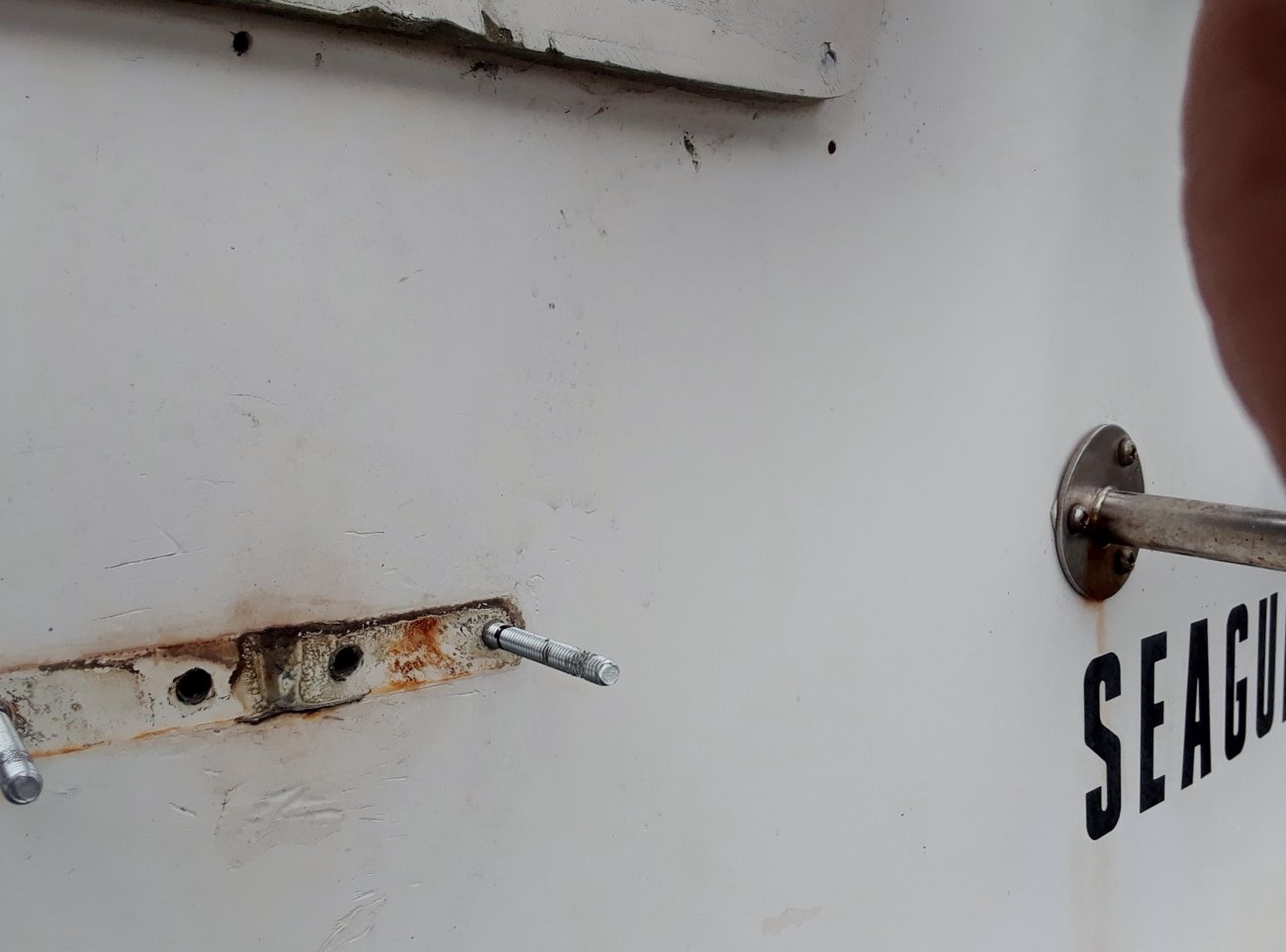

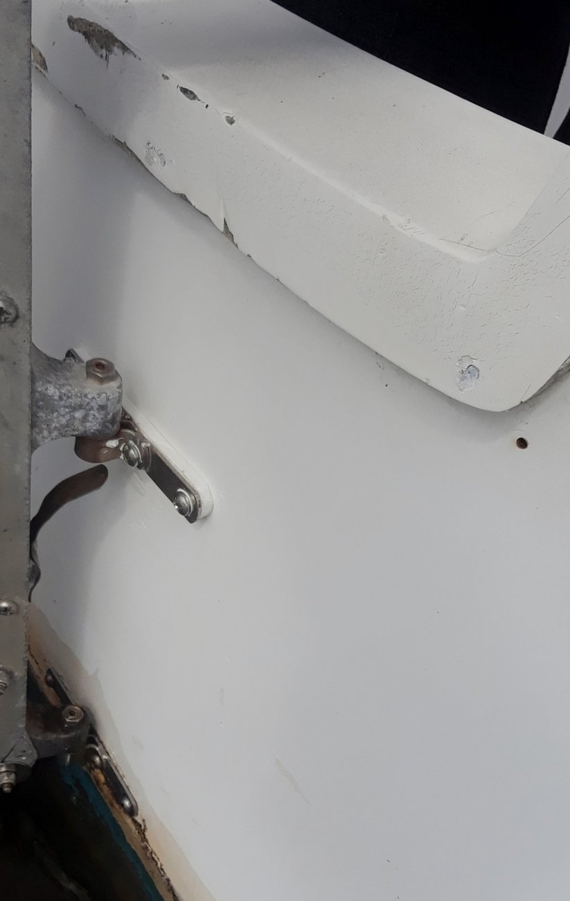

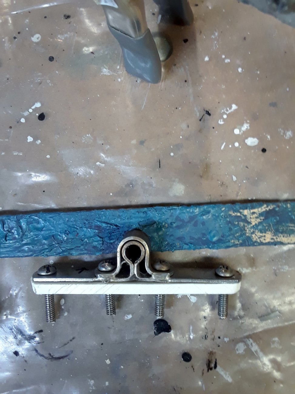

Just did the spacer trick on the upper gudgeon of my rudder. Used two threaded 1/4 rods to replace outer machine screws then took out center ones and slipped the gudgeon off. Made a 1/4 thick spacer from Starboard and reversed the procedure using 1 1/4 screws to replace the original 1 inchers before the spacer. Last pix is of retainer rope to avoid sacrifices to Neptune of original equipment items!

Jacktar,
I haven't read anything about the "spacer trick". What is advantage do you hope to gain?
Sep 14, 2014
1,286
Catalina 22 Pensacola, Florida
Apparently racers of cat 22s have put the spacer in to move the leading edge of the rudder a little more forward, it is supposed to help with the tendency to turn to windward when you let the tiller loose. I single hand and use a tiller tamer but even when sails set right and tied off the boat will go to windward if not watched. Check out the catalina 22 forum for earlier posts by others and it even shows up on national org under their technical references section.

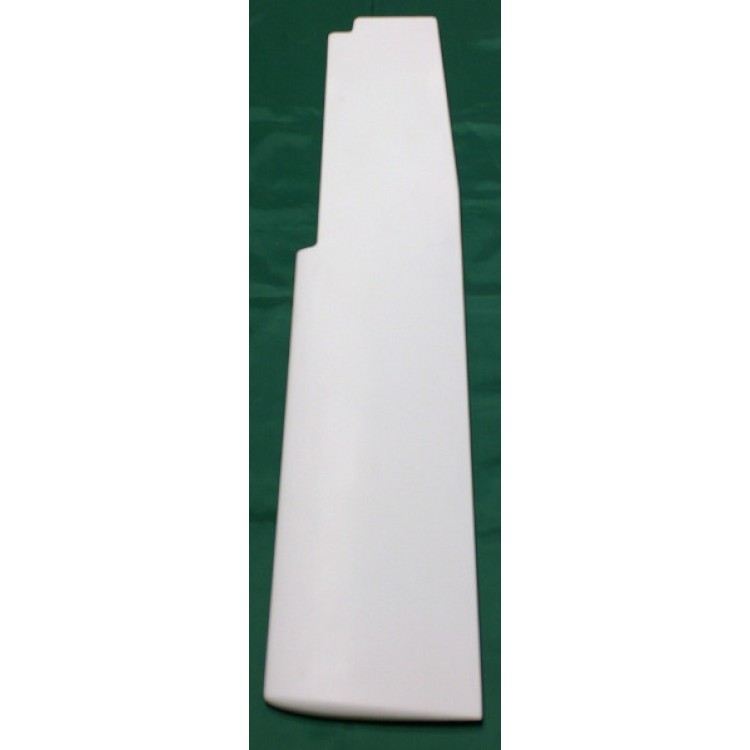

I was unaware of the spacer trick, but what you say makes sense. Look at the Ruddercraft blade, how the leading edge (left side, in the pic) is moved forward. The entire "wing" is moved forward, actually, just like the spacer trick is doing for your rudder. And the Ruddercraft blade DOES reduce weather helm, I can attest to that much. So I'm a believer in your spacer trick.

Well I took the boat out on Thursday last and tacked back and forth on several reaches and even downwind and the spacer really appears to make a difference. I single-hand so will tighten the Davis tiller tamer and run forward or below to do something and by the time I get back the boat has usually gone to windward no matter how well the sails are set for balancing the helm. This time it stayed pretty much on course even while I went forward to bow pulpit! I am amazed how much that 1/4 inch affected the helm. More trials to come but I am a believer.

Any idea how much the 1/4" spacer moved the leading edge forward? 1.5" maybe? Good trick to know-
Sep 14, 2014
1,286
Grotto, it was the racing folks on catalina 22 national org that posted the fix originally.

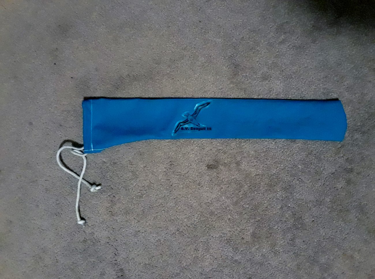

Well spent 4 weeks out of town away from the boat closing down my Dad's house to put up for sail. But finally got caught up and noticed my motor tiller handle cover was in bad shape. so out with the canvas and sewing machine and Voila (french for so there!) a new cover is done. Monogrammed of course.

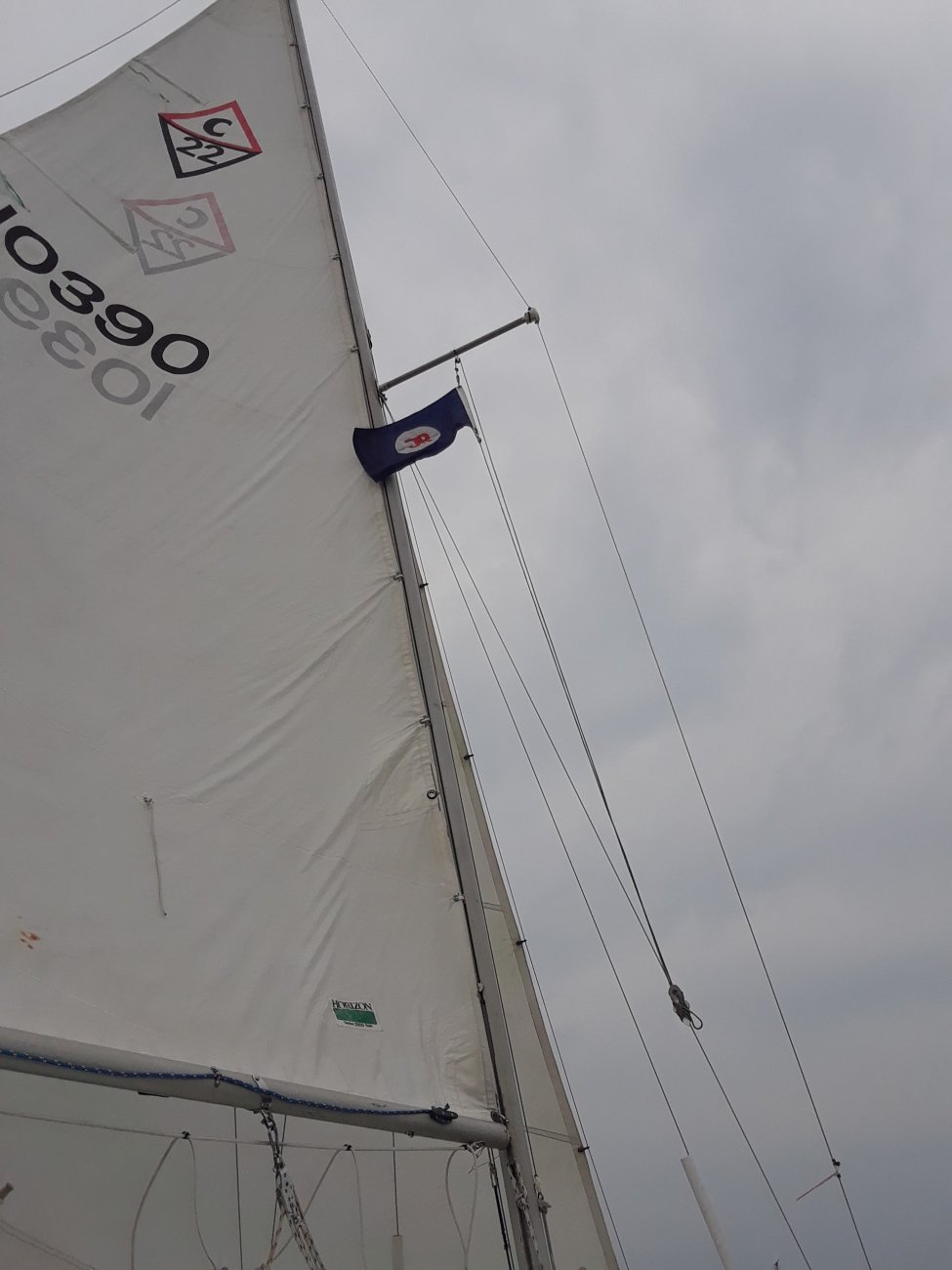

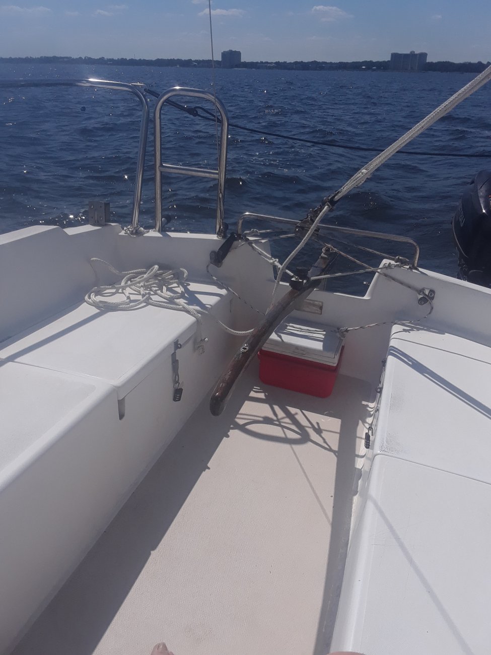

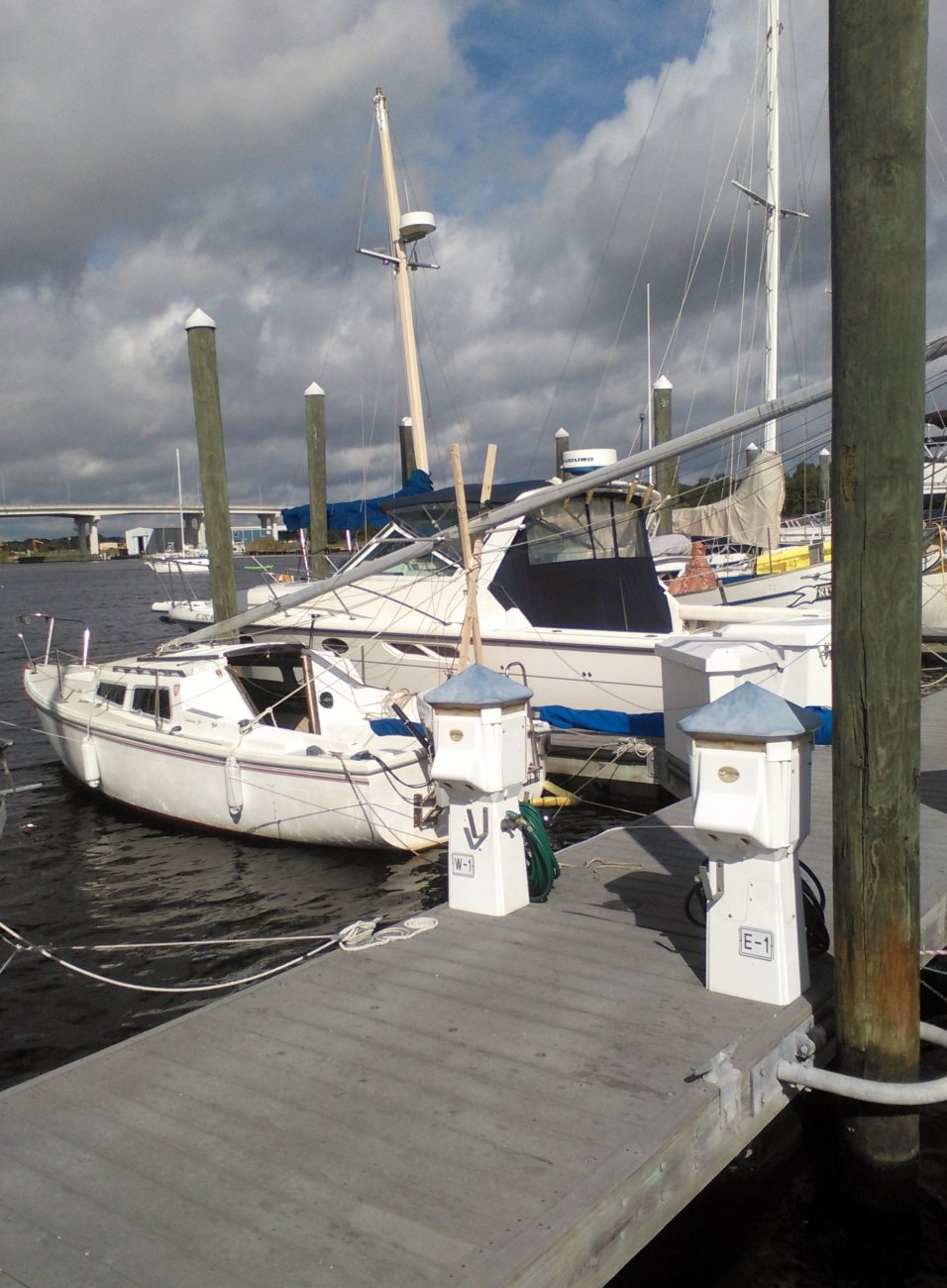

BTW lowering the mast at the dock can be done relatively easy by one person, of course turning it from bow in to stern in and putting up a temporary shears helps a lot. Look at the pix, had to lower to rig up a starboard spreader block for flag halyard. Worked out good.
