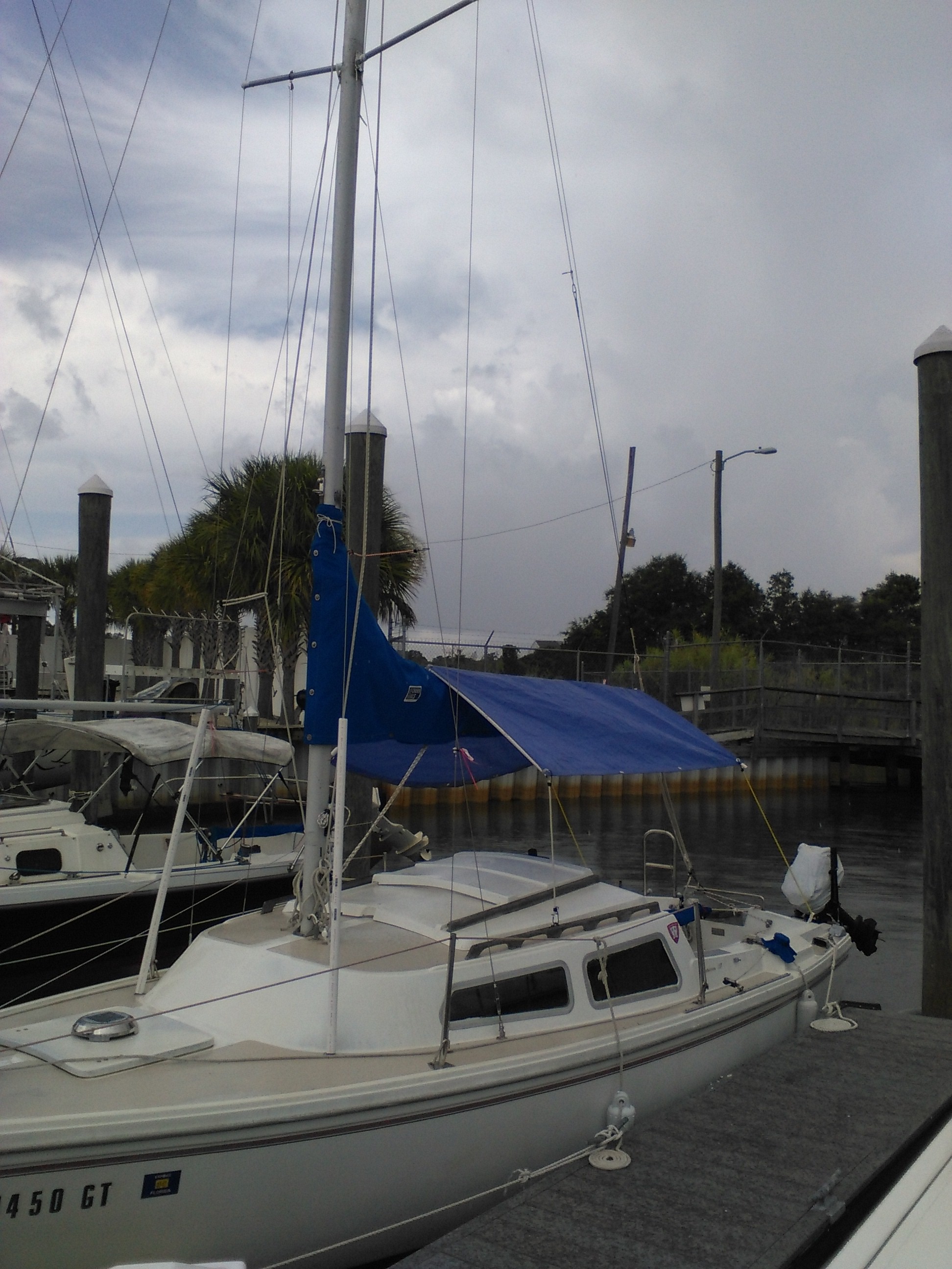

On another note, I decided to make a cheap sunshade for the cockpit when anchored as I do not have a bimini. Free tarp on coupon from harbor freight and about 5 bucks of elbows and couple of pieces of 1/2 inch PVC and voila. Each arm down to side has union fitting with no glue so can collapse the thing and roll it up. Details on request.

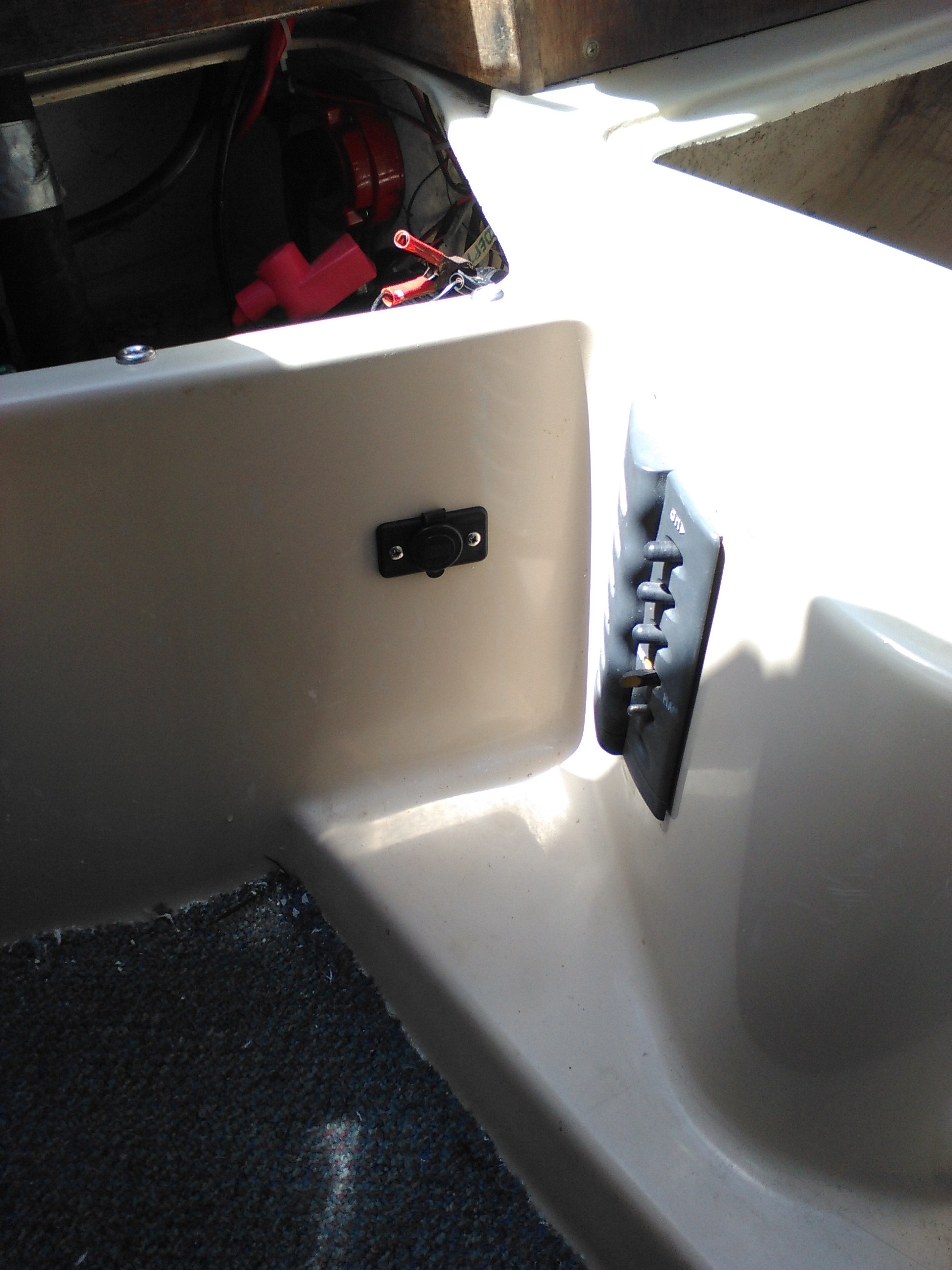

After I rehabilitated the original switch panel and removed the wire nut and bolt ground wire connectors I decided to add a 12 volt outlet to near the panel so I could charge phones, rechargeable blue tooth speakers etc. while underway with motor and alternator putting out (free) power anyway. So there is it is.

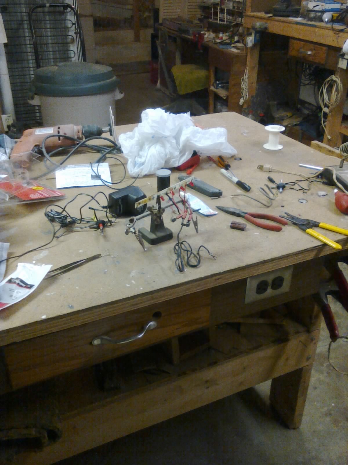

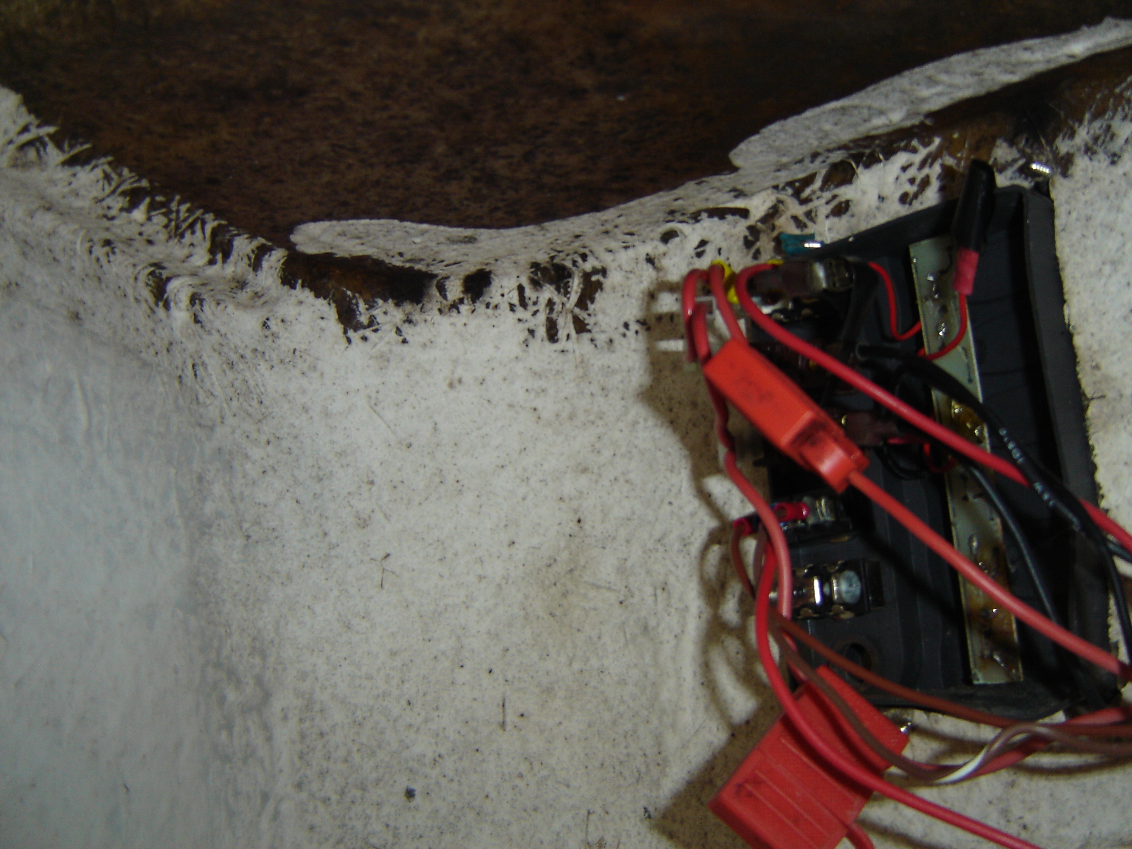

It is catalina original as far as I know, left there by PO but looked pretty radical from the back, had to do some soldering and install a led to get the indicator lites working

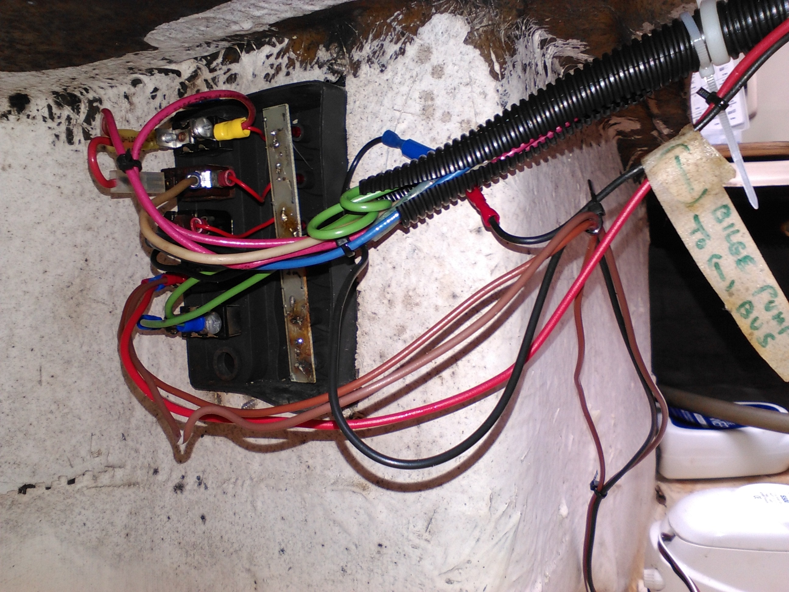

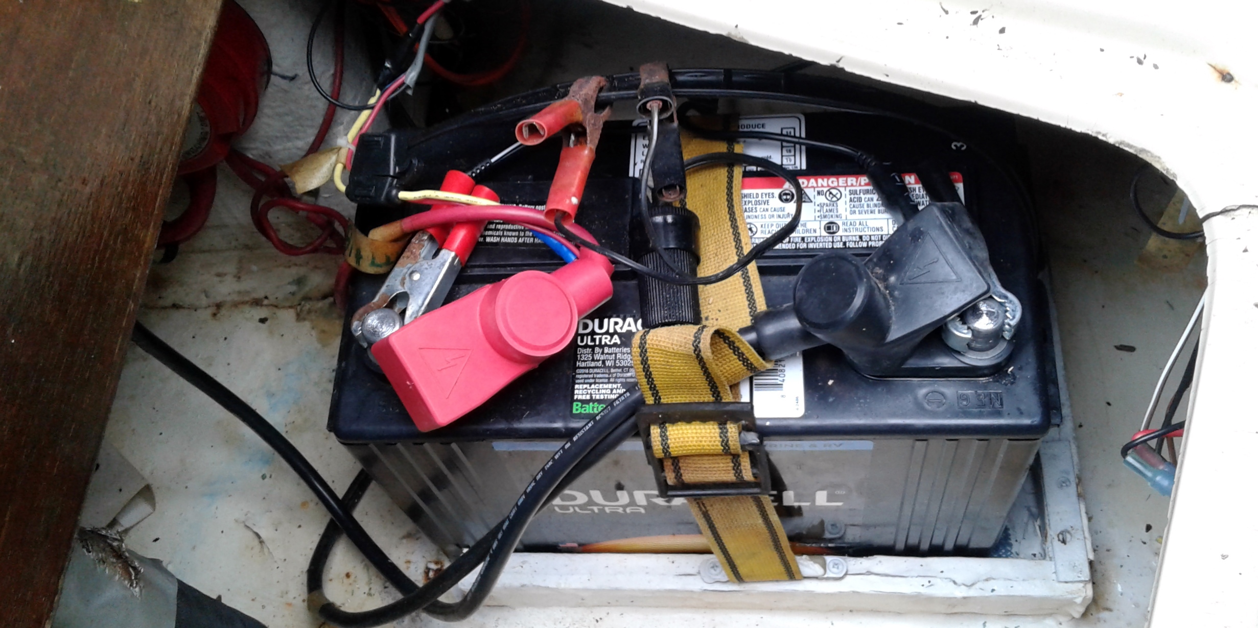

But the backside looks much better now since the rewire of the panel All but direct to bilge pump and to 12 outlet around corner now in a wire enclosure on their way to the buss bars on the forward face of the bulkhead below the port aft dinette seat near the battery box location on the port side of the volcano.
Likes: Sacto Dave

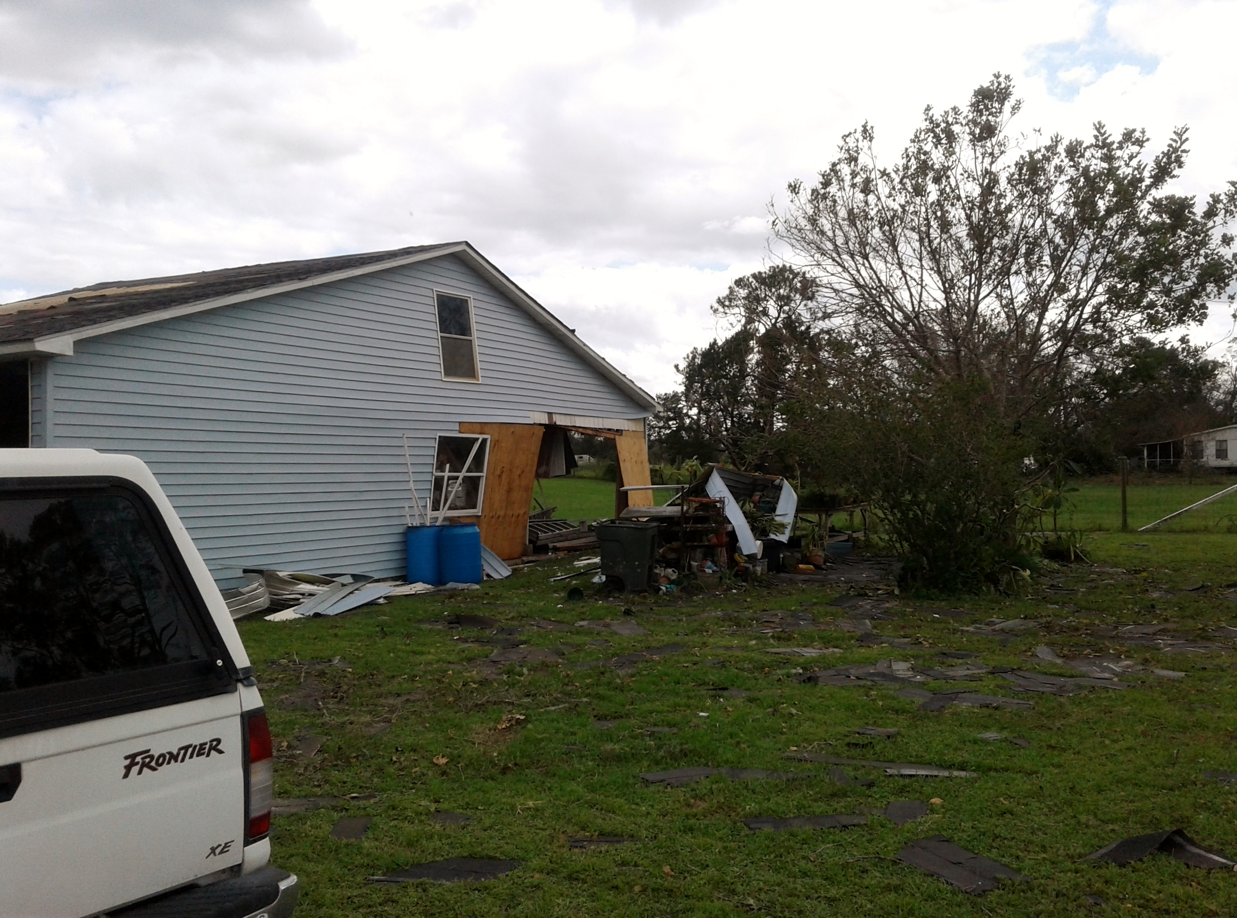

Well I meant to do as promised but a lady named Irma came to visit my sisters place in LaBelle florida so I had to divert for a couple of weeks to reduce some clutter on her shop roof and barn wall. Back to boating soon.

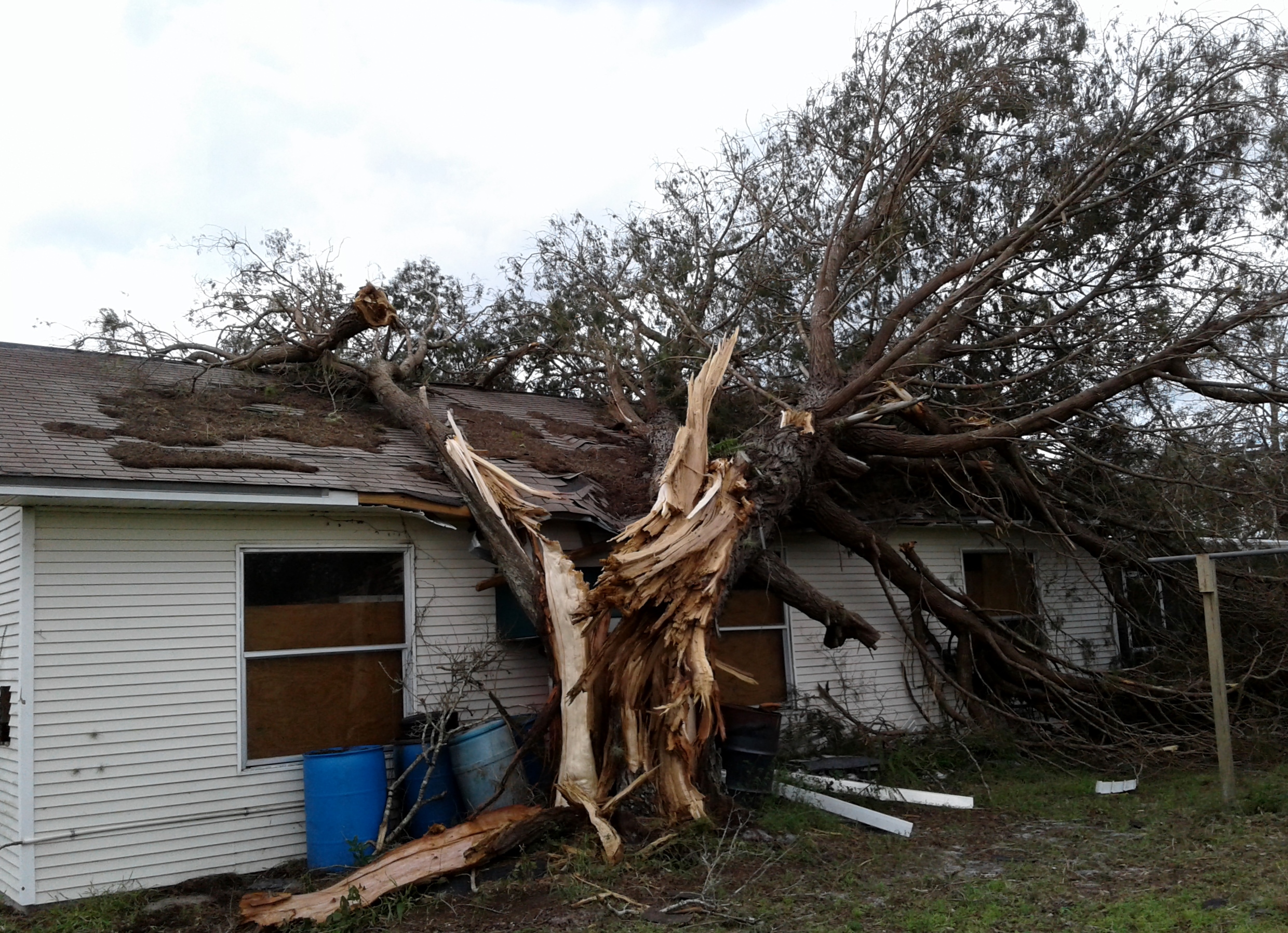

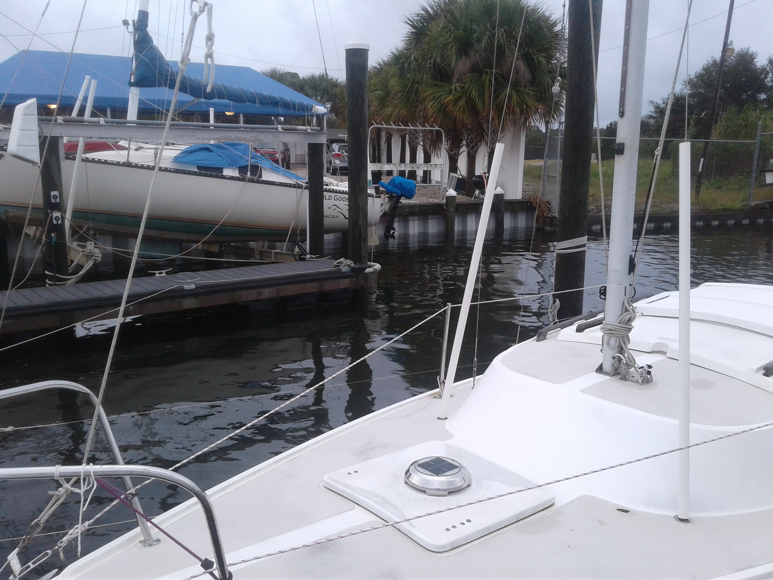

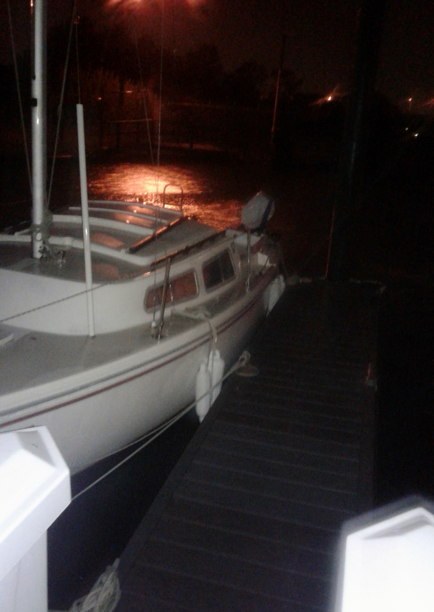

Well now a guy named Nate came to visit so again a little time out, stripped boat of jib and boom and put in cabin and double lines and double fenders for the expected up to 4 foot storm surge and at least tropical storm force winds over saturday night. before and after pix plus one of seawall near overlapping still next morning.

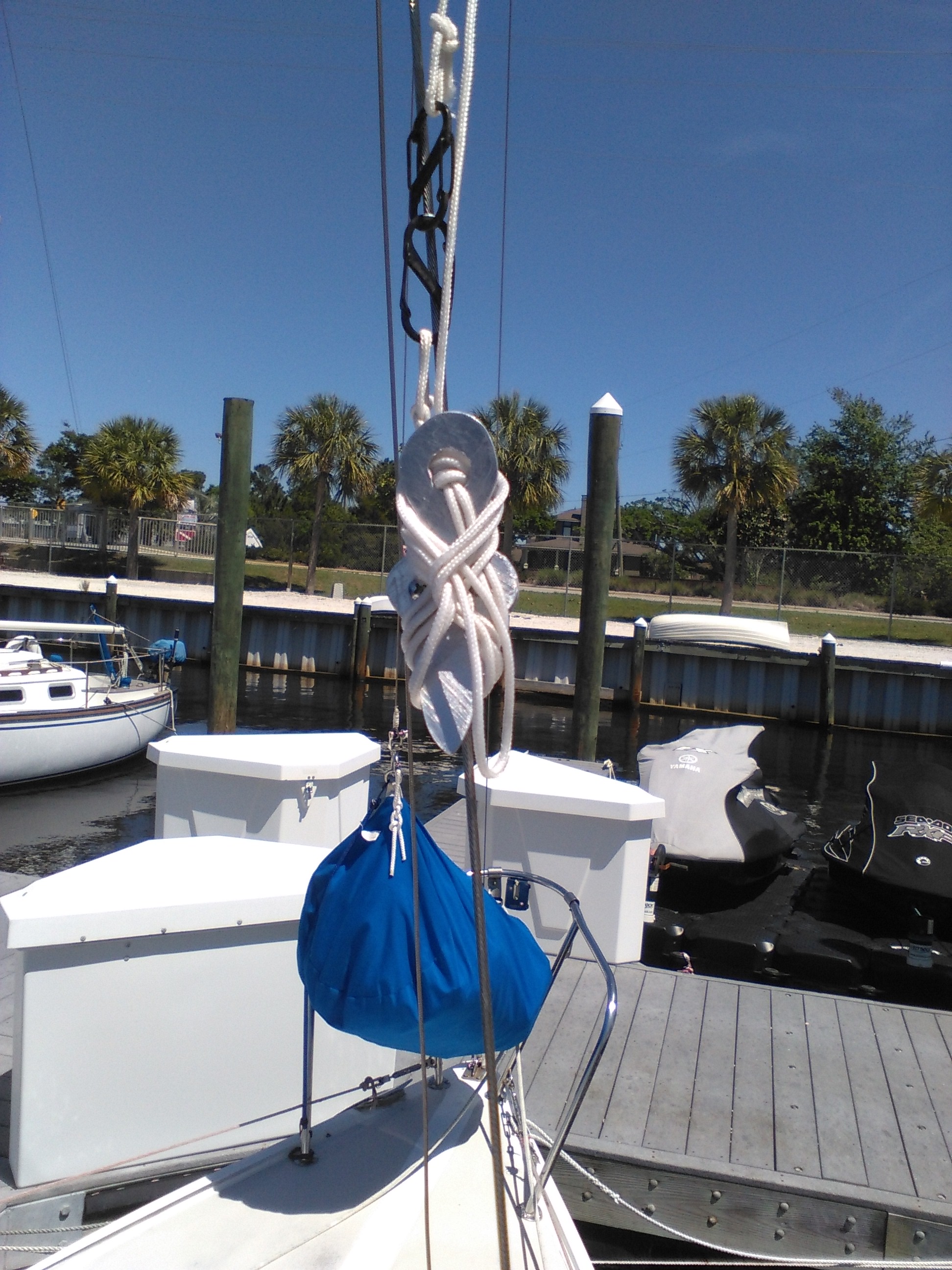

Okay here is posting of first detailed project with narrative and photo series. The Title? Shroud Cleat Project ----teaser photo

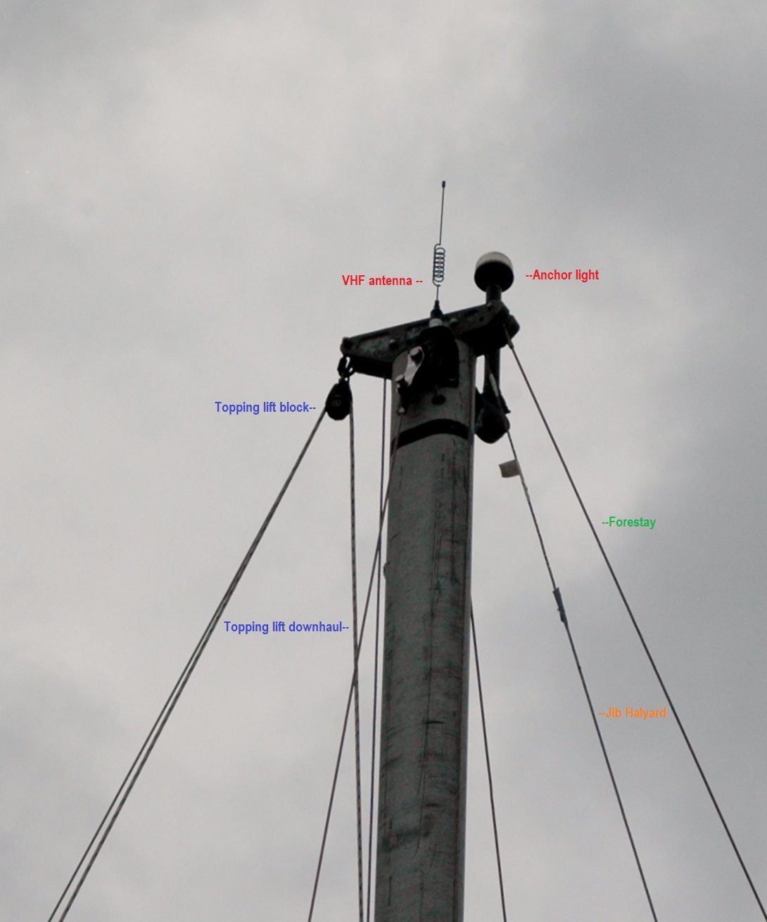

Another short update, been many a post about typical masthead configurations so I am posting a labeled photo of mine . If you can't figure something out just comment on the companion post under Masthead view. masthead stbd annotated.jpg
