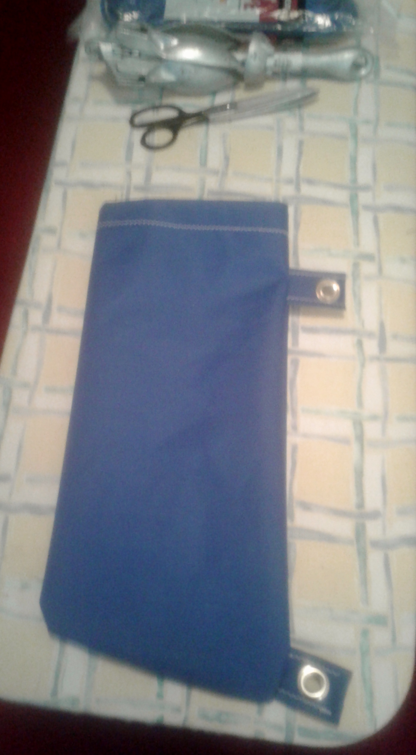

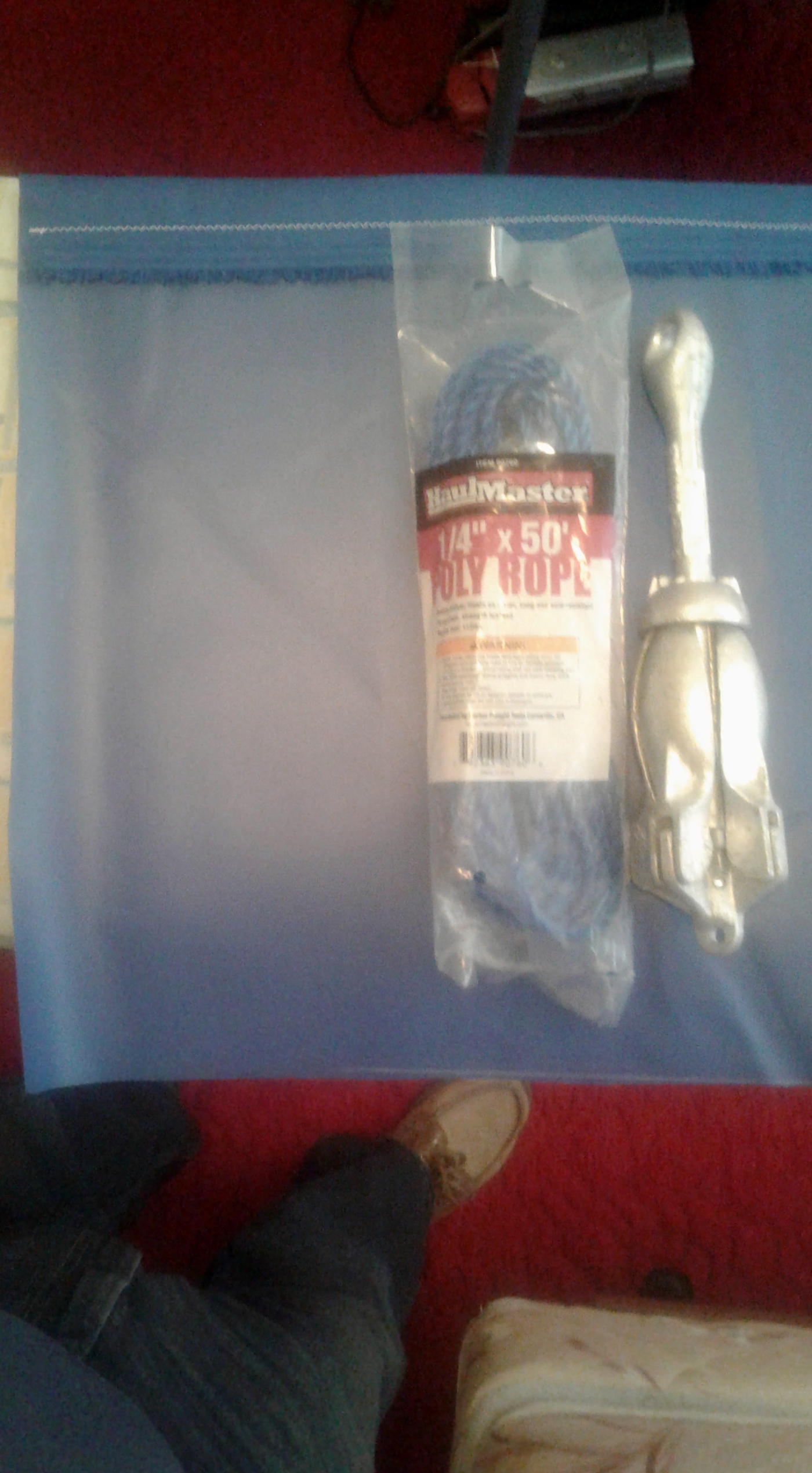

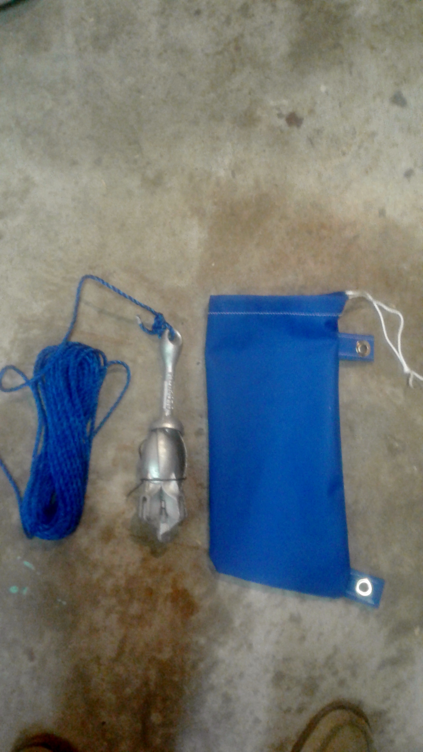

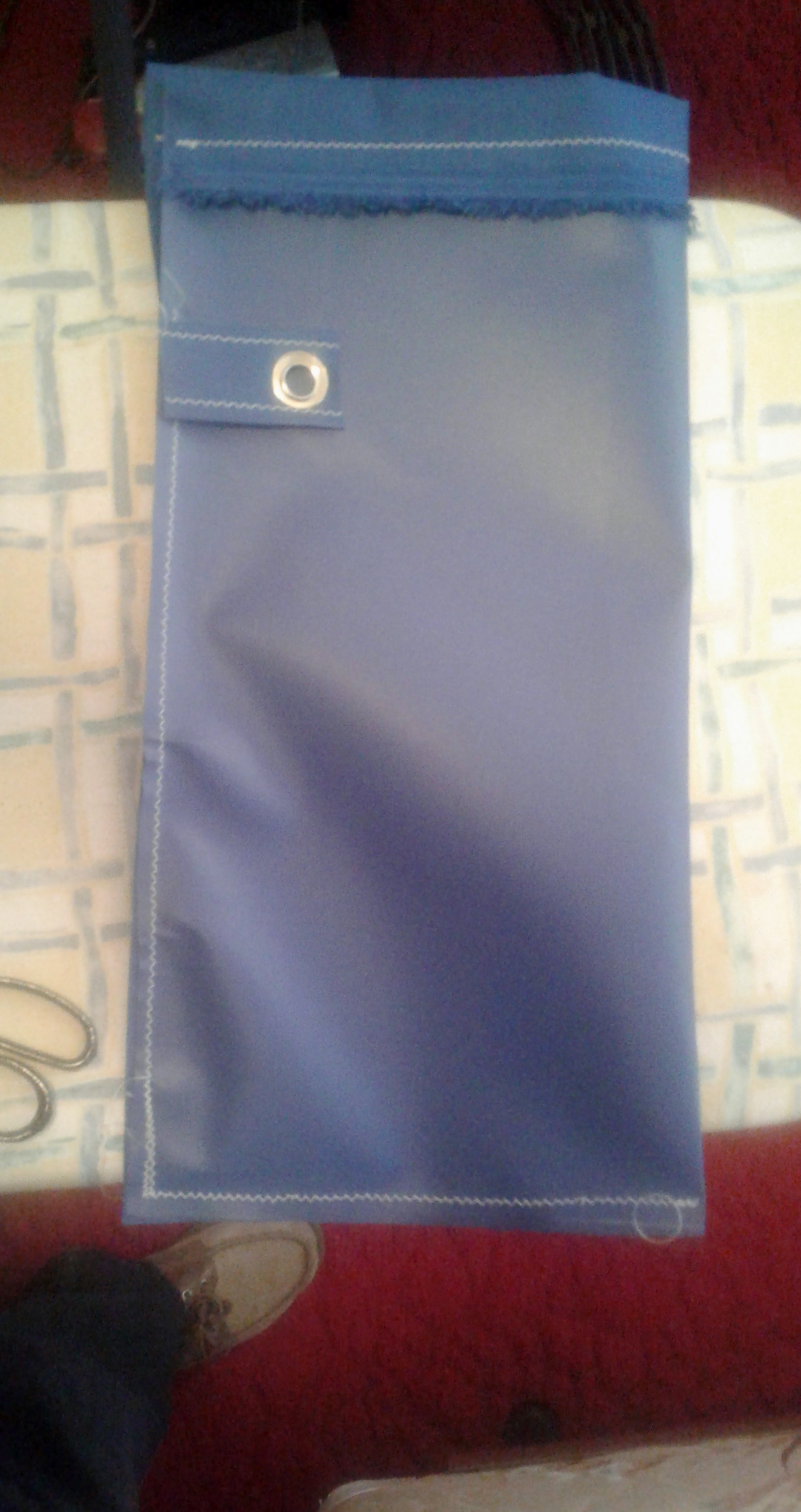

Also I got bored over a rainy weekend and decided to buy a folding grapnel anchor for the dinghy and then had to make a bag for it that I could attach to the dinghy side ropes and not loose in transit, results below

I'm diggin on that little bag. Very clever!
I need to get a sewing machine and learn how to use it.

You should splice that three strand line onto the anchor with a galvanized thimble. The splice will prevent the knot from getting hung up on stuff and the thimble will prevent chafe on the eye of the line. A three strand splice is fairly easy and you don't really need Fids to accomplish it, a ball point pen will suffice.

Yep its one of those carry on board little projects that I do when I anchor out early and have spare time and daylight.

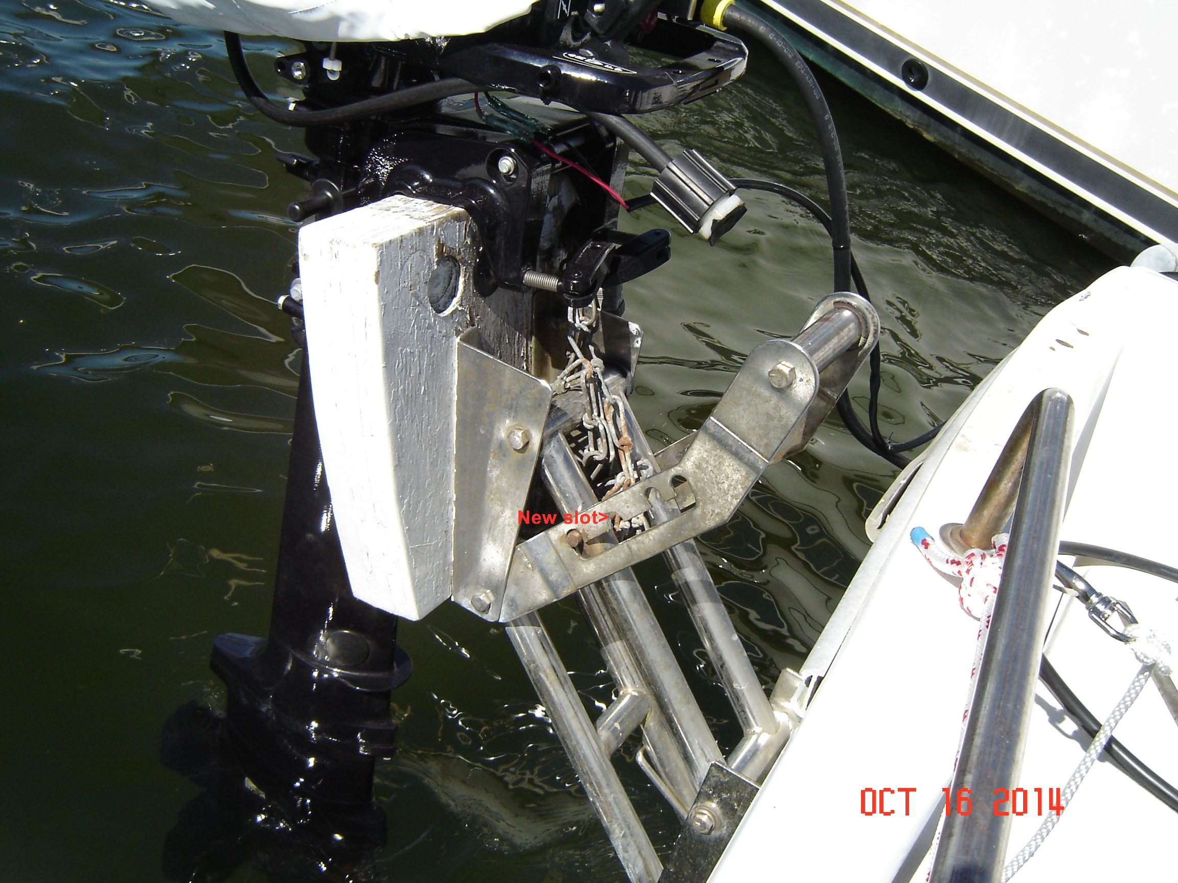

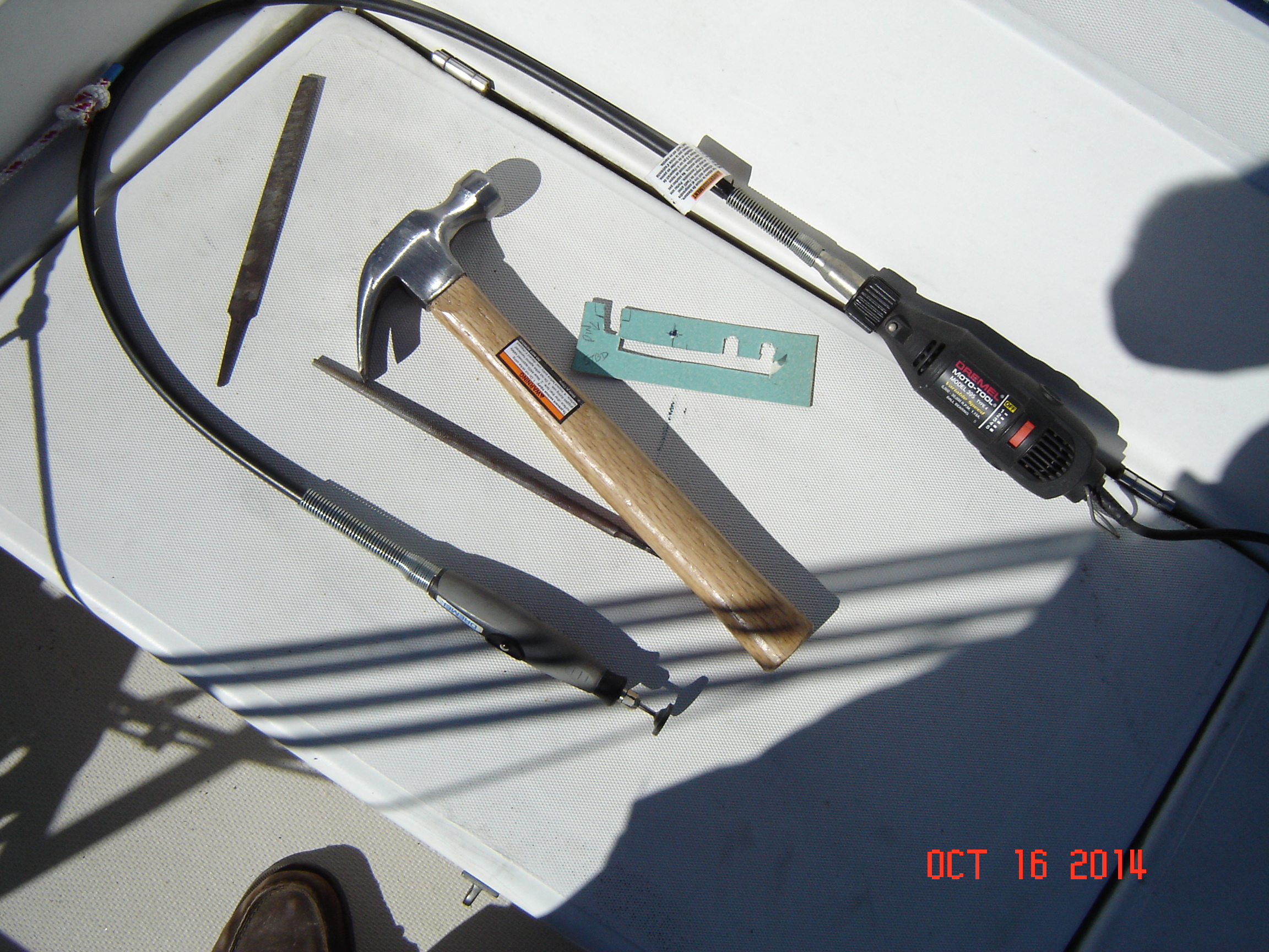

One handy mod although time consuming cutting through stainless was to put an intermediate stop in the motor mount lowering gear to put the motor low but not dunk the motor board itself. So I added a notch by drilling a hole after making cardboard template and rounding it out with a file and dremel.

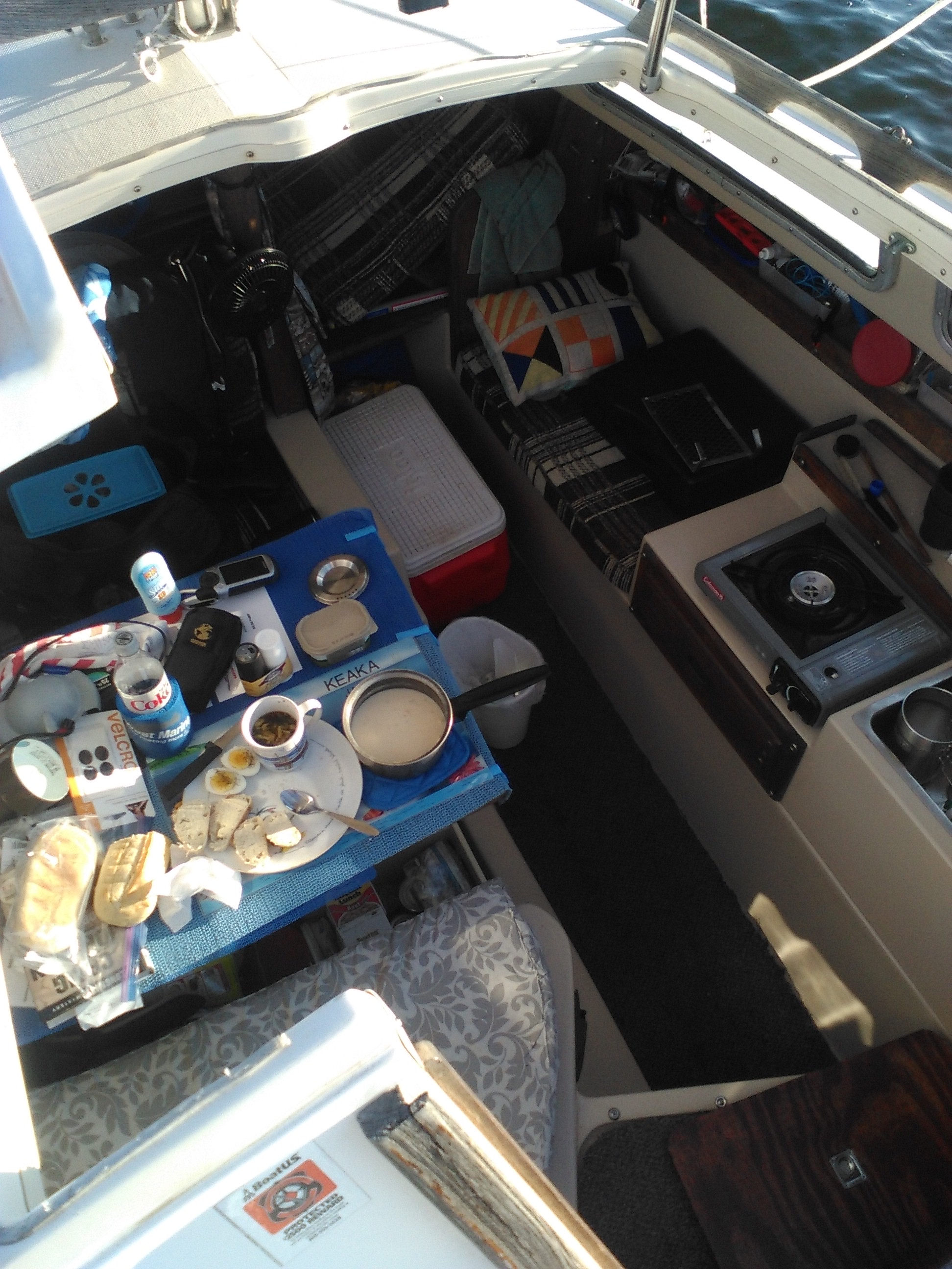

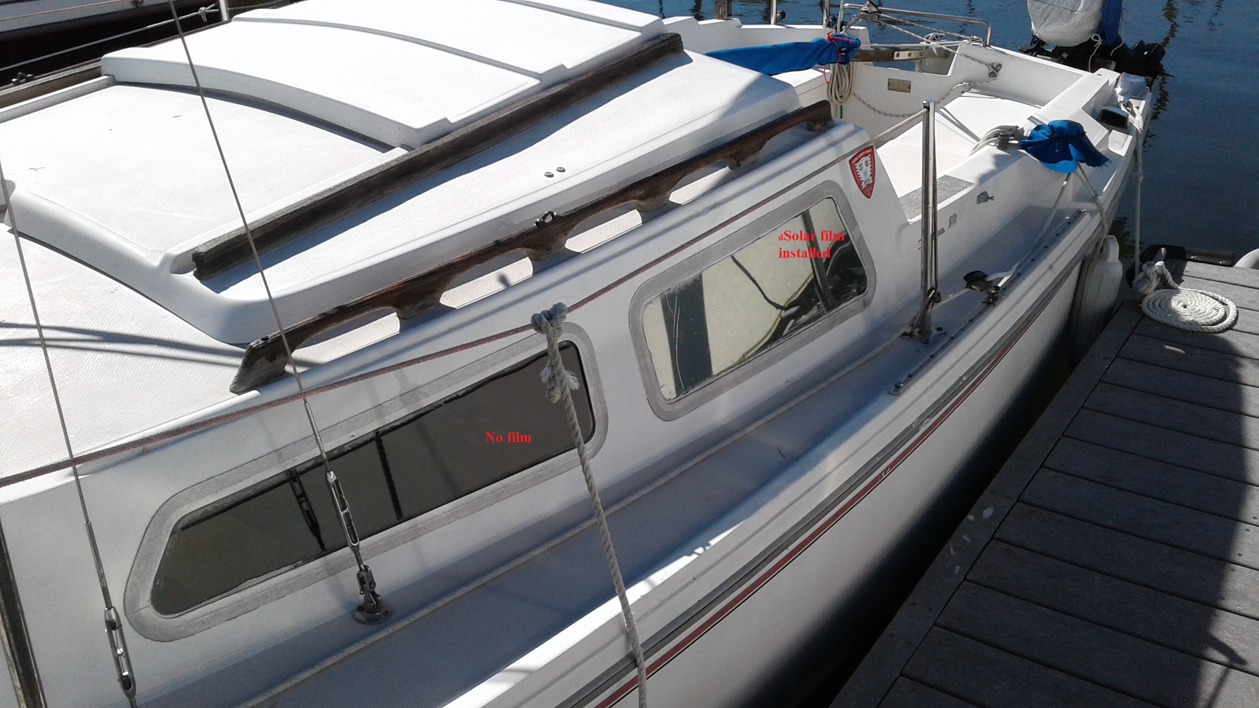

A little project while noodling around on the boat between sailings! Reduce the glare and heat in the cabin during hot bright summer days with solar film inside cabin windows. You can see the difference in two windows in the annotated pic

....where's the rum?!!

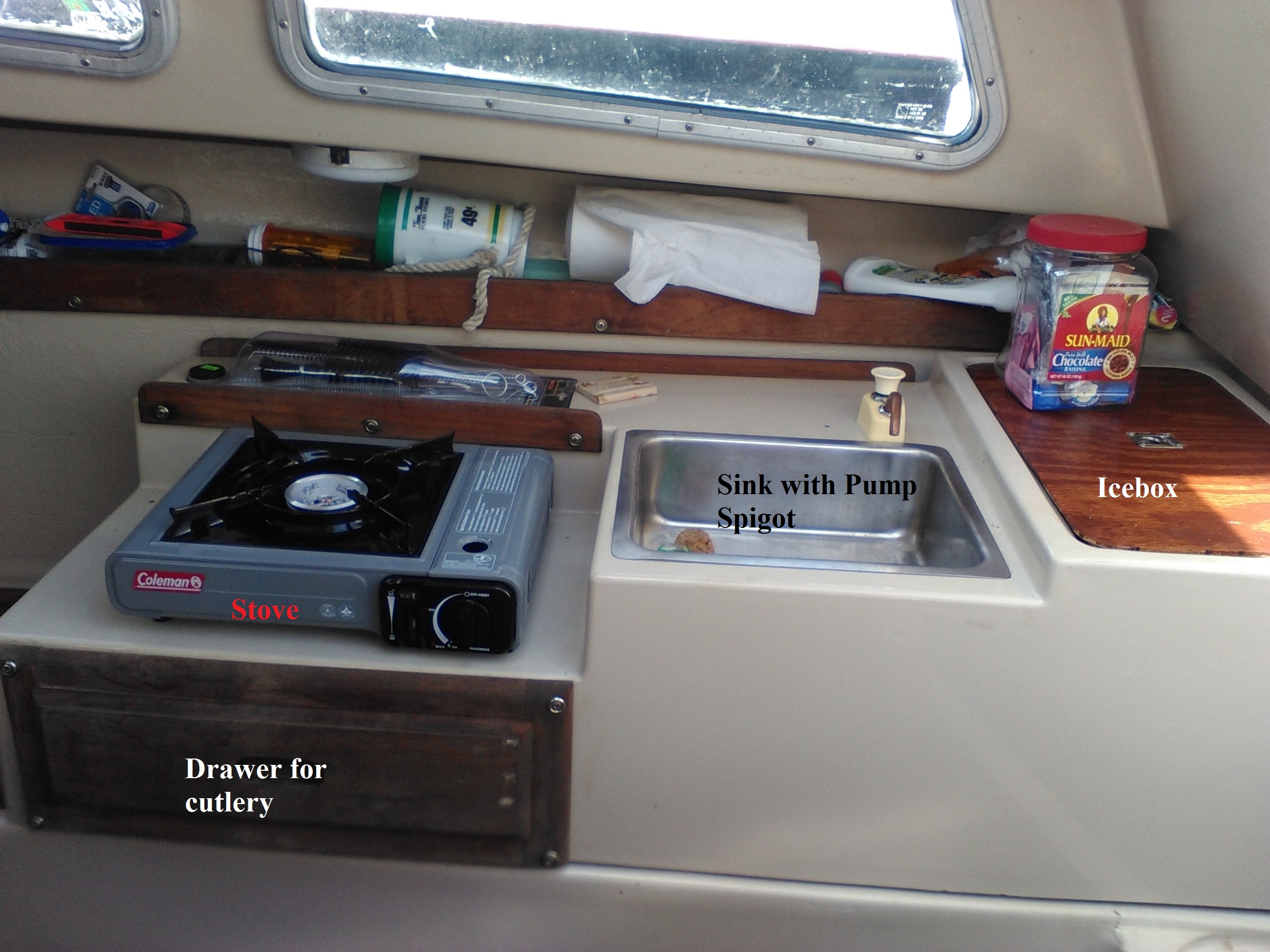

...lookin good Jacktar....question what do you use for water tank to that sink pump? I need to find something suitable...
Sep 14, 2014
1,297
Catalina 22 Pensacola, Florida

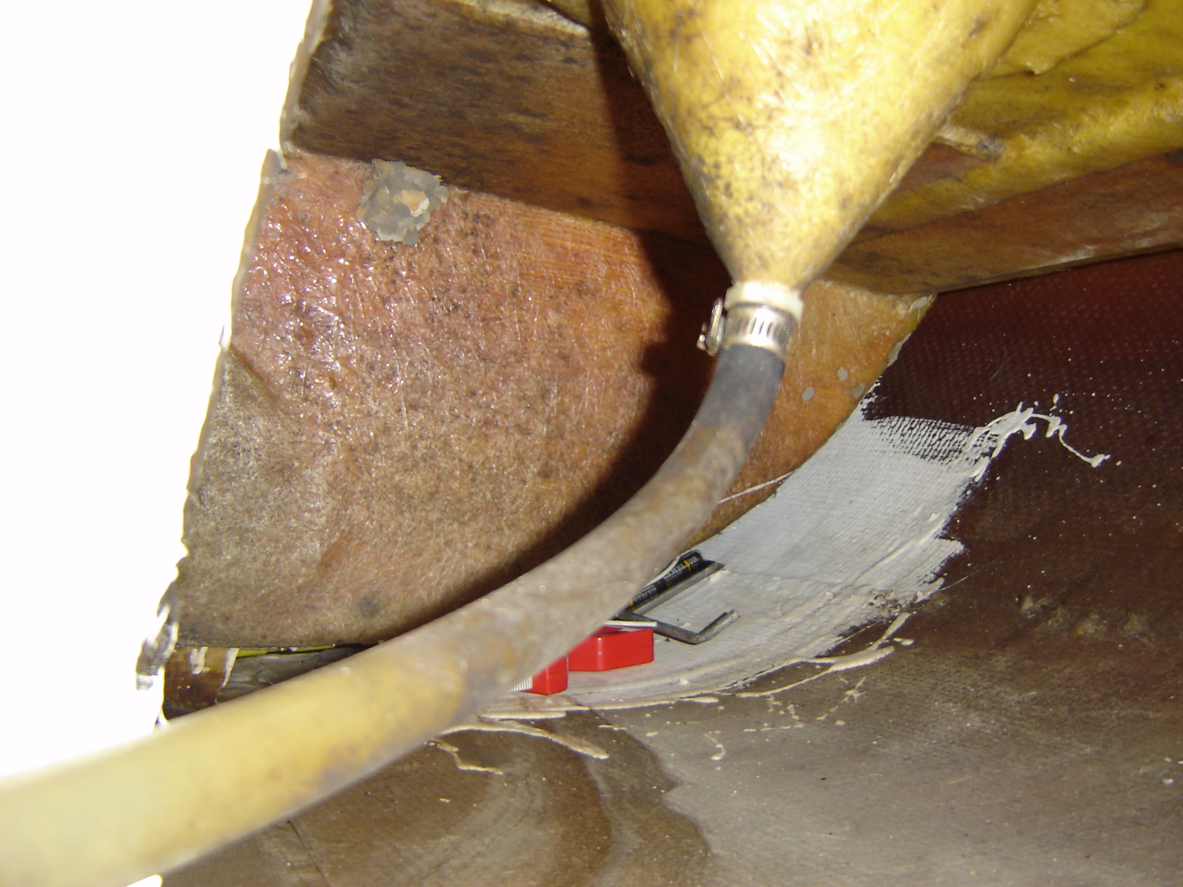

The water tank is built in to the galley itself. It is located along the back of the galley behind the stove area, connects to pump with a plastic tube. Sink emptys through a tube that goes to the funnel and connection to cockpit scuppers under the galley location in the settee. PS rum is well hidden but accessible by captain as needed. See nook and cranny pix below
May 23, 2016
1,024
Catalina 22 #12502 BSC
Good, often wondered how that sliding factory sliding galley drained. I have the funnel on my 84, no factory galley, installed one forward (in another post), drain t'd to forward scuppers as your is, need to pick up a water tank/bladder of some sort to hook up in bow...thx for the pic....

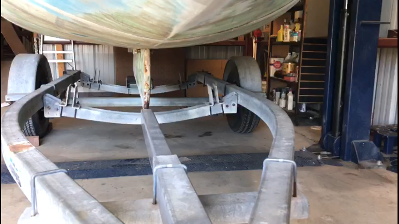

I'm lucky enough to have a vehicle lift in my shop. Works great. Doesn't get high enough to let the keel all the way down but good enough.
It lifts about a foot higher than that. I was rebuilding my trailer in that pic. Had rollers and I put bunks on it.
