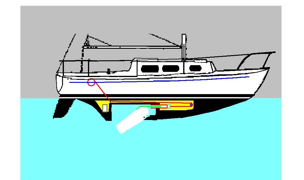

The boat is a 1969 Morgan 22 with a retractable centerboard. Towards the end of the season, when trying to leave the dock, I ran aground with the centerboard down.
Foolishly, I tried to raise it using the lifting mechanism. It was a soft grounding and the boat was still able to move forward a bit (the direction the CB hinges) so I thought it would go up with some help. Instead the mechanism broke (where the cable connected to the cb) and the lifting cable launched into the bilge through the stuffing box. This caused water to come into the boat at an alarming rate. Luckily we were able to get the boat out of the water and onto the trailer where it sits today.
Now I need to decide on how to go about the repair. The way I see it there are 2 options.
1. The proper way: Reattach the lifting cable, rebuild the stuffing box
Pros- Proper repair, full functionality.
Cons- COST - We would need to move the boat off the trailer and have it lifted onto boat stands so that the entire centerboard trunk is accessible from below.
More difficult repair
2. The "good enough" repair: Glass the hole in the bilge/cb trunk that the lifting cable used to pass through and just let the cb hang. When we need to raise it for trailering we would cleat a line on one side, run it under the boat to a winch on the other side to push & hold the cb into the trunk.
Pros- Inexpensive, simple repair, 1 less hole below the waterline
Cons- More difficult and less reliable way to raise cb
Some context - We leave the boat docked all season, so we only load onto trailer once at the end of the season. If I do repair option 2 I will move to a different marina with deeper slips so that I wont run aground with the cb down again (draft 5ft when down).
I am leaning towards option 2 and wondering if I'm missing a good reason not to. I am not concerned with resale price or insurance. Any thoughts on the situation are appreciated.
Diagram of the mechanism in working order.

That is quite the mechanism to raise the board. I would change it to a design like all other manufacturers use. Catalina, O'Day, etc)
If it's just a centerboard without much weight (not swing keel) you wouldn't even need a winch. Something like an O'Day 23.
That's an interesting idea. I agree this design is a bit over the top.
