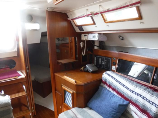

Pretty boat.

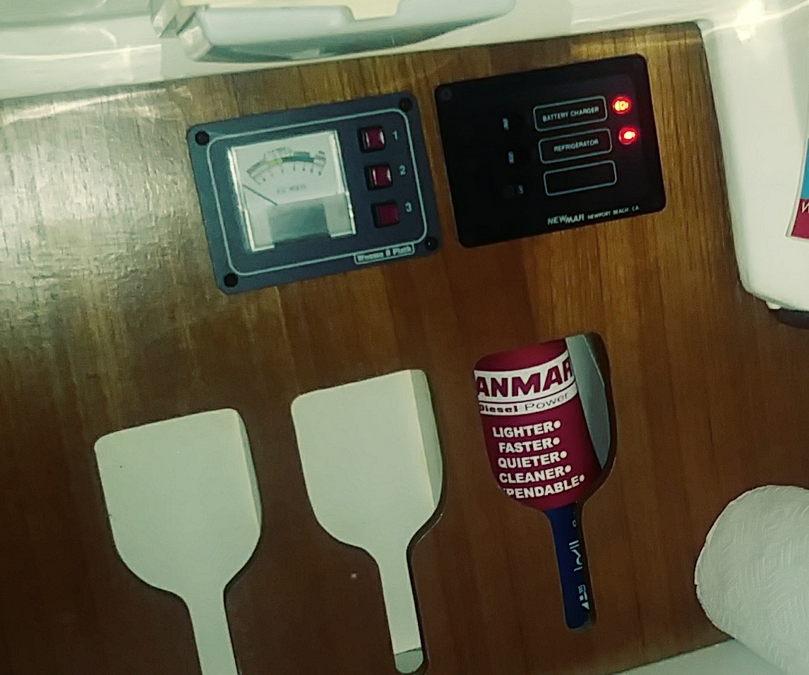

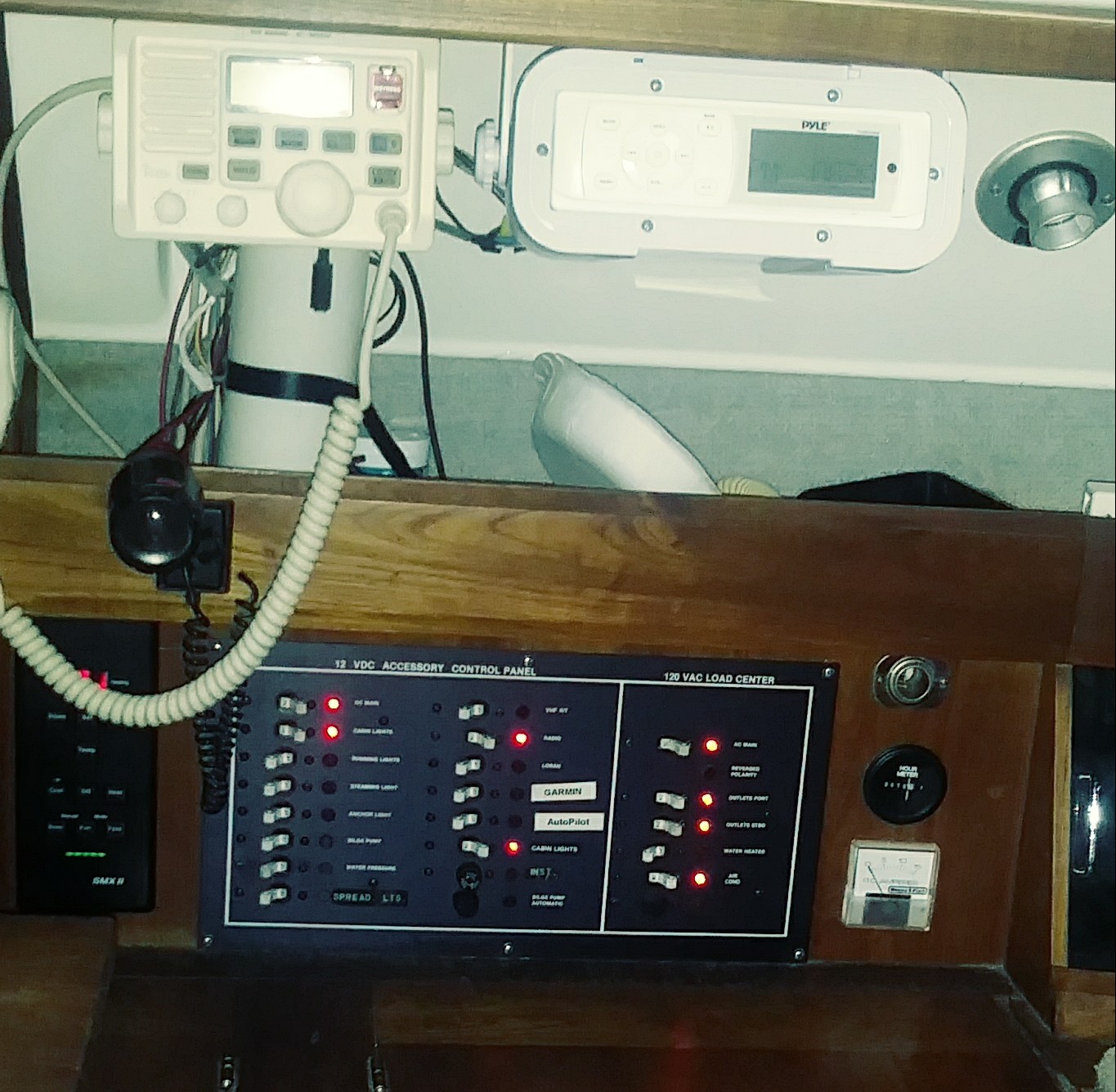

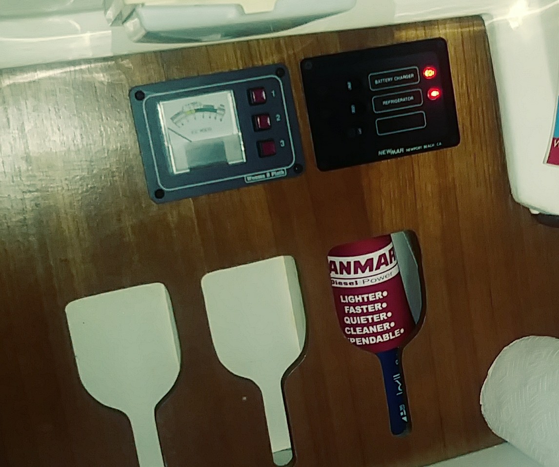

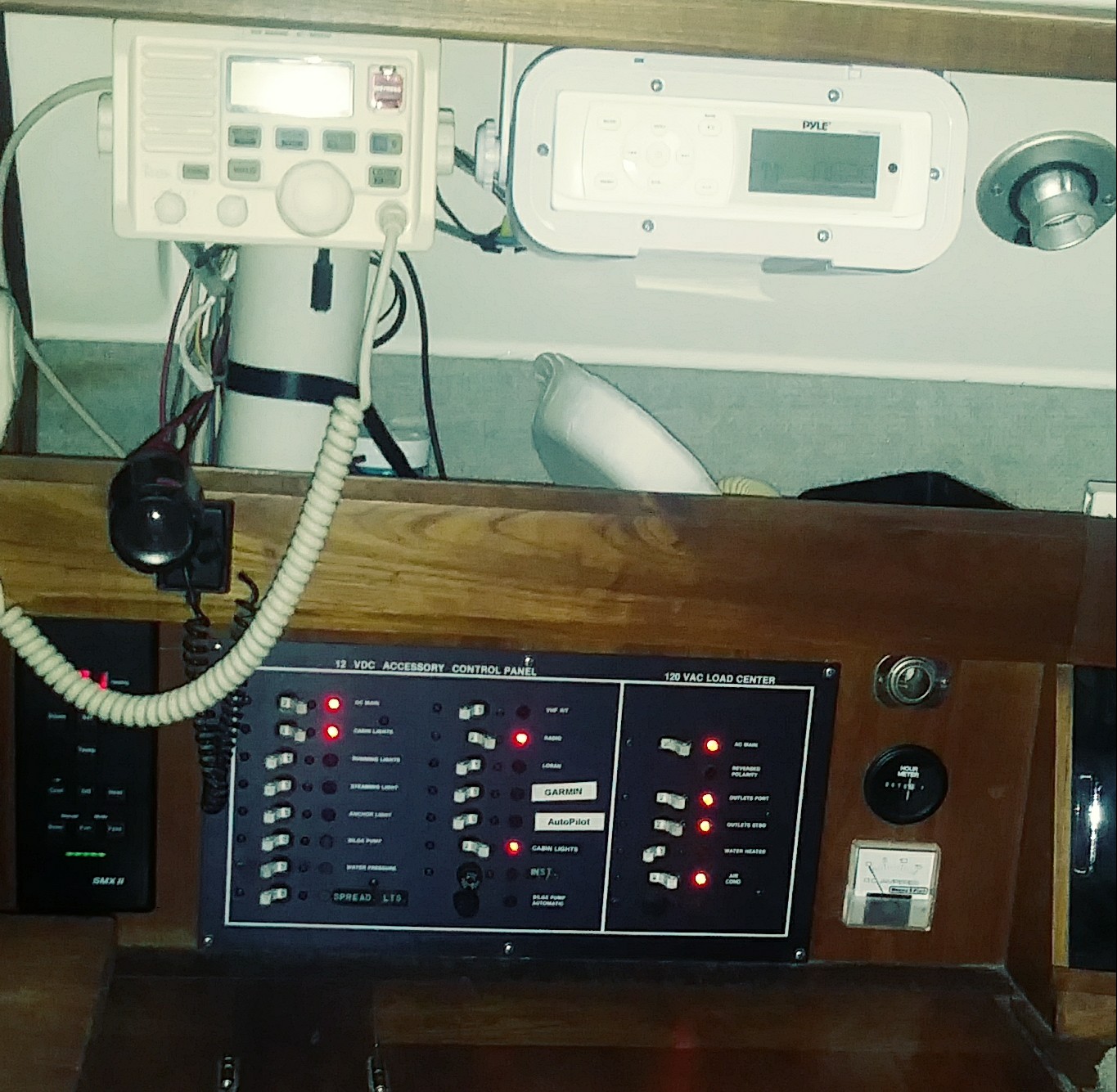

I took possession of the boat today it's going on for 10:00 p.m. and I'm settling in for the night I'm amazed just about everything on the boat works the only thing I haven't checked yet is the plumbing water system and pressure light steaming light running lights spreader lights everything works!
The build pump is acting like normal, it's not flooding. I really believe there was
was a huge amount of standing rainwater from being stored on land for almost a year maybe longer.
