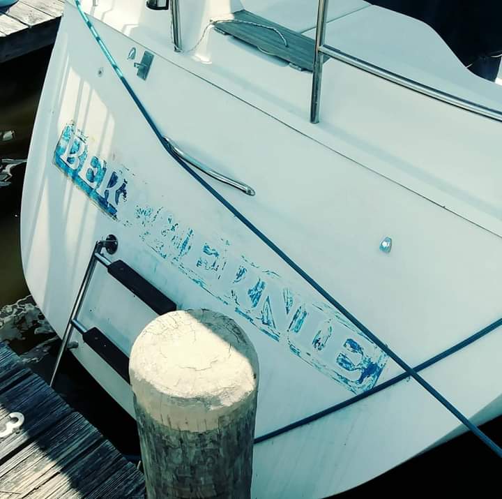

Still plugging along finally got Bert & Ernie back to the street and off the transom!

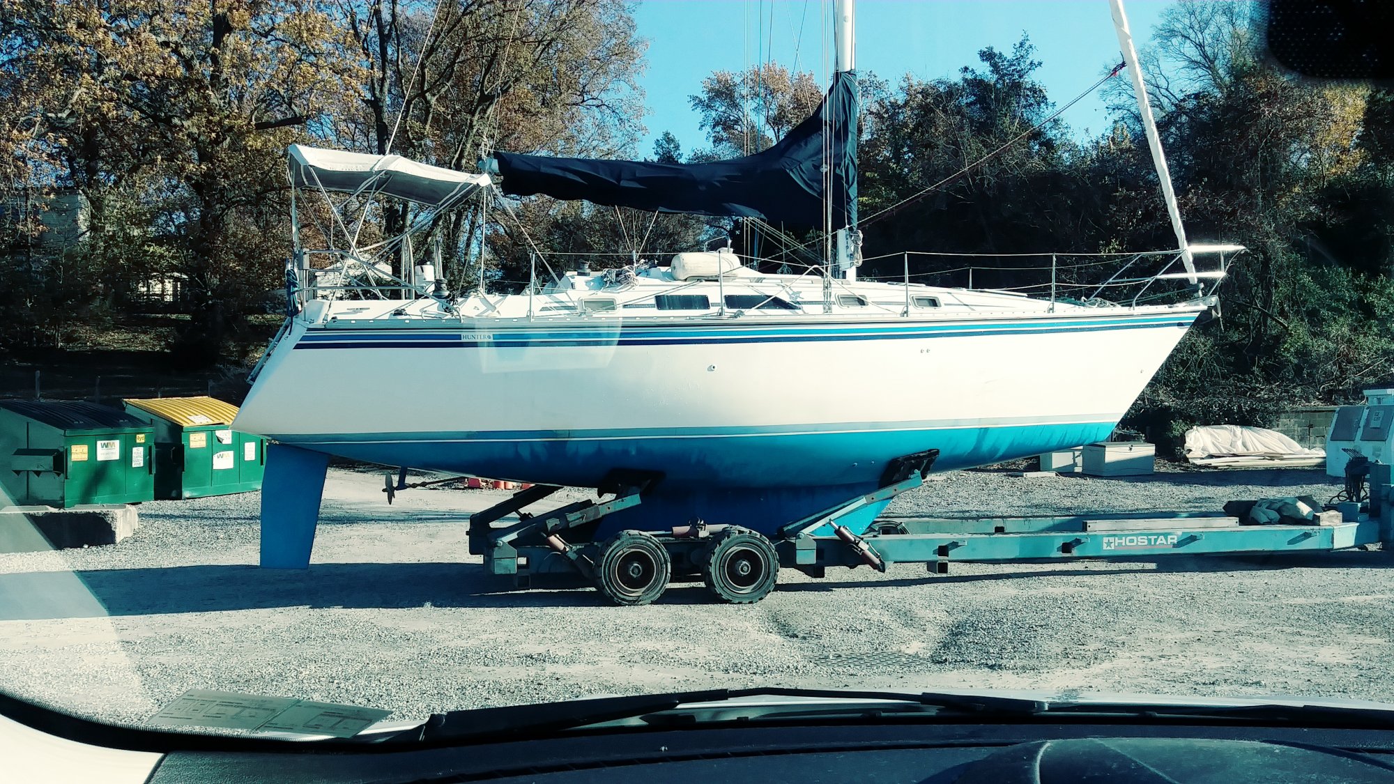

I must say I'm rather pleased how the Yanmar 3gm30 starts so easily even when it is cold. two or three short cranks and she starts!

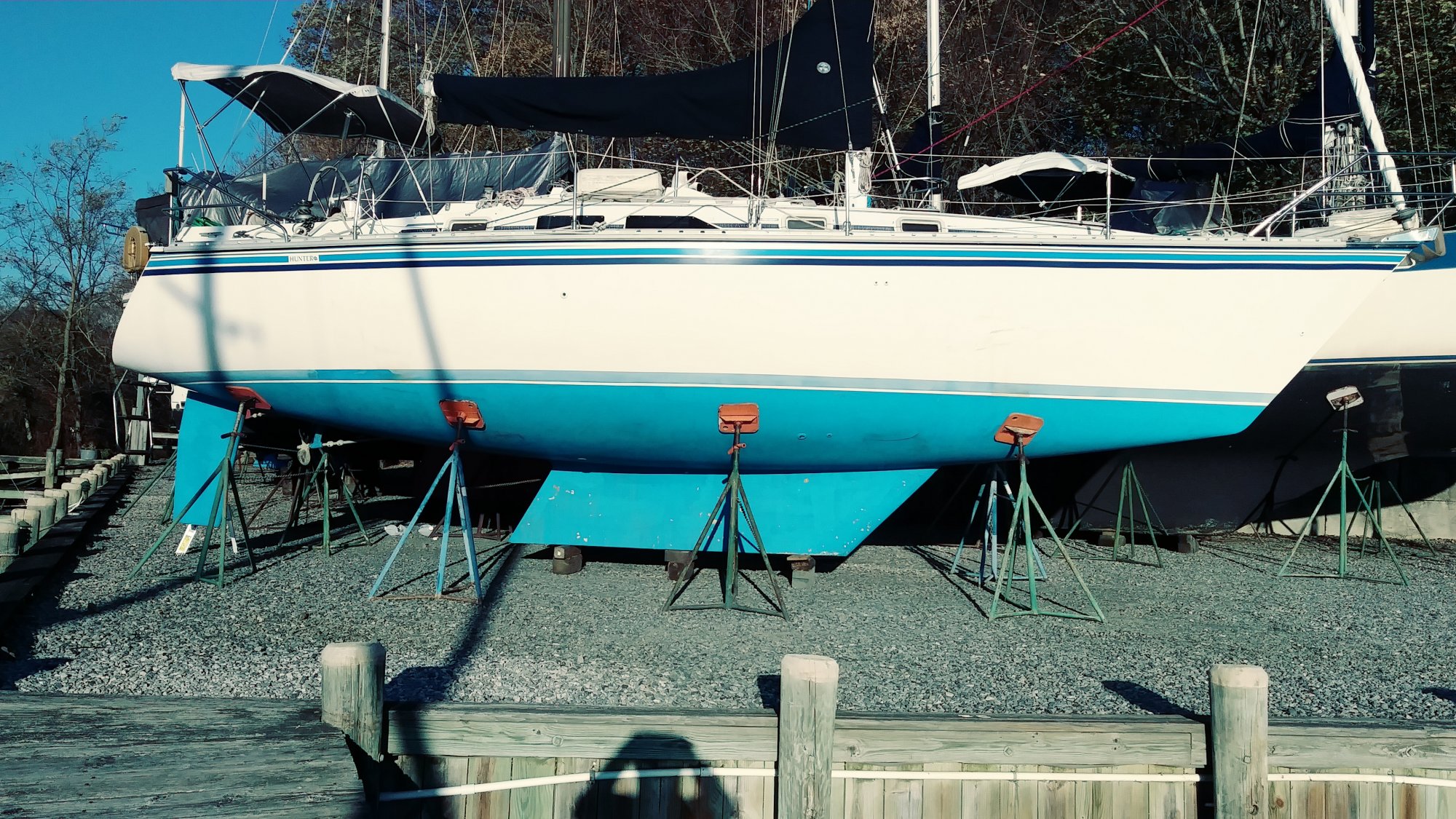

Further inspection of the hull... some blisters nothing major, the iron keel apparently has something under the bottom paint I'm thinking barrier coat because it's like a grayish white, that will need scraping and painting before spring splash,
May 17, 2004
6,228
Barrier coat over an iron keel is very likely. If the coat is compromised or you scrape into it you’ll want to refresh it with a couple more coats. Otherwise you’ll have rust bubbling out wherever water gets to the iron.
