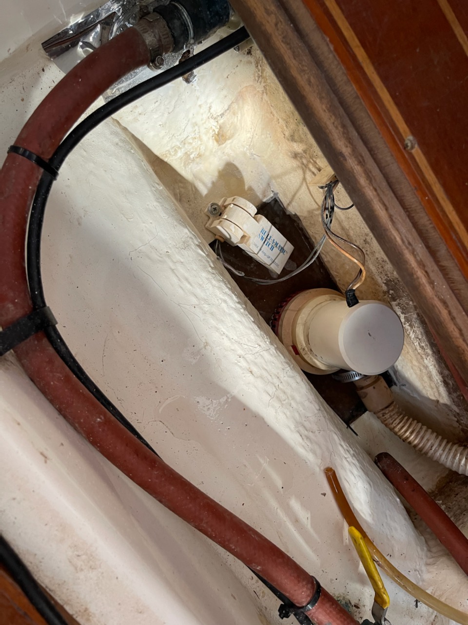

The soap bottle is holding the float switch down.

what is that part in the top-left of the picture in-line with the bilge hose? on my H34, the bilge drains directly to starboard from the bilge under the after end of the salon. The picture seems to show the hose wrapping around the bilge, exiting towards the forward end of the bilge to starboard. Seems like excess hose. Where is the check valve?

You're looking at the air conditioner pump and the intake hose.
the bilge pump convoluted hose is not actually showing. You don't have a check valve on your pump do you they are always discouraged because they fail

yes I do. there are a couple viewpoints on the bilge check valves. well maintained they rarely fail

How does one maintain a check valve?
always make sure the bilge pump screen is attached and clean to prevent debris from making its way past the pump. inspect the valve to make sure it functions properly, both opening and closing fully. keep it clean

Here is a better photo I'm waiting for a final report for my surveyor today.
Would you all say there is room in there for a second pump or high water alarm apparatus? by cutting more of the false bilge edges? (not sure what to get just yet)
I am a strong believer in redundant systems

yes, remove the entire false bilge. there are several good project reviews online with pictures
the float should be at same level as pimp

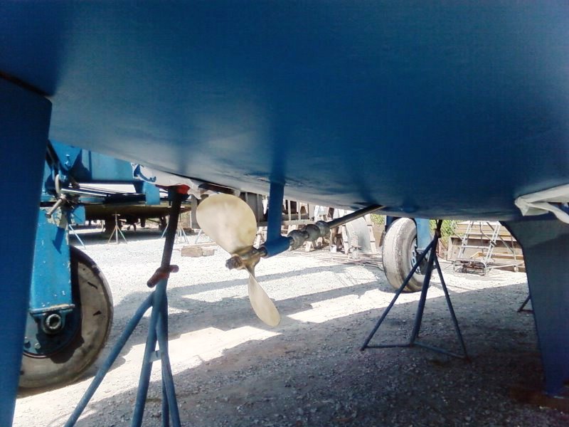

Questions about the driveline,does the rudder need removed for the shaft to come out? What puller have you used on the prop since it's close to the rudder?
Shaft is 1 in Cutlass bearing 1 x 1.25?

Yes, the shaft will not clear the rudder.. some folks have loosened the strut (and re-sealed after checking its alignment) , some have jacked up the engine, some have removed the rudder, and you may be able to remove it after removing the Cutless (1" X 1.25" X 4" long code name "BACK") There is plenty room on my 34 for a prop puller.

1. does the rudder need removed for the shaft to come out?
2. What puller have you used on the prop since it's close to the rudder?
1. Standard answer, probably. When you remove the prop, and detach the shaft from the motor, the shaft may slide by the rudder. Murphy and his law always seems to follow my boat repairs. I would remove the rudder in anticipation of Murphy's helping hand.
2. Often a block and hammer is all that is needed to remove a prop. Some times they are stubborn. Rarely is a puller needed.
The Cutlass bearing is different. A puller is designed for removal and reinserting the bearing. They can be sawn out in a pinch. The pullers are easy to operate. Just be sure you release any set screws first, and align all the parts or you can mess up the strut.
