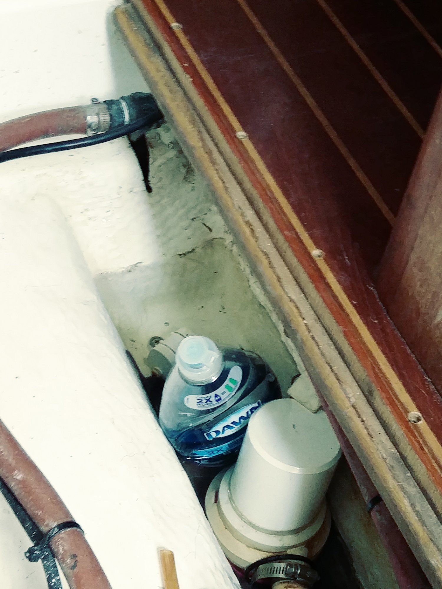

Everything fell into place. broker showed, up surveyor showed, up, pre-inspection went well. It was splashed, we took it for a run! Perfect day for it (Monday August 2nd) everything works, sails nice, points well, GPS, autopilot, refrigeration, air conditioning all work,
At the end of the day, watching the bilge fill & pump about every 2 minutes, owner said it's probably a through hull.
Personally I have my doubts and believe it's the keel joint!
Owner went back that night and worked on. (Like I believe that?) Yesterday I went back to the boat, the bilge still fills up to about 4" in 10 -15 mins, too much for my comfort level!
The soap bottle is holding the float switch down.
So unless they find some magic fix after they pull the boat I'm probably going to walk away from this. Sadly I get to lose a substantial amount for the survey, I'll probably get all my deposit money back, sometimes you just have to cut your losses.

if the leak is coming in “within” the pan, should be easy to find. keep in mind the H34 has a false bilge. from the photo the current owner has not removed the false bilge ( search forums for pictures of this issue)
did the surveyor check all thru-hulls for water intrusion? tracing that much water back from the bilge to source should be easy to do
where does the boat sit right now? i’d drive there and find the source myself - I love solving problems

I'm sure you mean well, but you can't be trespassing on somebody's property without permission, we all checked (per my first post) none of us could find any leakage at any of the through hulls, only the owner is saying that, which I don't believe. And the false bilge has been cut open, the ( bottle is obscuring)
it's one of the reasons I made an offer on the boat.

Note: the 34 has a Lot of bilge discharge hose volume and a small bilge. If the hose is cracked or the bilge pump check valve is leaking back, the bilge pump will cycle continuously until the hose or valve is repaired. The pump fills the hose and the switch shuts it off. The water leaks back slowly into the bilge and the pump turns back on and the cycle repeats. If the bilge water discharges immediately (stbd side toe rail) as the pump kicks on, then the boat really does have a leak, if no or very little water exits, it is a recycling problem.
