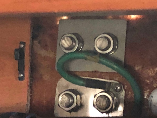

Same size as mine and I successfully used bed-it-butyl tape.
