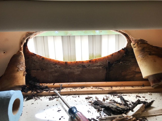

I need to dredge this thread up again. I need real advice.

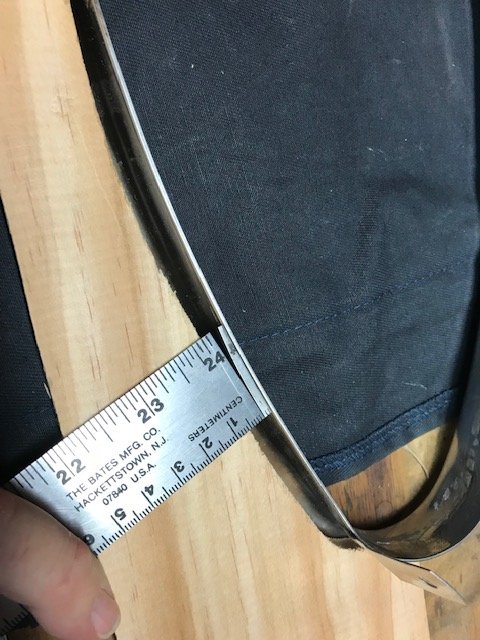

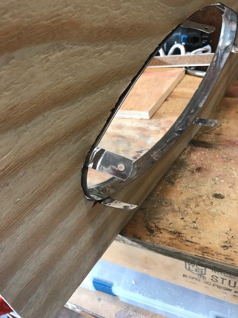

My portlights leaked and I am in the process of reinstalling them. I am, of course, considering butyl tape, but need to know if it will work in this application. We have a 42 Navigator with Bomar S616MBSS. The hole in the hull was cut pretty poorly and the inside of the hull is lined with 3/8" wood that is now rotted. So, of course, I need to replace the wood and reseal it. The poorly cut hole leaves varying gaps of up to 5mm around the edge of the frame itself. If I fabricate new wood for inside the hull that fits around the frame more closely, there will then be a gap that is the thickness of the hull that needs filling most of the way around the portlight frame. If you aren't familiar with this portlight, the outer trim ring/frame pushes in from the outside and six tabs bend and screw to the inner wood. Then the inner frame and window are pushed from the inside and screw to the wood. There are no screws that go all the way through and pull the sections together.
I was considering filling the gaps with butyl tape, but I do worry that because tabs are all that hold it to the hull, gravity will eventually take its toll. I mean, butyl tape, as far as I know, isn't an adhesive and I wonder if the tabs, simply, are enough to keep in in place.
I am posting a few pictures of the boat to understand the position of the portlights and of the bench work trying to show the gaps and how they attach. The wood is a pattern of the fiberglass hull hole from the factory.
Please help. I am headed to the boat this Friday to fix this because right now the hole is just covered in plastic and is a mess just waiting to happen. Especially with all the rain we have had. :)
THANKS!!
24,939
@GonzoF1 sounds like you are looking for a caulk adhesive filler. Never have I seen butyl used in this way.
Reading the description it appears the holes were not cut with enough precision for the port light design. Two ideas come to mind.
  1. Clean out the rotten wood. Sprary the port light frame with mold release. Position port light in the hole and fill the gap between the sound wood and port trim with thickened epoxy using the port light trim as the mold. When the epoxy hardens the mold release will allow you to remove the trim. Then clean up the area and install the port light. Install with 4200 or 5200 if you need the adhesive properties based on how the port light is attached.
  2. Cut a wood patch to install in space where rotted wood is removed. Attach I place against hull with epoxy. Using trim cut the port light hole in the wood patch. Install with 4200 or 5200 if you need the adhesive properties based on how the port light is attached.

#1 Not all butyl tape is the same and there are literally hundreds of different formulations. Bed-It Tape was specifically formulated & tested for marine use and it is not really a "butyl" tape but rather a hybrid product.
#2 That is the wrong application for Bed-It Tape or any other "butyl" because those tabs are simply not adequate enough to provide the sealing force required to compress the tape the way it is needed.
#3 I would begin by fixing how the builder screwed the pooch so you can start with minimal gaps.
#4 I would suggest a polysulfide such as BoatLIFE Life-Calk rather than a polyurethane or silicone for that application. They will eventually leak again so you want to be able to remove them.

One final question(s): Over the weekend, I installed the trim ring outside of the hull using Life Caulk. When I went to install the inner frame, it was not a tight fit at all and would leak for sure. The issues I have are too complex to try and type and have y'all understand it. And TBH, I don't know what went wrong, but what I am considering is using Butyl tape to fill these gaps. It will not be compressed like between a cleat and the deck, but it would be used more like window glazing. Rolled into strips and used to fill a gap up to 1/8". I would press it into the gap with something like a popsicle stick. If I stayed relatively on top of checking it, will it work in an application like this?
