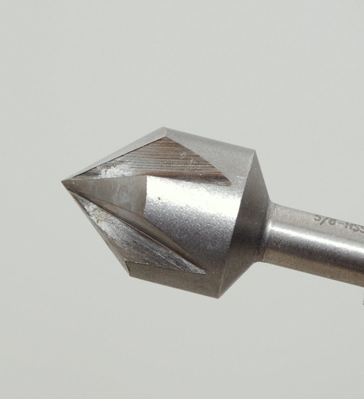

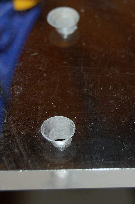

So why on earth do I countersink or chamfer the deck side of the skins?
#1 it does a lot to prevent gelcoat crazing. By feathering the edge of the gelcoat, through the use of countersink bit, you are now a lot less likely to start a crack or craze mark in the gelcoat. Gelcoatt is an unreinforced product and because of this its prone to cracking. Sharp right angle holes are a good place for these cracks to begin when you tighten the deck hardware and potentially flex the substrate. Beveling the edge of the hole or feathering it limits the ability of the crack to begin or start. This is why you often see holes drilled into plate glass that will have beveled or rounded edges too.
#2 By creating a bevel or countersunk recess in the surface of the deck the marine sealant or butyl tape has a cavity to fill. Without a bevel the hardware would compress the sealant to about 1/64th of an inch thick after the fasteners are tightened. Marine sealants do have some flexibility but not as much as you would guess. Follow me for a moment; Let's say you have a marine sealant that has a rating of 400% elongation before break on a 1/64" thick joint. Simple math shows you that 400% of 1/64" is only 1/16" of total allowable joint movement before a joint failure or leak starts. In the case of a stanchion base 1/16" is not much allowable movement before failure.
#3 By countersinking around the bolt holes you increase the maximum thickness of the sealant, at the bevel, to roughly a 3/32" depth at it's deepest point. Using the same math as above 3/32" X 400% gives you a total joint movement before failure of 3/8". If a mechanically fastened joint is moving 3/8" you have more problems than just a deck leak! So 1/16" allowable movement before failure at 400% without countersinking or 3/8" allowable movement at 400% before failure with countersinking. Even a small bevel will drastically increase max allowable movement before failure. Countersinking to a mere 1/16" depth will give you 1/4" total movement around the bolt before failure. You don't need a deep bevel to make a large difference between a failure and a seal.
#4 Countersinking is a no brainer and has many many benefits. For instance, you can install the fitting and tighten it down NOW with no waiting and you can seal deck hardware alone.

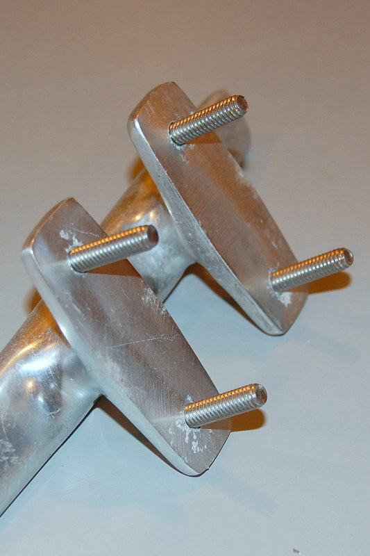

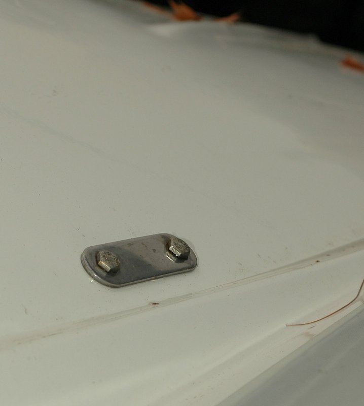

Here's a prime example of where the 1/16" of movement might make a difference. This is a stanchion base on a major production sailboat that was only two years old. The factory marine sealant, made by 3M, has failed and caused a void when the stainless plate flexed and bent.
This is another reason I prefer cast stainless or aluminum stanchion bases as they do not flex like plate stainless does. On top of the stanchion base bending this manufacturer also does not countersink the deck holes, which in this case resulted in wet deck core in under two years! Had the deck penetrations been properly countersunk there is a very high probability that this leak never would have occurred despite the cheesy quality of the stanchion base..

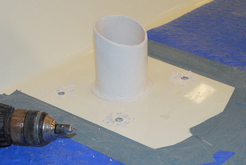

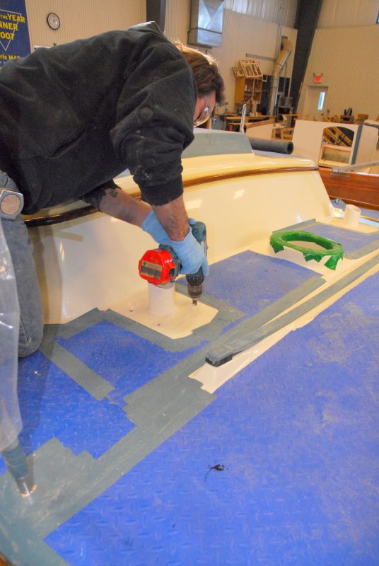

Okay, okay still not convinced? Here's how the pro's do it. I took this photo at Morris Yachts of a brand new Morris during the deck hardware installation. These four holes are for the Dorade box on an M-36.
It is utterly reprehensible to me in this day and age that the production builders are so bent on saving $0.02 that they won't take the extra 30 seconds needed to properly install deck hardware. It took this Morris Yachts craftsman less than 30 seconds, including installing the countersink bit into the chuck, to bevel these holes. 30 seconds!!!!!!
How many Pearson, Catalina, Hunter, Beneteau or other mass produced boats do we see or survey annually with wet decks? LOTS!!! How many Morris, Hinckley or other top builders using proper installation methods do we see with wet decks. Hardly any! Hundreds of thousands of boats with wet core over 30 extra seconds per fitting, if that. Ridiculous really...:cussing:
Rant over...
Four properly countersunk deck penetrations on a brand new Morris.

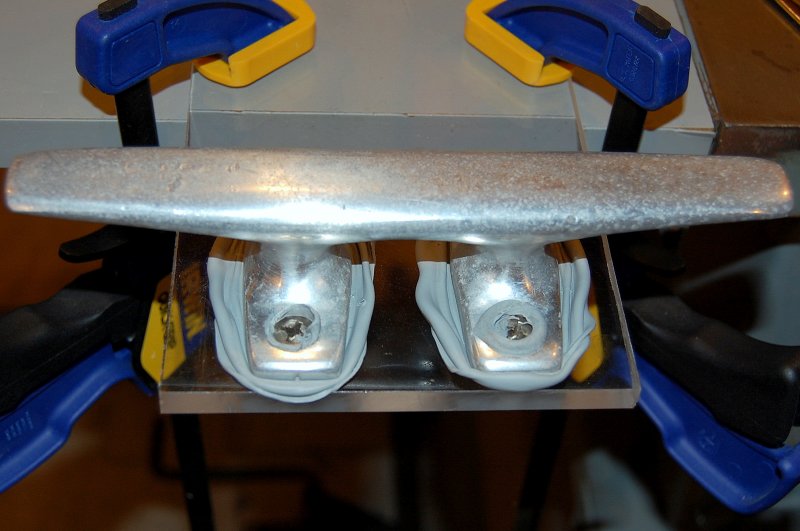

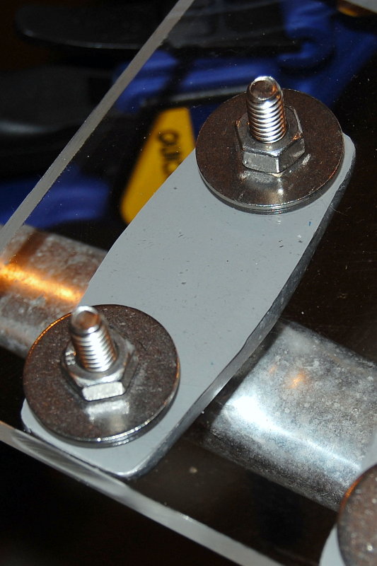

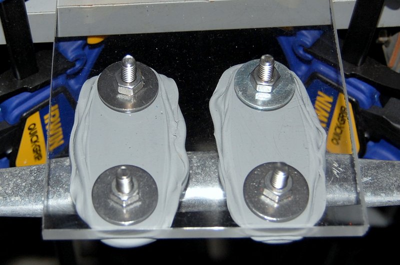

Okay, back on track.. For this illustration I also slightly beveled the piece of polycarbonate:

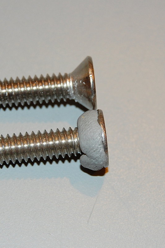

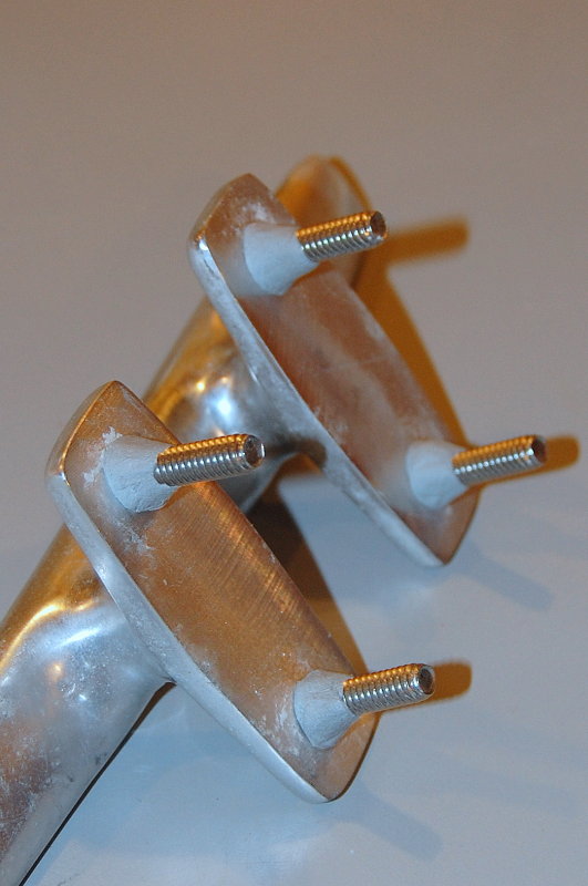

Step 2 - Wrap Bolt Heads - You'll want to rip off a small piece of butyl and knead it into a string then wrap the underside of the bolt or machine screw head.
Step 3 - Press the through bolts into deck hardware with some good pressure.
First though make sure the hardware is clean, Acetone works well, but if Silicone was previously used you'll really want abrasives as Acetone won't touch dry silicone contamination.
Gelcoat silicone contamination is a whole other subject for a whole other day. Please avoid silicone except for certain tasks involving plastics that requite its use.
Once the bolt heads are wrapped and pushed through, flip the hardware over.

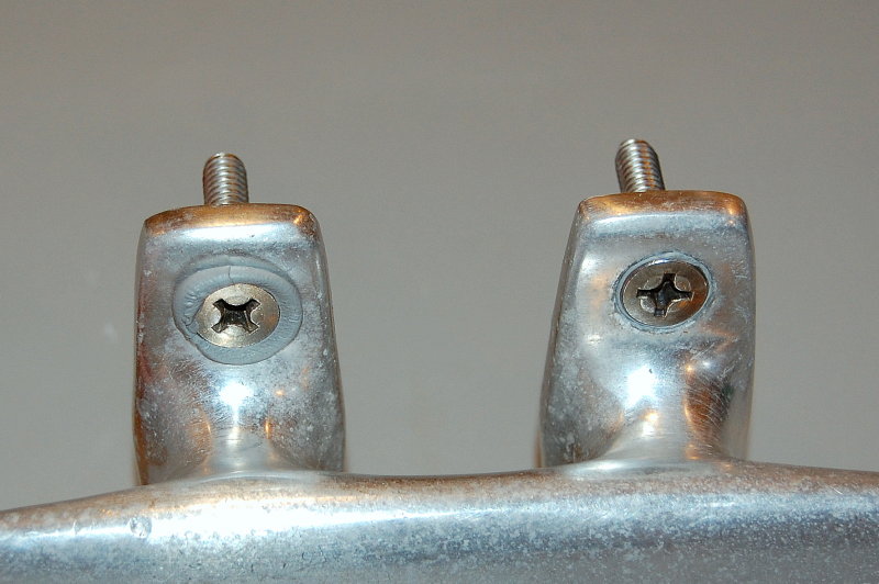

Step 4 - Strip some more butyl tape and make another round string. Wrap the string around the bolt threads or shoulder. Knead and work & twist the cones into the threads of the bolt and shape them like a cone.
Step 5 - Apply butyl tape to the rest of the base. It is perfectly OK to stretch and pull on the butyl while laying it on in order to make slightly thinner. For this project I used 1/2" wide by 1/16" thick gray butyl tape.
Step 6- In colder climates you may want to pre-heat the butyl to soften it some. After pre-heating with heat gun on the warm setting line up the bolts with the holes and press the hardware firmly onto the deck. For illustrative purposes clear polycarbonate was used in place of a deck, another Compass Marine first, but don't worry one of the magazines will surely rip this idea off in no time.

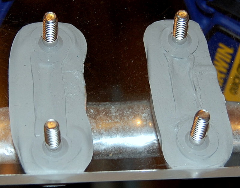

This photo allows you to see what actually happens when you bed with butyl.
Step 7 - Install the backing plates, in this case I just used fender washers, and begin to tighten. Please use suitable backing plates. These fender washers would not be the best choice in a stanchion or deck cleat as they are far to thin and a little on the small side diameter wise for a cored deck.
You will be best to have two people or a good way to keep the bolt from moving. Ideally you do not want the machine screw or bolt to spin, but if you absolutely have to, you can slightly soften the butyl with a q-tip and some mineral spirits and go for it.
Tighten the hardware a little bit at a time as the butyl will ooze out slowly because the consistency is quite thick. Tighten, let sit, tighten, let sit etc. etc.. When little to none squishes out & the bolt & nut become tight you can stop. If you have a wood deck core DO NOT crush it by over tightening, better yet bore out some core and pot the hole with thickened epoxy.

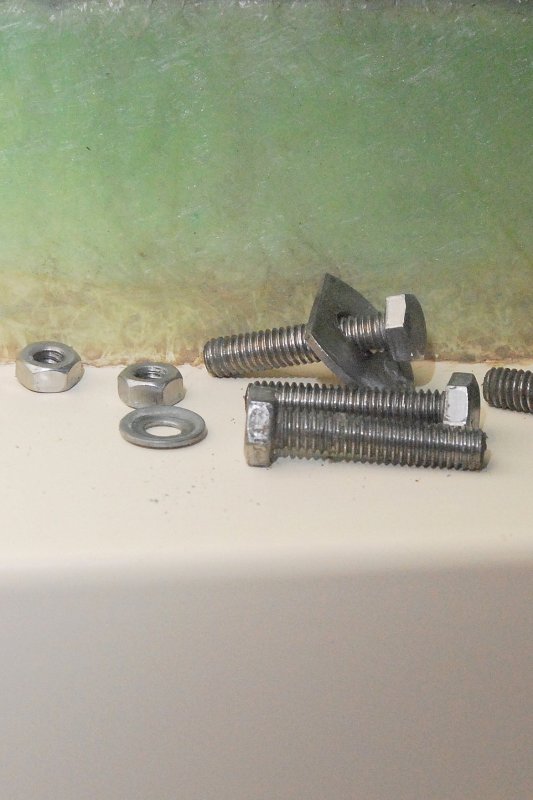

Here, I have taken pictures of the underside when tight.

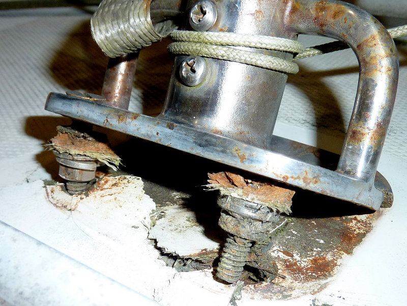

As I mentioned in the last photo please use properly sized backing plates. This is a prime example of DIY boat work gone bad. Ouch!! This stanchion base had NO sealant of any type installed, not polysulfide, not a polyurethane not butyl and not even the dreaded silicone.
As a result of this unbelievably poor installation the core turned to mush. The thin fiberglass deck skins, combined with dinky little washers, could not withstand the forces applied on the 24" lever attached to the stanchion base, and ........ rip!

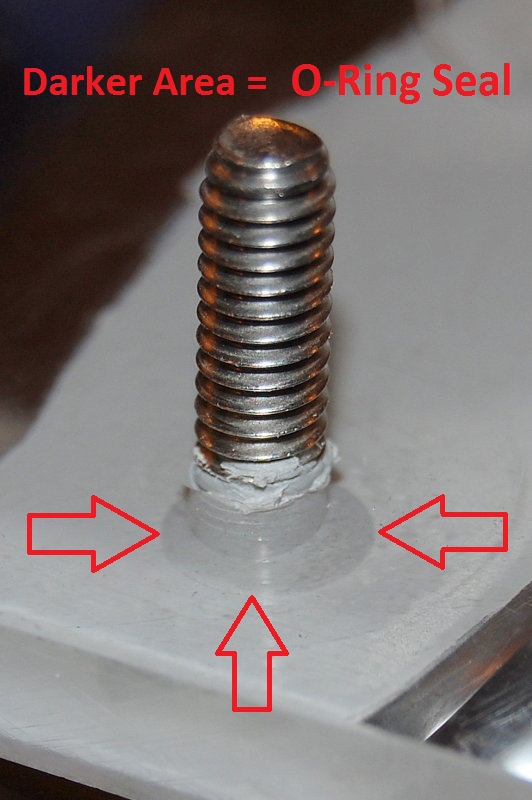

Contrary to popular myths about bedding all the butyl does not squeeze out from between the surfaces even after the fitting is fully tight. This is the magic of butyl, but it does take multiple small tightening events, ideally without letting the bolt spin, to get the vast majority of the butyl to squeeze out.
This is the view after tightening to full tight, and then removing the nut and washer. You can see how well it actually seals, and that it does NOT all squish out, as rumored to for years, if you tighten to full tight. You can also see the o-ring seal of thicker butyl created by countersinking & the butyl cone. The butyl o-ring created by countersinking the deck side is evidenced and can be seen by the darker colored ring of butyl around the bolt.

As I mentioned butyl tape is VERY, VERY flexible. This photo represents well over 1000% elongation of the original squished thickness and the butyl is still stretching and much of it has not yet failed.
You will also notice that it is still perfectly adhered to the deck and the cleat and never let go of either despite its very low 10-20 PSI bond strength. When compared to Satan's Glue/3M 5200 and its gelcoat destroying 700+/- PSI adhesion you can see why this ridiculous level of adhesion is 100% unnecessary.

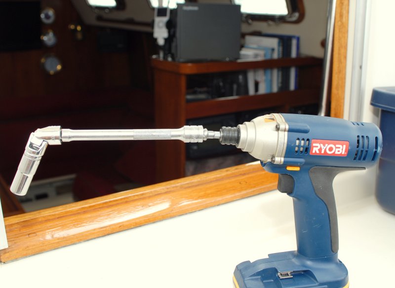

Just a quick tip on removing hardware. A cordless impact driver can make short one person work at removing the nuts on the inside of the boat.
For stanchions and other hardware I often re-install them with hex head bolts rather than Phillips or slot headed screws. This allows me to tape a wrench to the deck using Gorilla Tape to keep it from moving then hit the inside with the impact driver, wrench or socket wrench. If you use the impact driver to re-install pleas DO NOT over do it. These tools are powerful and fast. I would advise against the use of one for re-installing the hardware until you know you are competent with it.
Impact drivers work via hundreds of rapid fire quick impacts or beats per minute sort of like a machine gun. These small, short, very fast beats or impacts will almost always break a nut free from one side without even using a wrench or screw driver on deck.
This is one of my impact drivers, it's a cheap Ryobi and does the job. While I much prefer the quality & torque of a Li-Ion powered Makita, Bosch, Hitachi or other premium brand I won't lose sleep if I hand this one off to Davey Jones and that kind of Li-Ion torque power is just not necessary here..

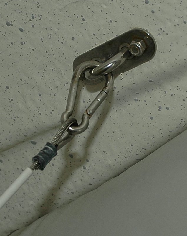

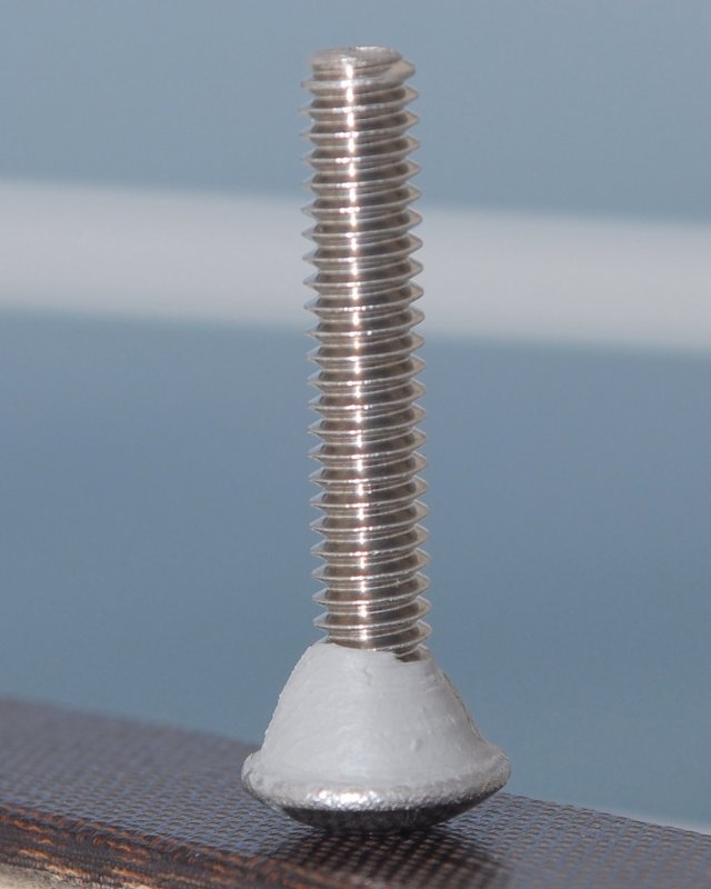

One last trick. We've all removed old hardware from a boat only to be left with a hole in the fiberglass. You can try to patch it with gelcoat, and may succeed, or you may make it worse if you're not well versed in glecoat repair. Here's a quicker way to get back to boating.

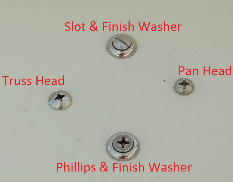

Simply countersink the hole then use a truss head machine screw, or your preferred style, and butyl tape to cover & seal the hole. Truss head machine screws are available from most nut and bolt suppliers like Fastenal. Truss head machine screws have a much wider and lower profile head than a pan head machine screw. The truss head machine screws lend themselves well to plugging old holes with butyl tape..
First make a butyl cone around the head.
Choose your weapon. I prefer the truss heads as I feel they seal better and will have less potential for leaking. They are also very low profile and make for a somewhat professional looking band-aid..

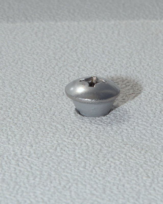

Clean the surface and insert the butyl wrapped machine screw.
You can see the cone fitting nicely into the beveled hole.
Have one person hold the screw head with a screw driver to keep it from spinning then go below and install the nut and washer and tighten it down..
Rant over...
After tightening, the excess butyl will squeeze out around the edges. The easiest way to clean it up is to pull or peel it away first. Use some of the excess butyl to make a small ball that you can then make quick stab & pull motions at the remaining oooze around the fitting. This quick stab & pull with a butyl ball in hand motion will get about 85-90% of the butyl cleaned up.
Step 8 - Peel away excess ooze and clean with Meguiars cleaner wax, or a rag slightly dampened with mineral spirits. Do not saturate the rag with mineral spirits as it can creep under the fitting, just damp.
I find a ball of already "peeled" butyl works well at pulling away excess using a stab and pull motion. Stab the ball into the joint and pull away. The butyl will stick to the ball first and usually peel away from the joint. Alternatively you can use plastic razor blades or scrapers.

This genny track was installed without countersinking the holes. Just an aluminum genoa track bedded with butyl tape in 1979. Bevel the holes and it will probably go 70 years without a leak..
