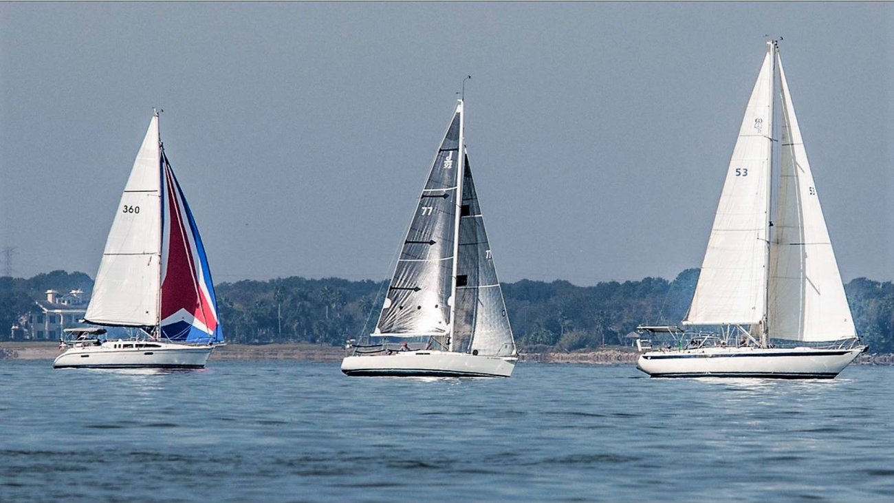

If you look in the photo on #1, the yellow line is the twing and the barber hauler is the green. Here’s another photo of the same race leg, we’re sort of holding our own trying to point with the code 0 up in under 3 knots apparent. The sail was touching the spreaders at times. Would only attempt this in very light winds.

Twings on asyms are used to correct the usually totally wrong sheeting angle created in the first place. Spin blocks are really positioned for symmetrics, and for asyms this is wrong. So you twing!
Bill in that picture you need EVERYONE on the leeward rail, close to the mast. You're way too flat in the water. Induce heel to help the sails fill and reduce wetted surface area. Forward keeps the transom out of the water. That j/92 is doing it right.
That J92 weighs half as much and probably has more sail area, even with just a jib.

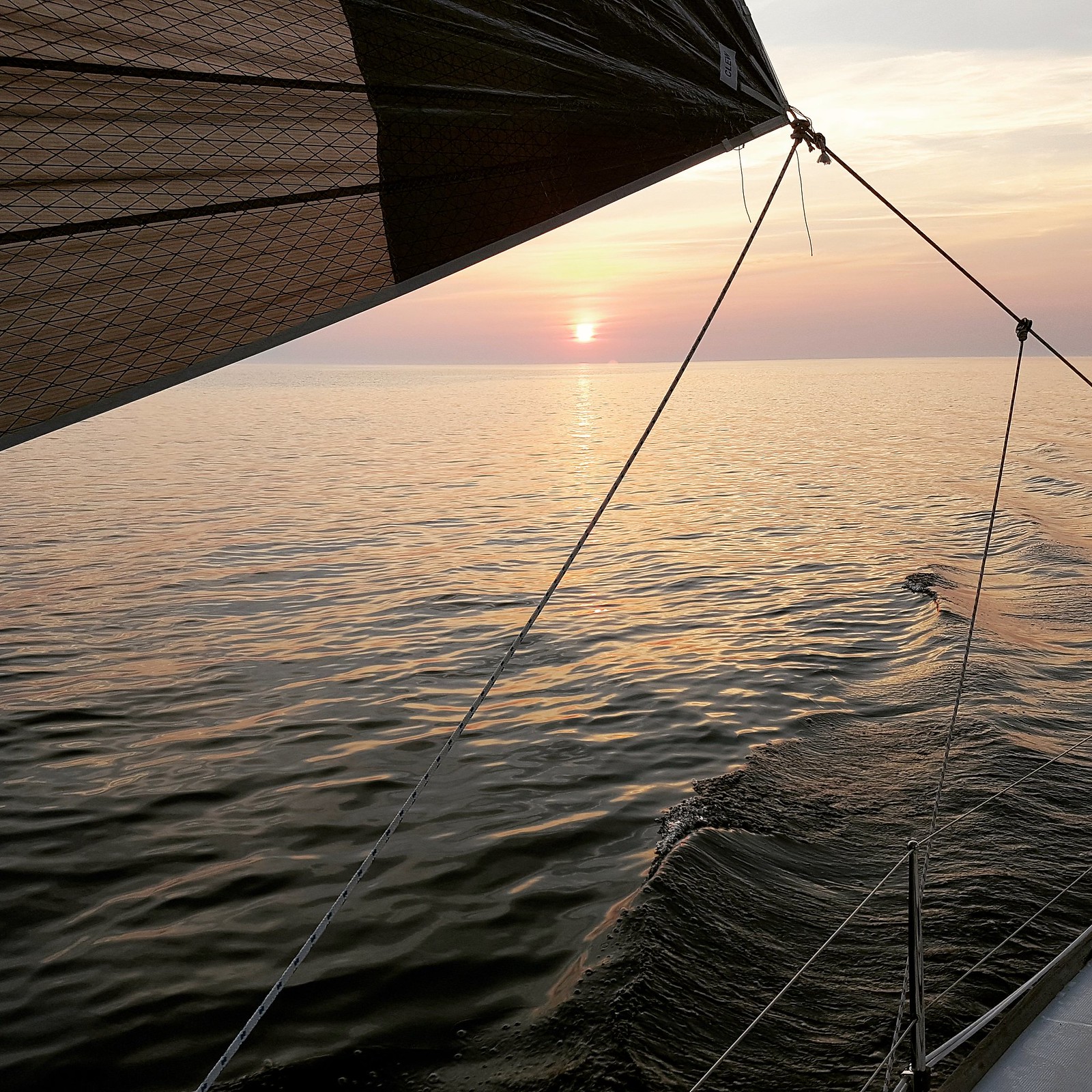

On the Code 0 tweakers, here's a couple of shots of the First 40 I race on. The first one shows how far forward the tweaker is lead.

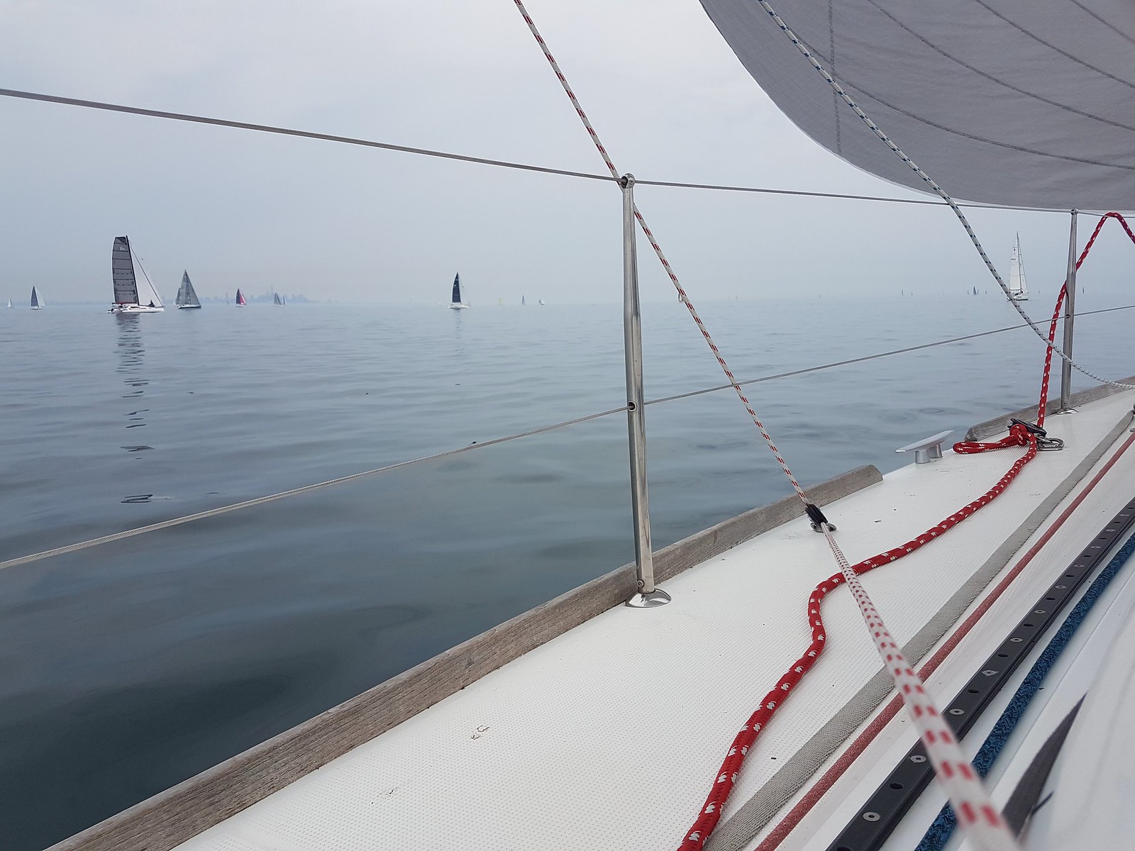

This second one shows a bit more but it isn't set right, the tweaker should be pulling down on the sheet more but we weren't racing at this point so we must have been slacking off :redface:
Maybe. But the heel is induced by the crew doing the right thing. Its 2 knots of breeze here. We'd be standing straight up if we were not all on the leeward rail. People underestimate the importance of crew placement, on any boat.
