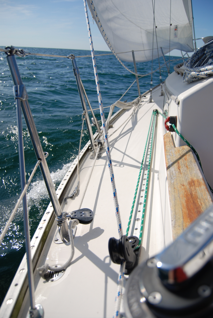

If a boat has inside jib tracks, i.e., between the rail and the doghouse, there really isn't much of a need to barber haul the sail. See the attached photo. When the sail is sheeted in it will be close to the stays. On the other hand, if the track located on the rail, barber hauling will bring the sail closer to midline and improve performance to weather.

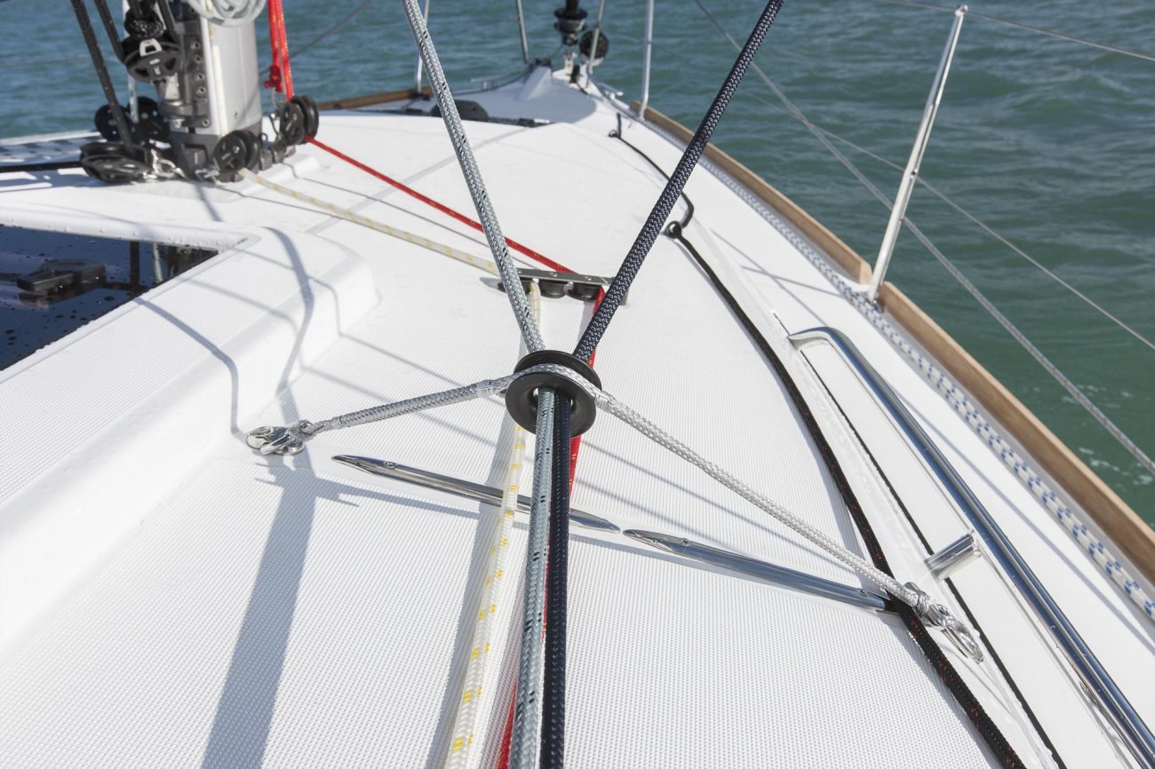

I was thinking low friction rings like rgranger . I'm not sure how adjustable this is, but here's the jib sheet set up on the Jeanneau 349. No tracks or blocks, the jib sheet goes through the ring to the winch.
I'd like to understand this better. Do you have more pictures? Why are there two lines going through the same ring? And how do you adjust the sheeting angle with this set up?
13,993
The lighter line looks like some sort of Cunningham.
-Will (Dragonfly)
Here's another view from Jeannau website: https://www.jeanneauamerica.com/en/boats/2-sun-odyssey/59-sun-odyssey-349#gallery-exterior_23
The black lines are the jib sheets and do what jib sheets normally do. The gray lines control the rings, tighten the line the rings will move back and in, loosen they move forward and out. Essentially, an inexpensive way to have an easily adjustable fair lead without a track and the hardware necessary for a towable lead.
However, on the port side there is an extra line attached to the ring, There doesn't seem to be one on the starboard side. And then in this photo: https://www.jeanneauamerica.com/en/boats/2-sun-odyssey/59-sun-odyssey-349#gallery-exterior_3 there appears to be track for a self-tacking jib.
Perhaps that extra line is the sheet for the self-tacking jib if one is using the jib in the self-tacking mode.

8,119
Wow, now I REALLY don't understand it. It looks like there is added complexity. Why would those lines go to the gooseneck on the main? Why, in the photo in dlochner's link, does it show the windward lines tight while there doesn't appear to be a jib sheet going through the leeward ring? Bill's photo clearly shows the setup of the ring and it doesn't have any adjustment. There must be a second, primary, sheet on the jib that doesn't go through the ring.
-Will (Dragonfly)
13,993
It gives the rings vertical lift.
Look closely. The windward sheet drapes from the ring to the mast and then is hung up on something so it looks taught from the mast to the jib tack.
Yes it does. The gray line is the adjusting line. Slack the gray line and the ring will drop. The jib will then pull the ring outward opening the slot for more off wind work. The ring can move forward or aft based on the pull from the gray line. The line controls the height of the ring and the ability to tip forward or aft. Tension the gray line and it positions the ring. Loosen the gray line and the jib sheet positions the ring.
The ring and the block on the boom are not in the same vertical plane. In this photo you can see the gray line is angled forward: https://www.jeanneauamerica.com/en/boats/2-sun-odyssey/59-sun-odyssey-349#gallery-exterior_29 (Note, in this photo the jib is furled, the boat is sailing with the Asymmetric)
Admittedly the adjustment range is quite limited. Then again, it looks to be a small jib, probably around 100%. With small a jib, a large range is not really necessary.
