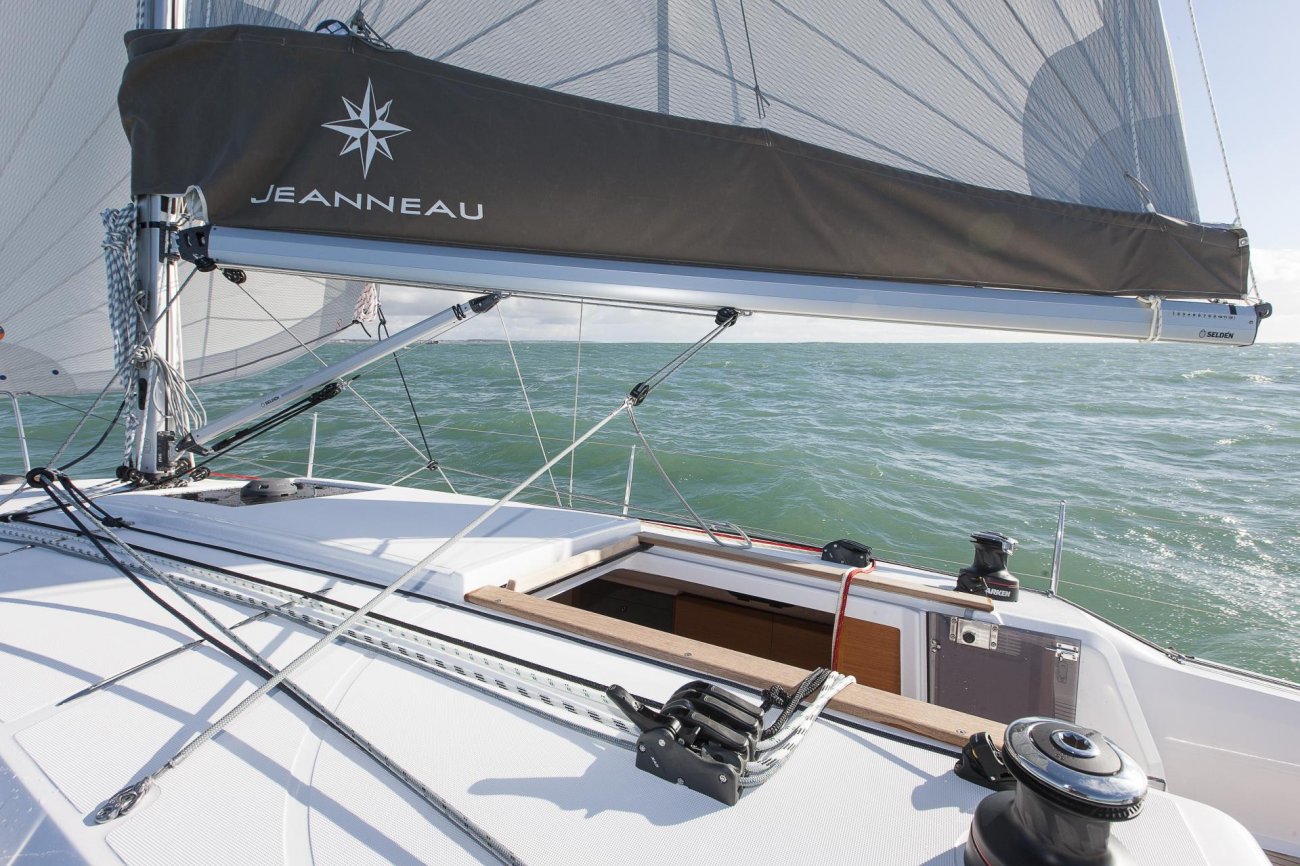

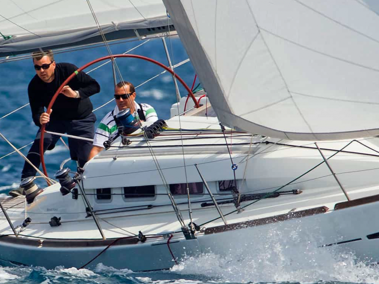

I didn't start this thread to figure out how to sail a Jeanneau 349, but if I didn't think it was too much load on those rings, I would think that extra gray line in the ring was a double ended mid boom mainsheet led back to the cockpit on both sides. And the rings are not adjustable to change the lead angle of the jib sheet.

Here's another image from the Jeaneau site: 554e7a0153363daf5193f6b7ba5c2889.jpg That may clarify things a bit and is different from the other images or confuse them more. This image does not show the jib sheets or the winches that control them. In the original photo that was posted, those blocks were not shown, perhaps they are an option? In the photo I initially posted, there is a bunch of line lying on the deck near the ring, I think this is the block and tackle to adjust the ring.
Yes, the gray line appears to be a double ended mainsheet. However, there appear to be adjusting lines on the rings. Notice the block and tackle on the inboard side of the rings. These would allow the rings to move forward and aft and inboard and outboard. This allows the ring to simultaneously act like a barber hauler and adjustable fairlead.
To go back to the original question about barber hauling, a simple method would be to place a low friction ring forward of the turning block on each jib sheet with a line leading inboard and then back to the cockpit and a stopper. It would be like a horizontal version of a spinnaker sheet twing. The Jeaneau needs the second nonadjustable line because it does not have a track and lead secured to the deck.
The photo you attached makes sense and I see how it will adjust forward and in and looks like a great setup that avoids dozens of holes in the deck from a track. The photo I inserted in #11 must be a different boat that doesn't have the inboard adjuster on the ring. But, when you adjust the ring to change your jib lead angle, it also changes your mainsheet tension, not much, but a mid boom mainsheet seems like a lot of load on the ring. There must be something else I'm not seeing, I don't think you would want to run your jib and mainsheet sheets through the same ring where they could interfere or tangle.

The last image I posted looks more like a computer aided drawing and not a real boat. The confusing thing about the image you posted in #11 is the absence of the adjusting line, perhaps that is an option?
The line securing the ring looks like 5/16 or ⅜" dyneema. That would be plenty strong enough. Keeping the lines straight would be important. Yes, changing the jib lead angle would cause a small change in the mainsheet, a slight inconvenience, however, any large changes would like be the result of a major wind shift or change in boat direction and re-trimming every thing would be in order.
One thing I would be concerned with is a tripping hazard. The fairleads appear to be on the cabin top and out of the way. If they were on the side deck they might interfere with going forward. There are enough things on board to trip over, I'm hesitant to add more.

It's usually a tripping hazard if it's above instead of on the deck, and there are lines all over above the deck and cabin top on this boat. I think the photos in #11 and #21 are the same boat. It looks like there is a ring adjusting line on the port side, but not one on the starboard.

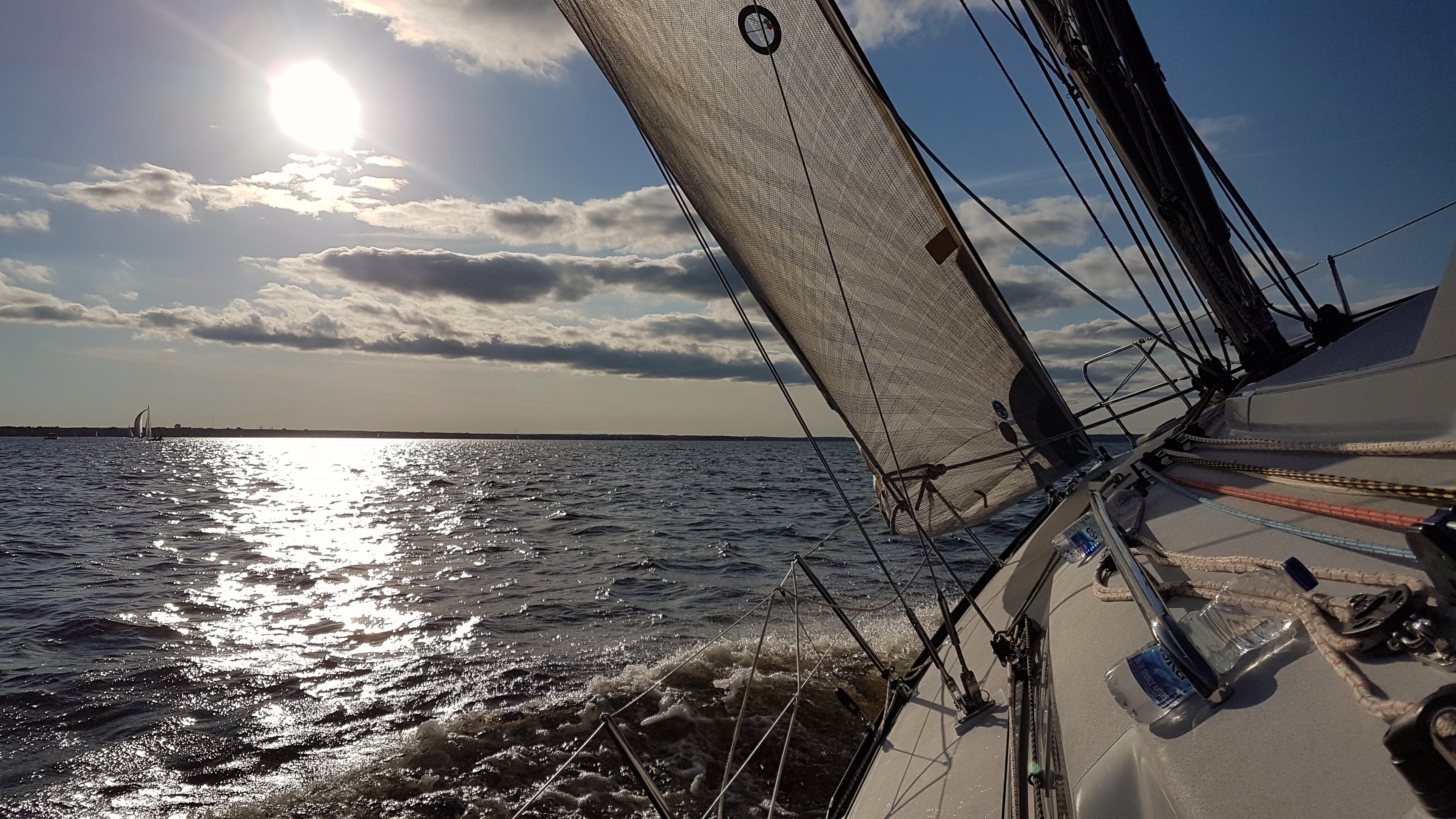

Here's a shot of the inhauler on the C&C115 I race on. It's not a great shot of the setup but you can see it's just a stainless steel ring with the sheet through it just ahead of the jib car. It isn't loaded here because we are cracked off a bit, but if you pull on the 4:1 line shown slack on the cabin top it tweaks the sheet in. It ends up as an 8:1 total because the line doubles through the ring and back to the cabin top so it's pretty easy to adjust even under load. You can see the jib track is inside the shrouds but as Jackdaw says, if you are already sheeted to the cabin top you may not gain by tweaking inboard.
Likes: rgranger
Nov 8, 2010
11,386
That's a great setup!
12,918
Thanks for that shot. It is really easy to see how it is set up. I'm setting up a system that would be essentially the opposite of this (an out hauler) and I sure can use this setup as a guide (just reverse it). I also like your drink holder set up....;)
Likes: DArcy

Same setup on Gotta Wanta, the J122 I race on, Bob installed low friction rings. The purchase is made from the opposite side for allowing adjustment from the weather side. Looks like the blocks on the rail bungied to lifeline are for outhaul as well? When reaching the outhaul really helps as well.

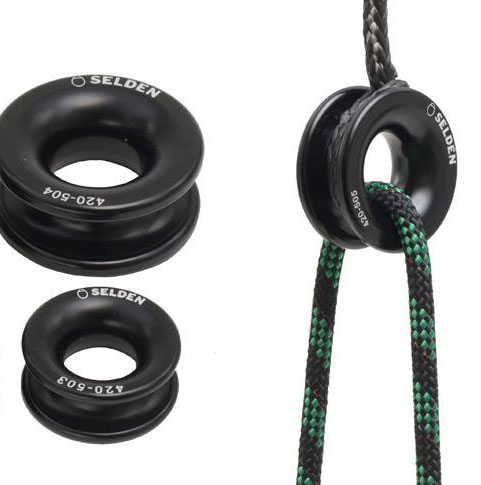

2) Use ceramic low friction rings instead of SS rings. Much less friction due to the wider sliding surface. You can attach around the ring if the ring is fixed, or create an easy 2:1 by looping the working line in the ring.
Standup blocks for guys. The boat probably runs separate sheets and guys.
That's exactly what is is. The load is not on the ring. Its on the dyneema loop around it.
