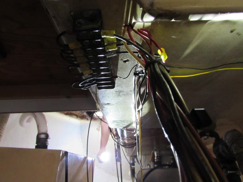

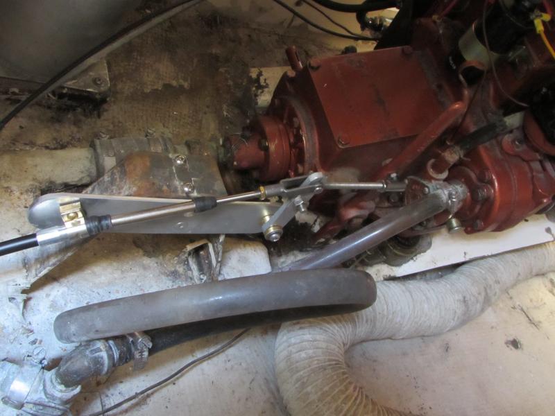

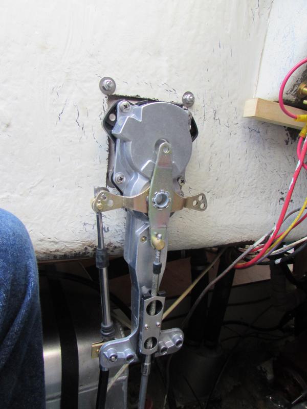

Well the new shifter setup works grand. This is the Vetus SISCO with some adaptation to the standard setup that is easy to make. Here is that hole for the wires Jonny. I rerouted most around the aft edge of the liner and back to the panel. If I had any ambition I would have enlarged the hole.

Yes! So launch day came and went but not without a few minor hitches. The first was the linkage required for the new single lever shift/throttle. I was stunned at how readily the Atomic Bomb fired up after its' nap. Never even made it through a full cycle of the pistons and it was purring away. A bit high on the idle that a quick adjustment on the thottle cable pivot cured. Next was no reverse gear. Again a few turns of the ball joints solved this. This setup is far easier on the shoulders than jamming the shifter on the old setup was. The mechanical advantage has proven far superior with the intermediated lever. Next I screwed up the lower shroud placement resulting in only a few threads engaged on the aft and almost buriied on the fore. A trip up the mast and reversing the placement solved that. Note to self: Use a bosuns chair and not a rope sling as it is easier on the butt. Those marks aren't going away anytime soon. So the 27 due to its' wider beam aft, duh, gets the 201.5 inch shroud and the fore gets the 201 inch. Now with both about one third of their available thread engaged its' time to go for year two.
Joe, finally got to look at that photo you posted here where you re-routed your wires through the liner--thanks, that helped out alot. I hadn't thought of punching out below the liner cavity space. When I redo my wiring I may follow your example.
