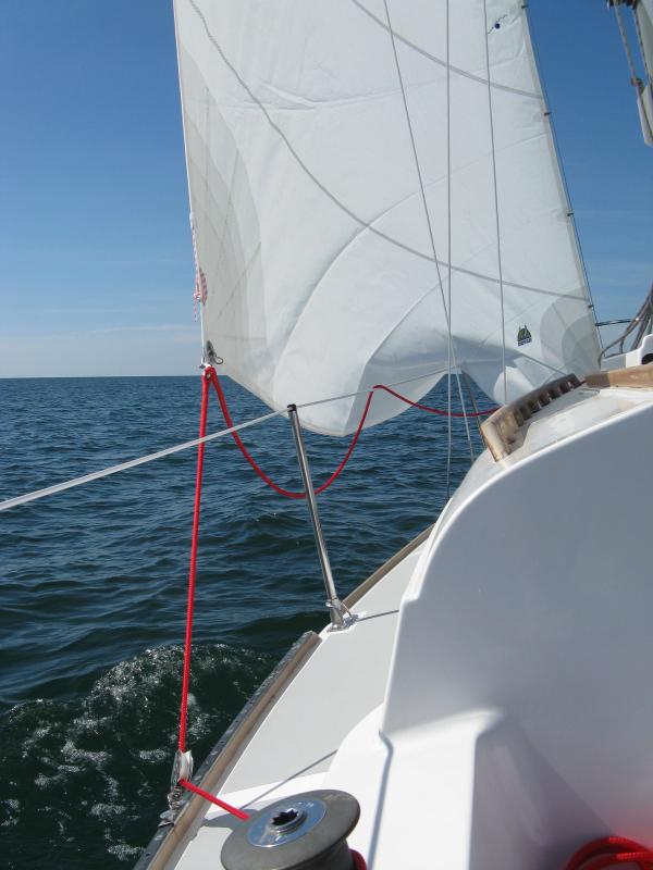

Here is some stuff you might enjoy. The 140 Genny makes light air windward work loads of fun (thanks for the input on that one jibes) while the Asym provides some real thrills for the downwind. The little engine now runs reliably thanks to new fuel pump, filter, carb rebuild, points, plugs, plug wires, coil, rotor, on/off switch and cap. Nuh, quit now bugger. The crew is gaining confidence and ability so the real fun is beginning. ;)

Hey Joe,
Just curious how YOT tracks down wind. How about weather helm to windward?
Glad you're having a good time.......you sure earned it!!

So far so good T. Not much weather helm in the windward dept even with the 140. I can feel it but YOT just has no desire to round up no matter what the wind does. There is a definate feel on the tiller but nothing that I find strenuous. Downwind she is very light to control. A quartering sea is the trickiest as she will try to turn into the waves and this is where a substantial amount of force is required to hold her. I don't have weather helm so I am rather pleased at the balance. I was on a close reach last weekend and trimmed so that we sailed for 15 minutes without touching the tiller as the balance was just that good. No auto pilot just for clarification. Still a little intimidating. Reminds me of some of the girls I dated. Just ready to tear your heart out. Beggining to look like the kind of girl you spend your life with though. Thanks for the inquiry. So far so good and hope you get as much joy out of your 27 as I am of mine.

Just about what I figured based on other reports. Looks like R Jean will be sailing through on his way to Mex in a couple of months so we'll find out more on down wind performance. Be fun to check out how he's set his up.

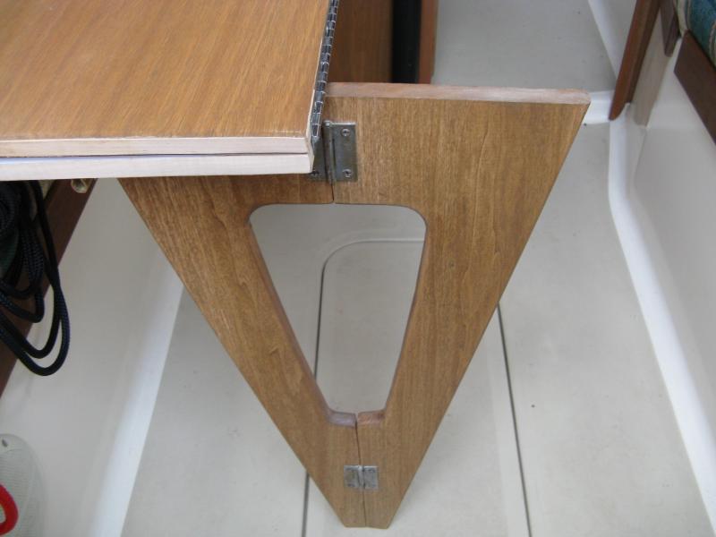

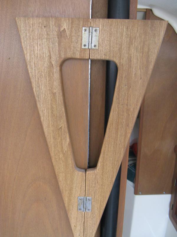

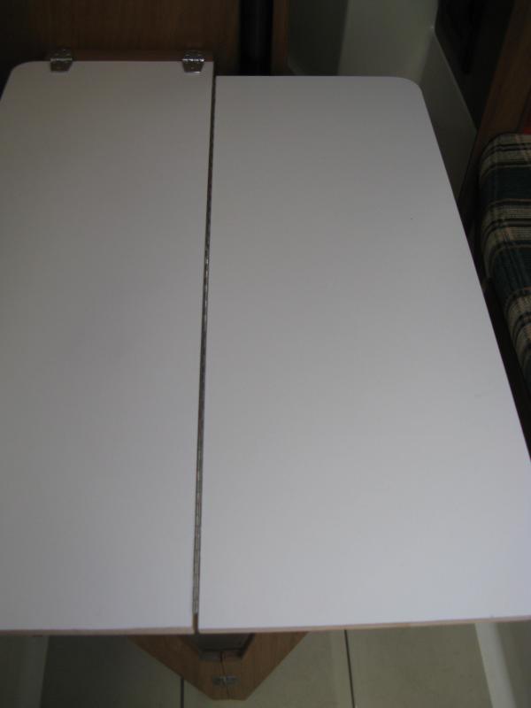

I have had some requests for information on the fold up table in YOT. This is an exact reproduction of the original table as supplied by Oday. If anyone needs the dimensions please contact me and I will measure all the pieces and post accordingly.
