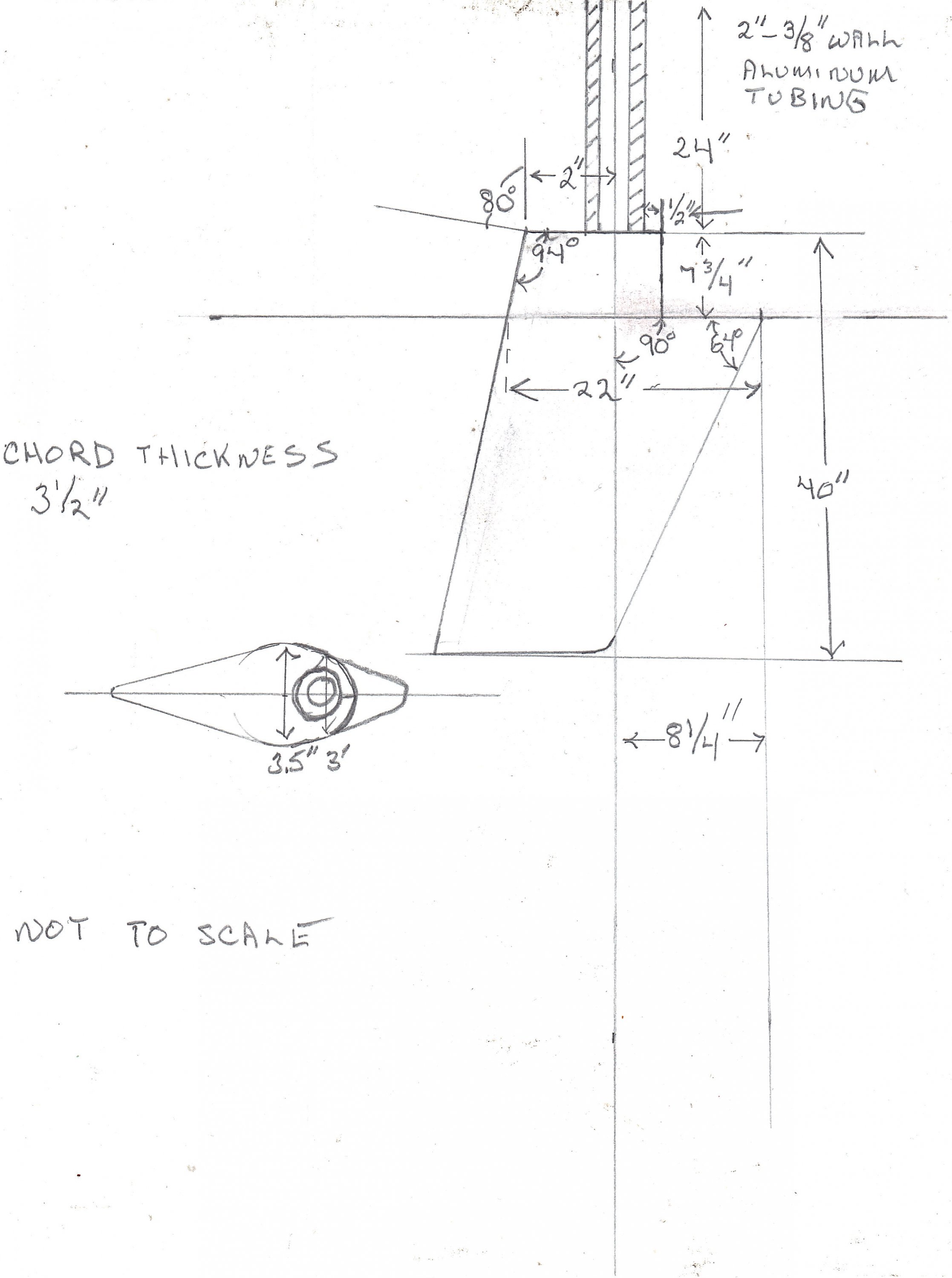

Update time for my fellow Oday owners. I have now worked through the rudder identification. I gave up! Yup, I said this is ridiculous and went to Rudder Craft. Working with Richard Warren I drew out the rudder and it's dimensions and angles and with several phone calls and emails we now have the blueprints for the Oday 27 stub skeg rudder with 2" rudder post. A bit pricey $1638.00 including shipping but well worth the price to have the super duper high performance galactic go fast and highly balanced polyethylene neutral buoyancy for crisper tacks and less drag rudder. So if ya need a rudder for your 27 they got the print. Your welcome. Forgot my humble pill prescription apparently. Best part is it has a lifetime warranty for the original owner and I don't have to worry about the current rudder exploding and the embarrassment of getting towed into the harbor.

The price of the rudder just highlights the value of these maintained older boats. For me, I would never be interested in a new model regardless of the technological advancements. It just does not meet my $$/enjoyment ratio. I have often thought of purchasing older boats and parting them out to keep the fleet going. The sticking point has always been disposing of the hull. I need a massive cutting/chewing machine. Joe , what would be your lead time for development and construction of such a device?

Hi Todd, good to hear from you again. I could probably concoct some machine that could chew up leftovers for a much more reasonable price than the monstrosity jibes has in mind. Although, more power isn't always a bad thing. Man, what that does to cars is impressive. So what pushed me over the edge was the long crack along almost the entire seam of my rudder. I knew three years ago this day was coming and I am surprised I could squeeze just a bit more out of it. I agree with Todd on the older boats. The newer designs seem to be following the trends in racing. They are fine and dandy if you have a full crew but they beat the hell out of their crews. You are always wet as these plumb bows split the wave and in many cases careen over the decks. I can't get my 27 to heave to worth a darn so I can't imagine the modern boats having much chance. That puts a sea anchor on my list of good things to have. Number one killer offshore is exhaustion more than any other factor. Look at what happened to Vestas Wind during the past Volvo Ocean Race. Oh and there is this guy Michael Riley from Maine who has been going back and forth across the Atlantic several times in a stock Oday 27. Lost his rudder on the first trip and rigged a spare out of a bunkboard and a whisker pole. He does it in an antique and the pros in the hot snot boat pile up on an island in the middle of an ocean.
