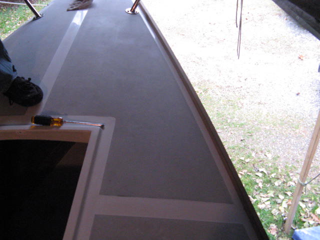

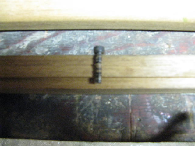

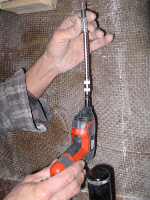

Well that went nowhere fast. While the equipment was fantastic, yours truly bought screws a bit too short. Having purchased a box of 100 for about $6.00 they are only slightly long enough to grab. Any extra thickness in the deck thickness and they don't grab. Oh well a new box at 1 inch long will be here Tuesday. 5/8 inch isn't quite enough. I am happy to report the flexible screwdriver extension Mcmaster part #85255A11 for $8.17 does a yoeman's job of driving the screws even at the most extreme hull curvature. The flange head screws sit in the end a bit loose so some masking tape layed over the end before inserting the screw into the bit gives a snug fit to keep those little buggers from falling out when you're reaching into a blind area. This is one of those moments when an inspection mirror saves some outrageous contortions to see the holes. All in all not bad. Gee I cut that board three times and it's still too short. Measure twice cut once as the saying goes.
