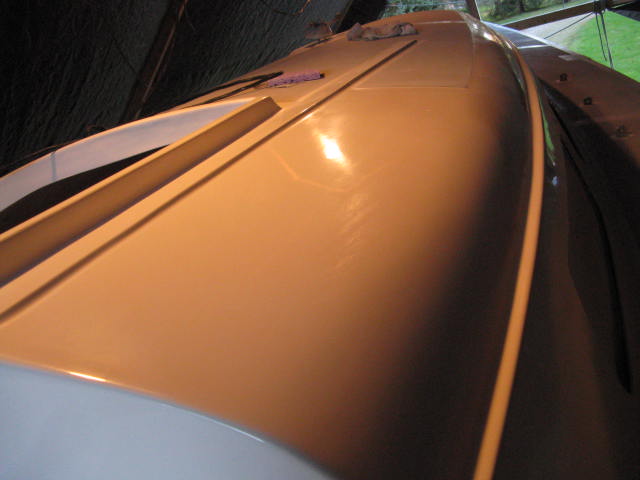

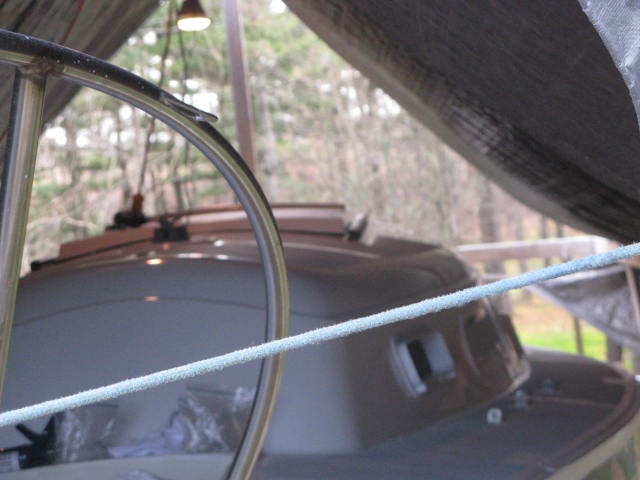

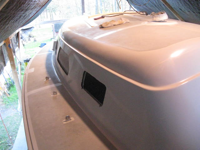

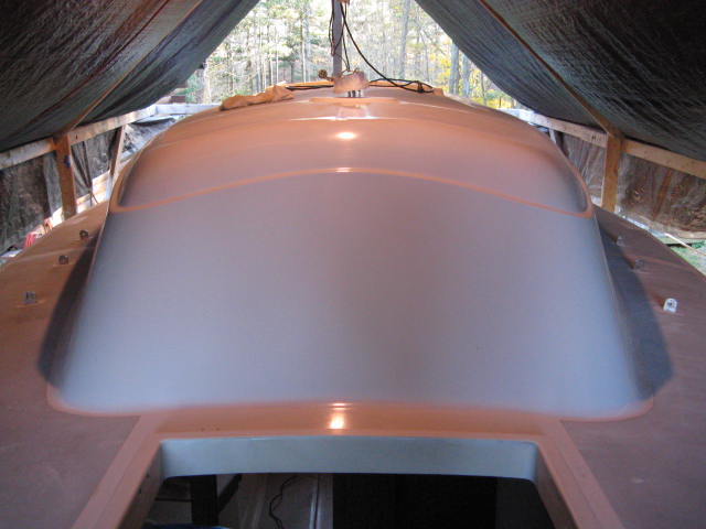

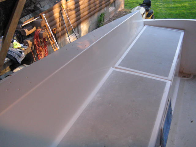

FINALLY! The cabin, deck and toerail areas are ready for buffing. Some minor sanding on the cockpit coamings and settee sides remains but heating the gelcoat and keeping the areas of touch up warm (80 degrees) has worked. By next weekend the windows and their respective spacers will be installed. This will allow me to continue the interior work in relative comfort with my little 1500 Watt Stanley heater. I'll get some photos up a little later today so we can all marvel at the shear beauty of a freshly gelcoated YOT. Am I laying it on a little thick? I still think these things grow during recycling and shrink the second they get put in the water.
Aug 20, 2010
1,399
Oday 27 Oak Orchard
Almost made it! A little less than half way to go and close her up.:dance: I'm using some 3m Rubbing compound #39002 and a wool compounding pad I picked up at the local NAPA store then following with Aqua Buff 2000 that I'm hand rubbing. Now that's dedication, or insanity, but the results are worth it. One nice thing about the hand rubbing with the Aqua Buff is the reappearing orange peel doesn't occur.:clap: Seems my friends at Express Composites were right on the mark about a less than complete cure and the heat generated by the buffer. Least aways now I'm gonna get that glass smooth hull I'm after even if it's a bit excessive. So without further ado, here's the pics.

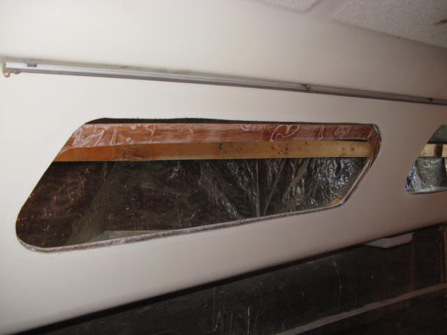

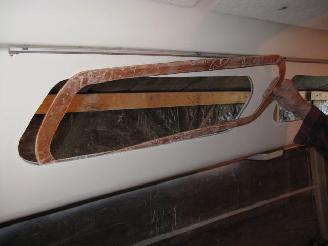

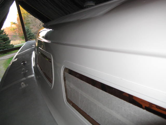

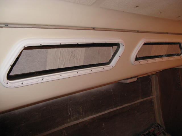

Now we're getting there. Insert spacers, caulk and install with a generous amount of Dow 795 Silicone Sealant. A cordless screwdriver is a must as there are about a million of the little screws that clamp the windows to the cabin. So here are the pictures and to say I'm excited is the understatement of the century.

Did you insert the spacers and then seal or did you embed the spacers in sealant?

First up Mr. Rajhnsn. What I was looking at were two problems. One being the cabin liner compressing and allowing the clamp of the window and inner ring to release. In these areas I just installed the spacers and generously caulked the windows and installed. Once the inner ring was installed I knew there was sufficient caulk as it squeezed out around the outside edges. A rag with some denatured alchohol cleaned up the excess without damaging the gelcoat. The second problem I encountered was the starboard aft cutout had a very pronounced bulge in the cabin liner. It was enough to have distorted the old inner ring. For this I coated the liner and cabin gap with epoxy slightly thickened and clamped to reform the liner. Suprisingly everything assumed an accurate shape. Then it was install as the other three. Now for the stress cracks for Jonny Quest. I ground each one with a dremel fitted with a small burr. After which I filled with some Duraglass. The areas I noticed the most cracks were areas of insufficient backing especially hatch hinges. The Duratec additive is suppose to help with this. I am also adding backing in these areas for some cheap insurance. A few premade cloth/epoxy backing patches will hopefully do the job. One other thing I was doing was to regelcoat only the amount that had been compounded out over the years. The Duratec blended at 50/50 with the gelcoat lends itself to complete cure at thinner thicknesses. So thanks for your questions and hope if you have more you don't hesitate to post them. By the way the Aquabuff is really good stuff but the high speed and just the right amount of water make it a pain. I have resorted to hand rubbing to get the shine without the reappearing orange peel.

Hi Todd. The Aquabuff only seems to affect new gelcoat. As I discussed previously I spoke with the folks at Express Composites about this and the conclusion was the new stuff hadn't reached it's full cure. We had a few days of warmer weather and it appears to be continuing to reach a harder state. The cabin top had a longer cure time and didn't orange peel with the buffer and 3M product. I went behind by hand with the Aquabuff 2000 and a terrycloth rag to get an extremely smooth finish. I am also finishing up the cockpit and toerail/rubrail areas this week and the finish by hand is amazing. Even I can live with these results. I am sending you a PM on the nonskid application. It isn't as bad as it seems once you get it figured out. The nice thing about hand rubbing is you can feel it dry and drag indicating a spritz of water is in order. With the machine you are guessing about too dry which may have contributed to the orange peel. I did get around it by opting on the side of too much water. That kept everything cool enough to solve the problem. And a tiny bit, about the size of a penny, is enough for an 18" X 18" square when kept moist.

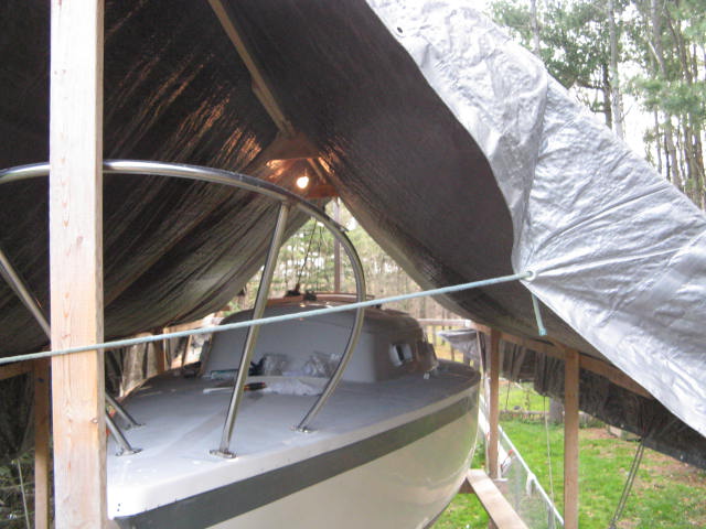

Well there's something you don't see everyday. Master Yogurt has been busy now hasn't he? Most of the sanding, touching up, resanding and buffing is now a thing of the past. Outside anyway. The engine instrument box is back in. The companionway hatch is on with some nice new teak rails, and huzzah and hoorah it doesn't make that awful screeching noise when it is sliding forward. I guess my hatch repair worked. All the windows/ports are just beautiful and the tabernacle is back in place. The piece of resistance, oh joy the bow pulpit fit. Remember from a previous post the port forward stantion was bent six ways to silly. The time it took to construct a welding jig from some scrap wood had that sucker lay right in to the degree of the deck curvature and every screw virtually dropped right through the pre existing holes. I caulked the windows, engine instrument box and bow pulpit with Dow 795 silicone. The tabernacle and teak rails with 3M 5200 regular, not the fast. A strip of new 1/2 X 3/4 self stick weatherstripping was installed at the top forward part of the companionway to replace the old worn out stuff. I will be using this same stuff, available from most any home center on the cockpit settee hatches. Not to seal them as much as cushion that nasty plastic on plastic cacophony when we drop rather than lower those things. Of course we never drop them now do we? So tomorrow the toe rails will be cut to length and screwed in place untill my next order of silicone arrives. I will give you a peek at the flex driver at that time as I'm curious as to it's performance as well. Here's a sneak peek at the so far.
