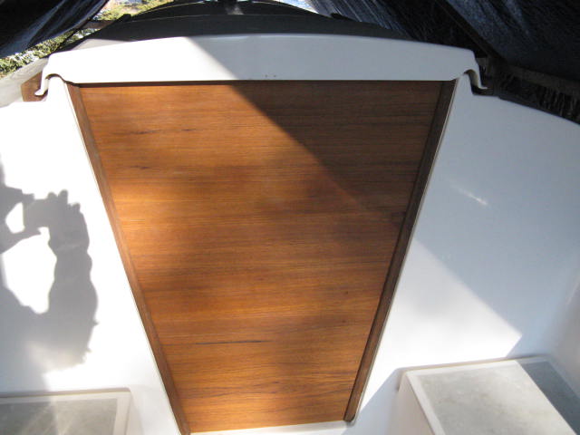

Thank you Sailing Cal. Today I'll be cutting still another toerail as the teak had a very pronounced section that was extremely dark internally and it won't lighten even using some potent oxalic acid lightener. It just throws of the 'look' I'm after and I still have quite a bit of board left over. On another note, there is quite a discussion about ethanol going on in Ask all Sailors. Personally I couldn't care less if it's rough on an engine or the fuel economy. What I do care about is the ability of ethanol to absorb water. Oday has been gone for quite a while and our fuel tanks are quite old. Mine is 35 years old and counting. What concerns me, is the tank is galvanized steel. Water and steel make for a very bad situation. Don't believe for a moment galvanizing protects steel. I have had more than my share of grief professionally with plant compressed air systems piped with galvanized steel contaminating machine components when the air dryers are inadequate. Another more familiar example are chainlink fence posts that are galvanized. So to that end on the to do list is replace the fuel tank. Remember, galvanizing is a zinc coating process and we all know what happens to zink in water. A sure sign of imminent tank failure is rust in the filter and I've got it. A 12 gallon bomb after all this work isn't something I'm willing to leave to chance.

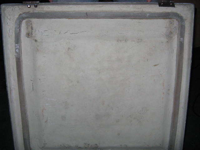

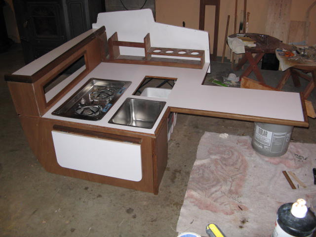

Oh so close!!! Galley ready for installation with the last vestiges of outrageous orange eradicated. Couple that with the varnished plywood countertop relegated to a lovely bonfire and there it be. An Igloo Marine cooler in a petite 25 quart capacity is just perfect size to fit the original icebox opening with only removal of the top and a few L brackets to secure it to the countertop. Seal with foam weatherstripping and an icebox fit for an Oday only better. Now how about above 65 degrees for three days to bond the foam/fabric hull liner please.

Galley looks great !!!
