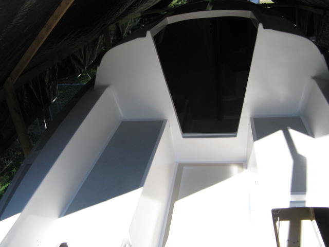

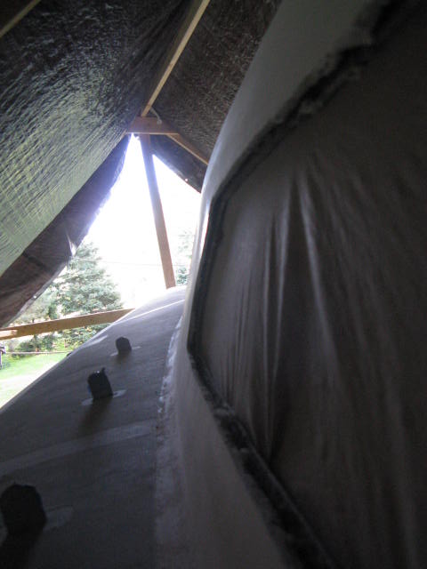

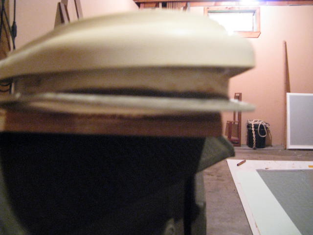

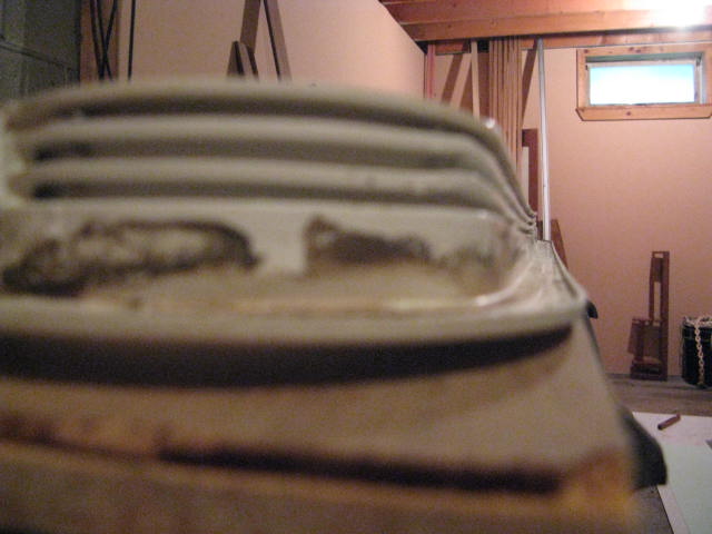

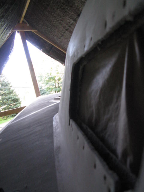

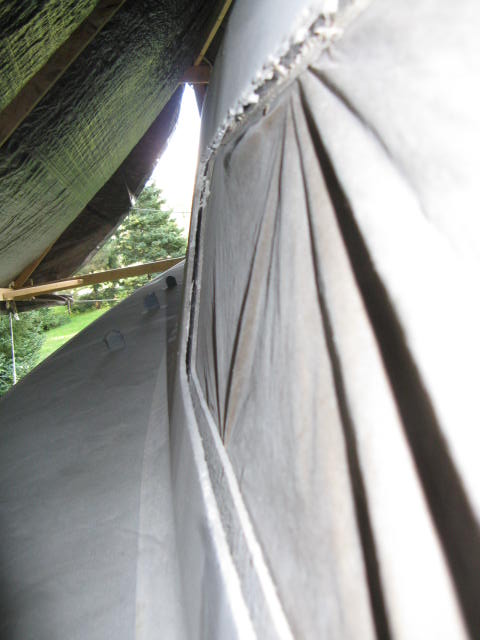

First, thank you jibes, that's very tempting however the admiral has MS and the heat would kill her. For her benefit I'm going to have to remain in the icebox. Anyway, here are the pictures of the cabin structure and the portlights. The cabin varies from a 1/4 inch gap at the main cabin to a 1/2 inch gap at the opening ports in the head. As you can see the main cabin portlights are fixed at a 1/2 inch thickness. Without some type of reinforcement between the cabin liner and cabin exterior the seal relies on the fiberglass maintaining it's position to hold pressure on the seal. That's exactly what Sailing Cal and I are seeing is the cabin reforming to relieve the pressure. Once the pressure is gone the caulking is subject to heat and stress until it fails in it's purpose. To eliminate this I will be installing spacers to maintain the fixed distance necessary to maintain a solid seal. Even the new opening ports rely on minimal motion to assure the seal remains intact despite the trim ring floating over the port proper. I will post a tentative list of what remains this weekend and I can assure everyone it is very short even if some of the work will be involved, 'cause there are one heluva lot of screws to go back in. But at least most everything is here and or fabricated.

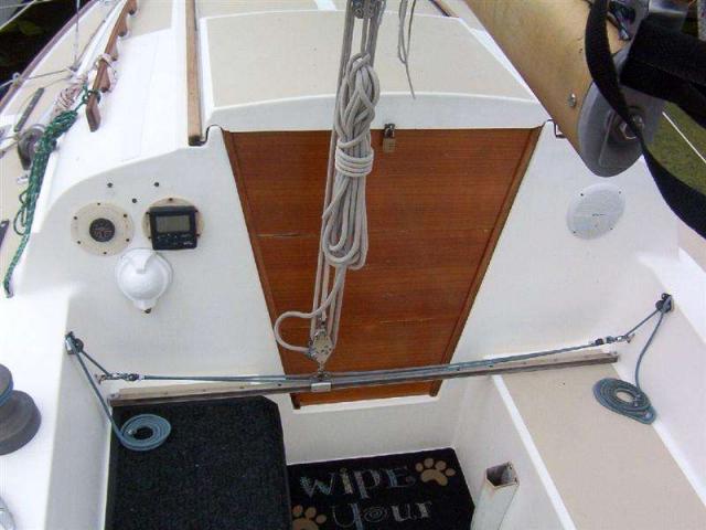

Another note: I noticed in your photo (attached) that Yot has the same hand holds above the seat backs in the salon as my boat. I plan to remove these and give the salon a different look. Is anyone in need of them?

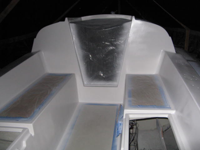

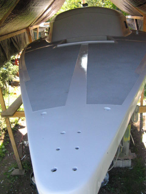

DENIED! While spraying up the cabin sides and cockpit I called to my son for another 20 ounces of gelcoat upon which he replied, "we're out." This YOT drinks gelcoat like a sailor drinks on shore leave. Another order has yet 1 more gallon of white gelcoat on it's way. Now if I can get a few more days of warm weather all will be complete with regards to gelcoat. At that point it will be install the toerails I fabricated earlier and a thorough wipe down of the cabin interior. As of now the cabin is gutted as the hull liner foam and fabric will go in and then the woodwork reinstalled. After that it's stuff the cushions as they take up less space in the house. After that it's sand and buff then on goes the new rubrail. In go the windows and on goes the hardware and hatches. Paint the bottom and call the transporter. It's the proverbial light at the end of the tunnel and it ain't the locomotive. Todd I will be happy to post pictures of the finished product from exactly the same angles as the brochure. Jibes, e-gad after all this the crazy orange is history. All the formica is white like the gjenvic brochure. Here are some photo's of the 'core' that will be installed between the cabin exterior and liner to hold the cabin at a fixed distance. I cut them from 1/4" underlayment. Before anybody goes nuts that it isn't a 'boating wood remember neither is balsa or kapok but they have been used successfully for many years. Many a kitchen floor has used this plywood and survived repeated moping. Besides I coated them with epoxy. Also there are a couple of shots of gelcoat and Duratec. No sanding or buffing as of yet.

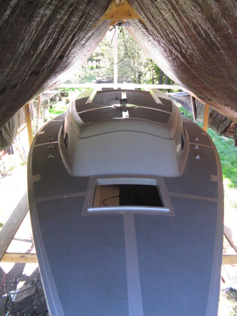

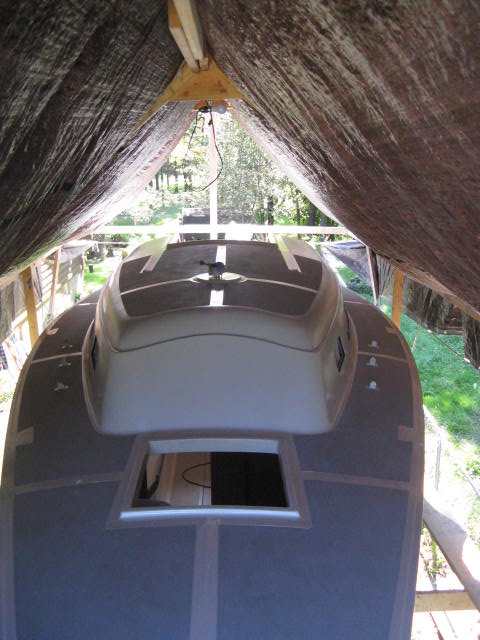

Well the gods of cross linked polyester have smiled on yours truly. To that end the final shoot of the cabin using the 50/50 Gelcoat/High Gloss Additive has been accomplished. A few touch ups and let the wet sanding begin. The cockpit floor will be the finale for this project as I have something unique cooked up. So to tide everyone over here's what this YOT is looking like all dressed up with no place to go, yet. And what I bought just over a year ago. Enjoy.

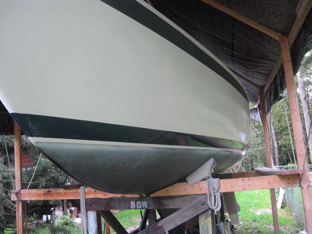

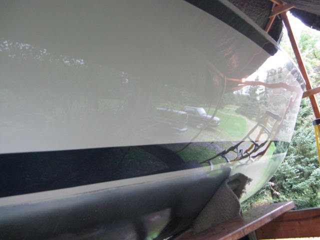

Hi Sailing Cal. I'm getting very excited about getting this thing ready for spring. I will probably stay on a short string for a few years here on Lake Ontario but in the future I would love to start some serious distance cruising. Here is the starboard side with shiny bright gelcoat and the port side with some orange peel. Now that's an understatement. This weekends mad dash is sand and buff the cabin so I can get YOT closed for the winter and install the hull liner foam and fabric before the cold sets in for good. Keep your fingers crossed for a few more weeks of warmer temps.

Hi Todd. I have about 20 hours of sanding and buffing thus far. I still have to do the polish and glaze to really bring out the shine. That should be another 3-4 hours. The sanding was a killer. I spent 2-3 hours each evening this week sanding the starboard side. I started with 220 wet or dry, sorry Maine Sail I had to cheat on this one, then 320, 400, 600, 800 and finally 1000. I used the 220 primarily because I'm a bit of a slop artist when it comes to aerosol applied anything and I had some serious orange peel. I often went out after dark to sand as the Duratec highlighted the low areas by reflecting my work light and appearing like a glitter. Once there were tiny but even glitter spots it was time to drop to the 320. By the time I was done with the 400 all the glitter was gone indicating I had only the sanding scratches to sand out with the 600-1000 grits. A quick check with the Maglight flashlight held parallel to the surface revealed any touch up spots that only required the 400-1000 paper. The most work was the 220-320 as they did the bulk of the knockdown. I'm using the Aqua Buff 1000 fast cut and Aqua Buff 2000 polishing compound as a little goes a long way. One gallon each is about twice as much as I will probably need. Express Composites up in Minnesota had the small quantity and lowest price at 35.00/gallon. It's made from ground up bones from what the manufacturer told me. The other big thing is you use a high speed buffer which is counter to about anything I ever heard. 2500 RPM or greater. As the folks at Hawkeye the makers of these Duratec/Aquabuff products explained it doesn't burn at these speeds due to it's water base and no petroleum products. The funny thing now is the strange looking person looking back at me in the boat. How he got in the Gelcoat I have nary a clue.

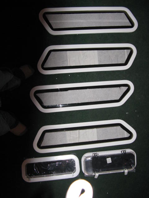

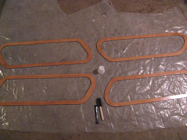

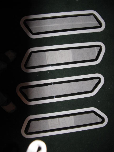

Nah nah nah boo boo. I got new windows (tinted of course) that are exact matches for the ones going bye bye. So while others are hacking and chopping be it known heretofore and hence forth that The Rudy of D&R Marine has access to the maker of the (ta da) originals. Don't know who makes 'em but I'm just as giggly now that YOT will be styling. WARNING, they ain't cheap but these are the real deal.
May 18, 2010
543
Oday 27 Gulfport, MS
Yes they are pricey, but if they simply plug into existing hole w/o modification then good purchase.
They are certainly going to look snazzy!

Hi Jonny Quest. Long time no hear. Yup these are exact drop in windows on the main cabin. The opening ports needed two minor cutouts for the rain drains that were simple with a router. I used the exterior trim ring and a pencil and zip, zip in they went. They don't have the original rain shade but with the drains and the fold down latches they are a superior window. My head will be thankful since I won't be putting any more knots in it from the metal screw latches. Hi there zoomie. Glad you are enjoying my adventure. I'm always glad to lend what I am learning to the Oday database. Don't be too hard on the 22. That was my first Oday and provided me years of enjoyment. The 222 addressed many of the shortcomings of the 22 especially the lateral drift when going to windward. In fact, the colors of the shear and boot stripes on YOT were the colors of my 22. I will be continuing with the pictures as this project is still an ongoing affair. At the end I'll be taking Panta Rei's suggestion and posting before and after photos. I do want to thank all who have contributed to this thread as fellow Oday owners have always inspired me to keep going when I questioned, "What in blazes was I thinking." A community of Oday enthusiasts is a great motivator and a never ending source of inspiration and support. Until later, more damn sanding although the end is in sight.
