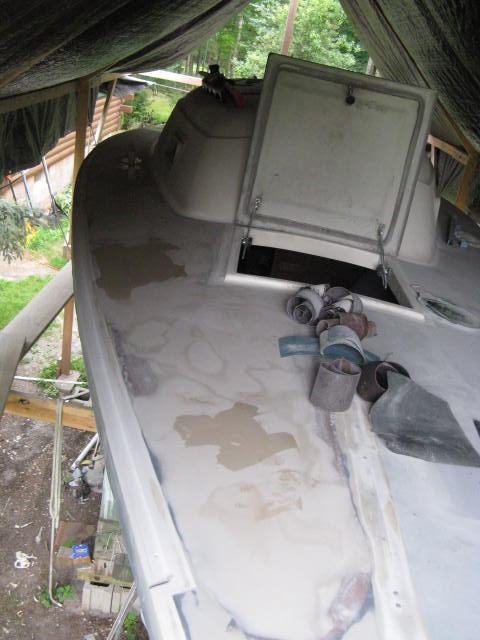

So what's 25 been up to lately? Well fairing the starboard deck is priority one at this point. No matter how much West Systems 410 Microlight filler one seems to buy it usually isn't enough for a project of this magnitude. The fourth 5 ounce can should arrive Tuesday which will definately finish the job. With temps in the 90s, early morning is the best time for application as this stuff exotherms more quickly than other fillers even with 206 slow hardener. Small batches keep things from heating too quickly. So to forge ahead I turned my attention to the galley which is coming together rather nicely. A previous owner had pretty much hacked and chopped it to a piece of junk. Thanks to DannyS for posting a picture that provided some direction of the layout. I also incorporated some details from the 77 model to come up with what I hope is a reasonably functional galley layout. The three cutouts are for the stove, sink (forward), and the icebox aft of the sink. Once again I am using Joubert Okoume 12mm plywood for the facing and 1/2 inch marine fir for the top. As you can see the formica is white and not awful orange. So progress is still happening despite nature's best attempts to bring whole thing to a halt.

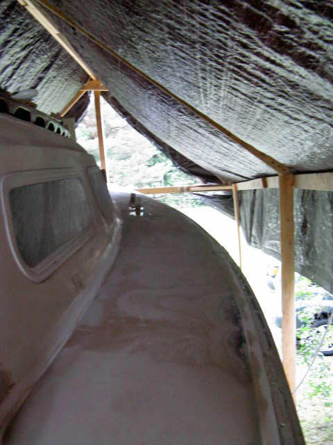

Well I haven't blabbed about much lately. 'Cause I've been playing gelcoat madness. Sanding and sanding and even more sanding. I'm gonna have to buy stock in 3M at the rate I'm burning up sandpaper. Be that as it may I'm just about done with the starboard deck fairing and will probably complete it tomorrow. Then it's all cosmetics. By golly I'm getting there. A new 100% jib and within 2 weeks a new main by none other than Neil Pryde are ordered or will be ordered. In regards to griptex, it sounds like a fantastic solution to create a nonskid deck but like Ruidh and Panta Rei point out I'm being fanatical in recreating everything to it's exact original configuration. It's not for everybody so griptex might be a suitable substitution. When doing the interior gelcoat spraying a VOC respirator is an absolute must. I am using the precolored 'cream' from Jamestown Distributors and when thinned 30% with styrene it sprays beautifully with only a little orange peel. I used 400 then 800 and finally 1000 wet or dry sandpaper and buff with a standard automotive polishing compound made by 3M for a high gloss shine. The cream is virtually an exact match for the Oday interior. So heres the completed rear cabin bulkhead all shiny bright and without the holes.

Jibes, where ya been buddy? Don't say sailing or I'll pout. The deck fairing is complete as of right now. All that's left is barrier coat and the nonskid and YOT has a complete new deck. I can't describe how happy I am to see everything coming together and know the end is in sight.
